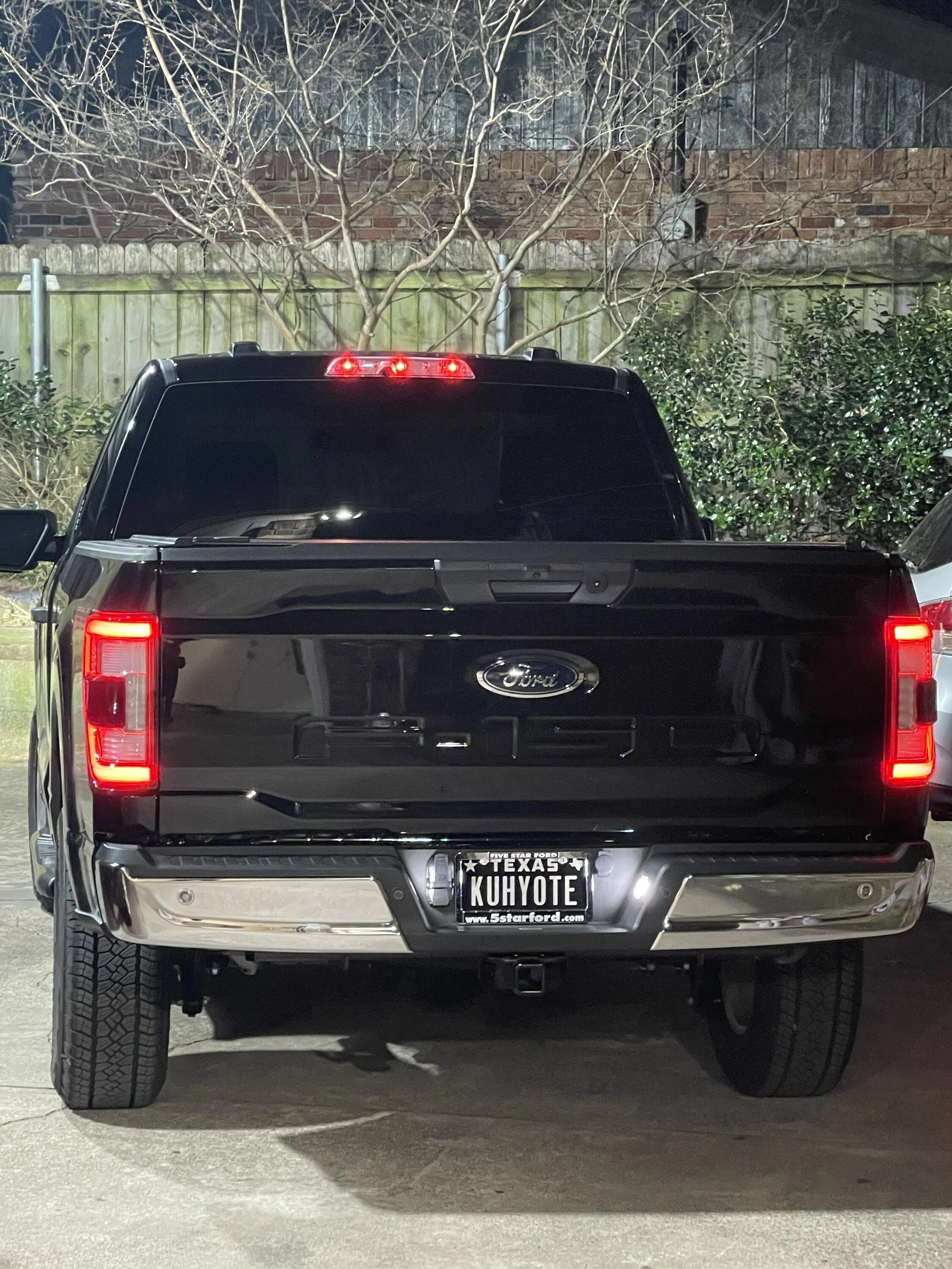

Just wanted to post up the raptor 3 rd brake light conversion I did. Ran my own wiring from 3rd brake light all the way to BCM 2280G connector pin 3. Purchased the OEM raptor 3rd brake light on eBay new and purchased the male terminal pin for 12 pin connector at 3rd brake light to go in cavity 7.

that’s the running lights on and when you tap on the brake lights the will brighten up more

Nice work, easy too much work for me for such a simple thing, but it does look good!

That off center bed cam would bother my ocd :)
