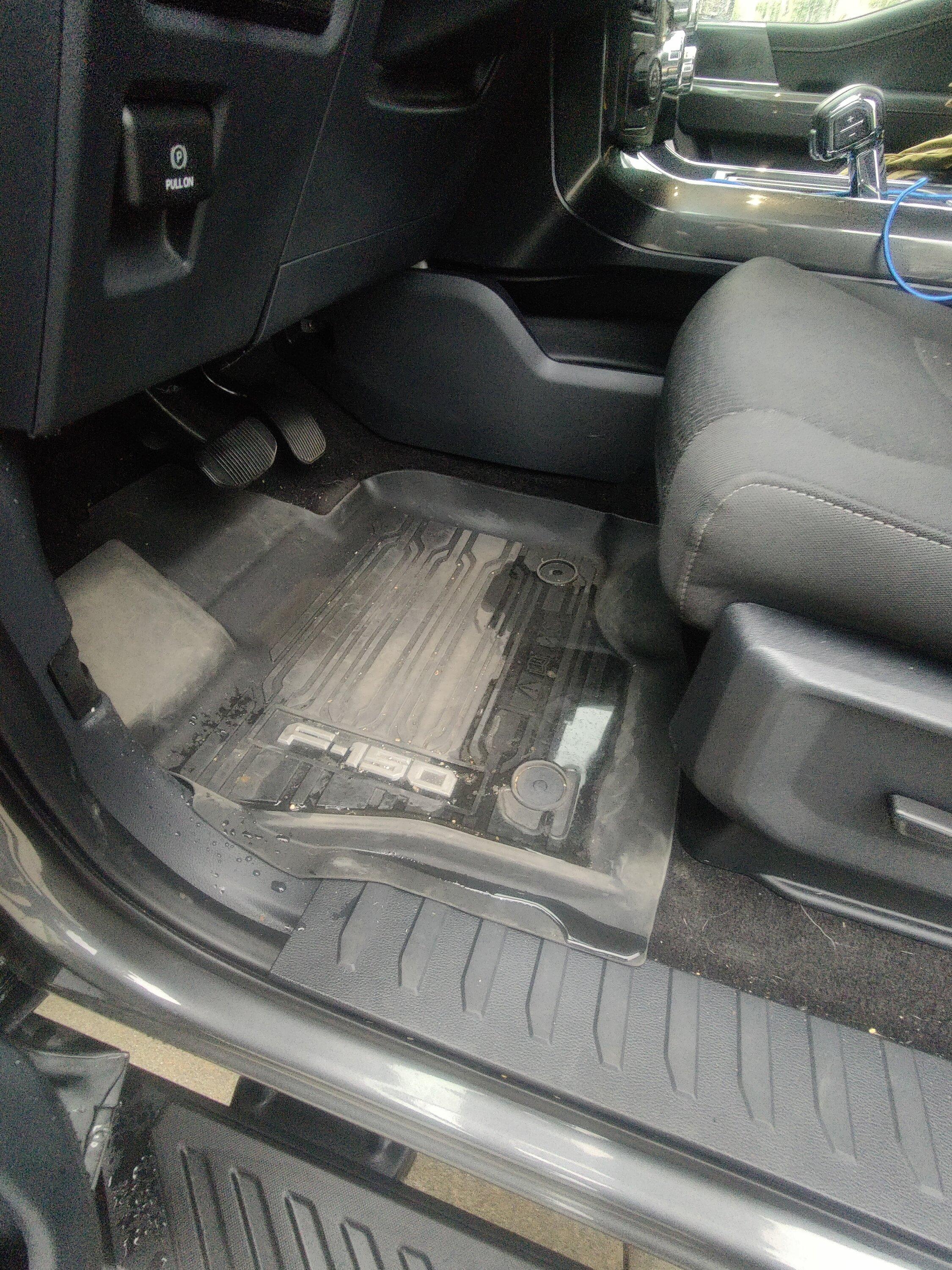

Anyone have a problem with their feet getting wet? 2022 with 12k on it. Was parked overnight and filled the floor mat and soaked the carpet on driver side. Door seal are all dry, what's not dry is everything behind my dash/column. Quick research showed there was some 2021's with windshield issues, but not much else. Luckily chino hills ford had me in a loaner in less than an hour this morning while they track this down. I'll try to post an update.

Currently having a similar issue on 2021, water leaks on driver side floor board by break pedal. Originally the dealer replicated the leak. After dealer spent 1 day disassembling part of the truck they cannot replicate. Dealer is calling in a tech specialist, yet here I am without my truck or a loaner.

I believe there is a recall on the windshield due to poor sealing...

Windshield has my vote. That sucks, but should be easy to fix.

Windshield is what I told them I thought it was since I noticed 2 small lines of water coming down interior. I thought it was surface tension carrier to the lower windshield area and dropping from there. The dealer thought that was condensation and it was calk in the firewall area. I asked them to test the windshield......I don't think the did.

They re-installed my windshield twice, and that did not stop the leak, Final verdict was lack of body sealant somewhere up in the A pillar to roof seam. Dealership took care of it and I had a nice loaner the whole time. Has been dry since.
