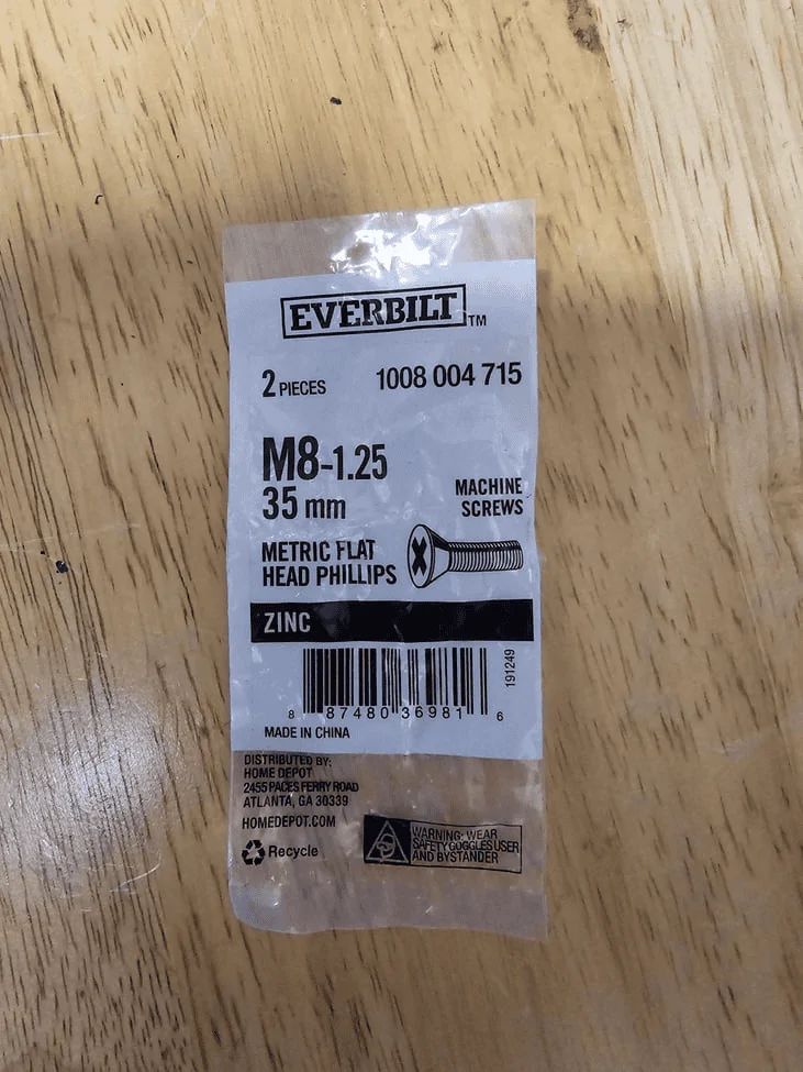

When I first started thinking about adding a brake light bar I noticed a tailgate guide in the space that these lights would go. This is for any tailgate light bar and not just the Putco ones.
Some suggestions were offered to build up the bracket that holds the bar and also to replace the bolts with flat head bolts to lower the height that is needed for clearance. A parts sleuth found that these are M8 21mm bolts. The Ford diagram that he posted showed this but not the thread pitch.
(1) Part Sleuths Objective – Can You Tell Me? | F150gen14 -- 2021+ Ford F-150, Tremor, Raptor Forum (14th Gen) | News, Owners, Community, Discussions
I got some M8 20mm with a 1.25 thread and these were the correct ones. I replaced the large Ford bolts with these flatter head bolts. You can see the difference in the photo. This does not eliminate the need for some height for the light bar, but this helps tremendously.

I am curious though, since I am not an engineer - would a flat bolt have the same "hold power" as a flange bolt, even if it's the same size? Why would Ford choose to use a flange bolt in this case and not flat head? Not saying it's not the same, just curious.
Actually, maybe easier installation in the assembly line?!

When I first took one of the Ford bolts out, I said "this thing is enormous compared to the M8 bolts I bought." I was afraid that there was not a lot of area holding the bracket down and that it may not be enough. However, the hole in the bracket was not much larger than the diameter of the bolt so there was still some decent surface area for holding the bracket in place.
With that said the bracket is just a guide for the tailgate and others have said that if you do not plan on taking the tailgate on and off, then it really is not needed. When you look at this bracket it really does not do anything and the large bolts are overkill. Now I am a big believer of overkill but this interfered with other plans.
I suspect that this flange bolt may be used for other parts so this is an easily accessible item and a case of if it works, use what you already got.

I am just posting this with a subject that might be easier for people to find if they do a search. This is in response to a number of threads that have some information scattered in them.

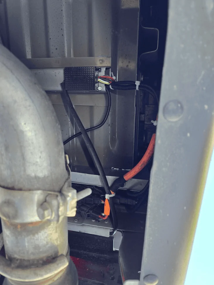

See Raptor CHMSL meets Morimoto tails meets Putco light bar on another forum. I finally got around to installing the Putco 60" Tailgate Light Bar. Their installation instructions leave much to be desired, the QR code in the box was for 2018! Not allot of guidance one what to do about the tail gate bolts, I replaced them with a couple of M8-1.25 pan head machine screws. Plug and play harness meant I had a ton of extra wire to stuff in the bed cross member. Did take the opportunity to dielectric grease all connections.
