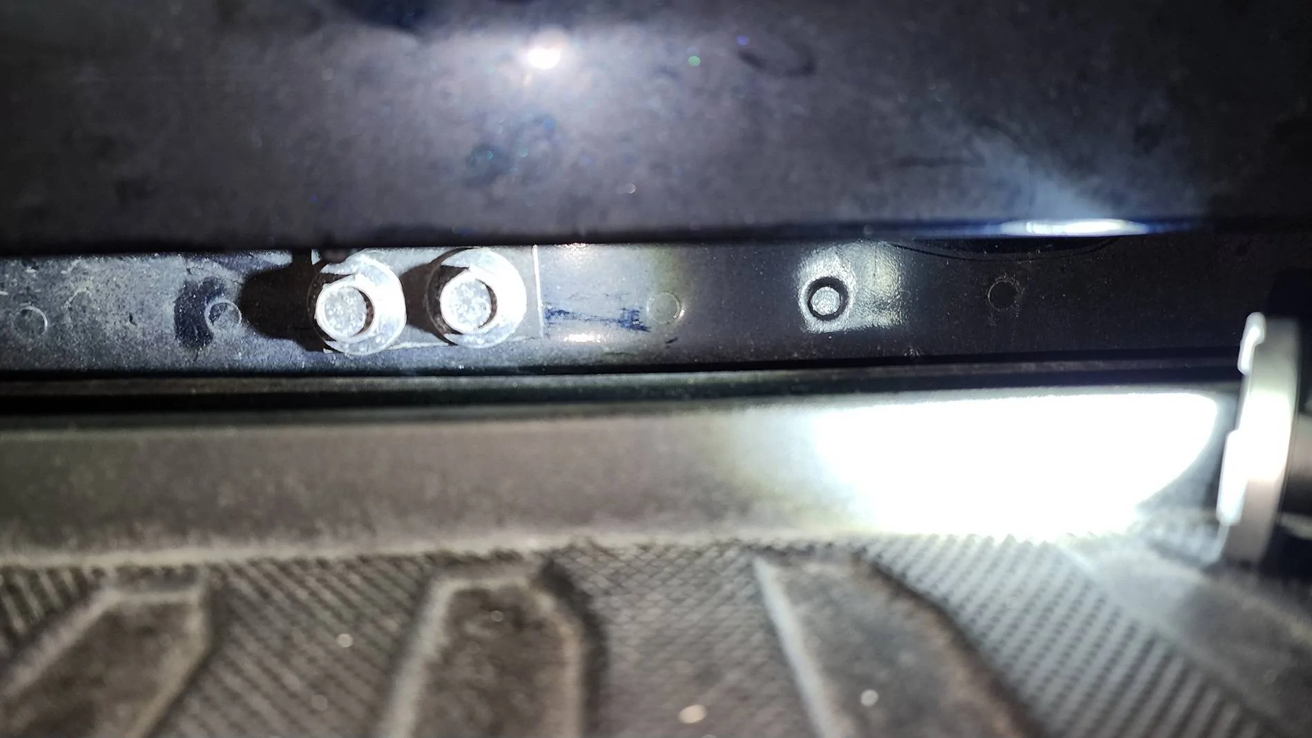

I called them again today to get an extra set of the thicker (1/4") plastic mounting brackets that I'll break the small tabs off and glue to the 1st set of brackets included in the box, to come up with a 1/2" thick mounting bracket. This is needed to clear the heads of the bolts of that the antitheft bracket that is screwed where the bar needs to be located. As far as removing the tailgate to mount the light bar, that would be a lot more extensive than various tailgate removal videos show. Videos are only for a normal tailgate, not a power tailgate. I'll try and mount it with the tailgate on as shown in another video, fitting it in the small opening - F150 60" Blade LED Tailgate Light Bar .
View from back showing bolts that the light bar has to mount over.

View from the left side showing the antitheft bracket that is connected to the bottom of the tailgate and the back of the truck
Ford F-150 Putco Freedom Blade 20250328_121555
View from the right side showing the antitheft bracket.
Ford F-150 Putco Freedom Blade 20250328_121633
As far as actually installing the light bar, I have yet to do that, so I have no idea if it will function correctly and not screw up the BLISS system or other electronics. I'll try and do an update once it is installed.
