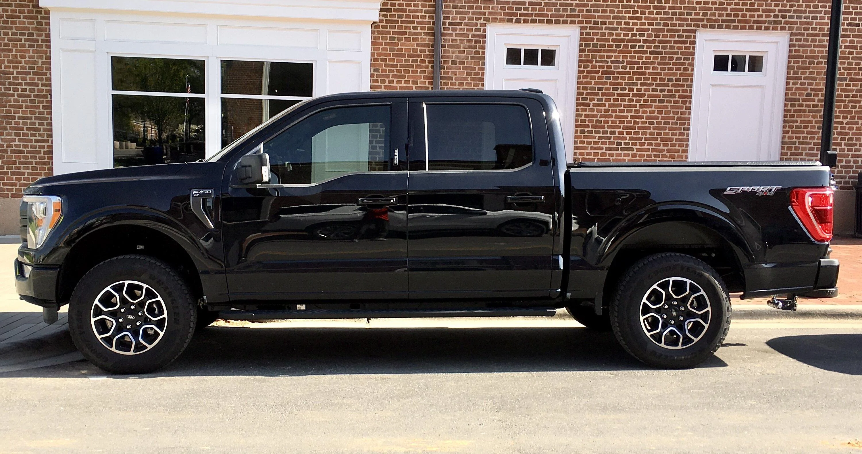

Hello all, my name is John and I'm new to the message board. I recently (March 2023) purchased a 2022 F150 XLT Sport-4WD Crew Cab. It was a demo model with roughly 4k miles on it. Since the purchase I got the leveling kit and a few other accessories.
I decided to purchase the 22" Ford Performance wheels and had a few questions for those who have made the same/similar (22" wheels) swap.
1-Do I need to purchase new lug nuts for these wheels?
2-What would be a good sized tire that would not cause any rubbing issues?
I'm not planning on doing any off roading and looking for a all purpose tire that doesn't stick out excessively. I've included a picture of my truck as it stands right now below. And also included a picture of a truck that has the look I'm looking for. I believe it has Toyo tires and may be lowered a little.
Thanks for any help and tips provided.
My Truck below:

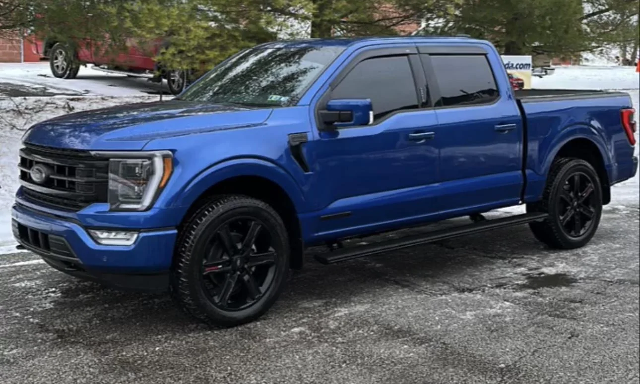

NOT my truck but the look I looking for:

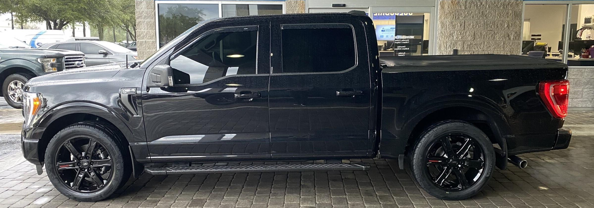

i wouldnt go smaller than a 305/45 bc of your leveling kit - these may even look small to you. You can likely fit a 285/55 but your tire options are limited and the price jumps substantially. 285/55 Toyo AT3 on my leveled 2013. It's on a steep incline in this picture, the tire fills the wheel well nicely in the front on flat ground.

Thank you. At this time I don't plan on lowering it but could be a possibility in the future if I don't ending up liking the look with the leveling kit on it. I'm going to go with some 305/45's. Now just got to figure out which tire I like best.

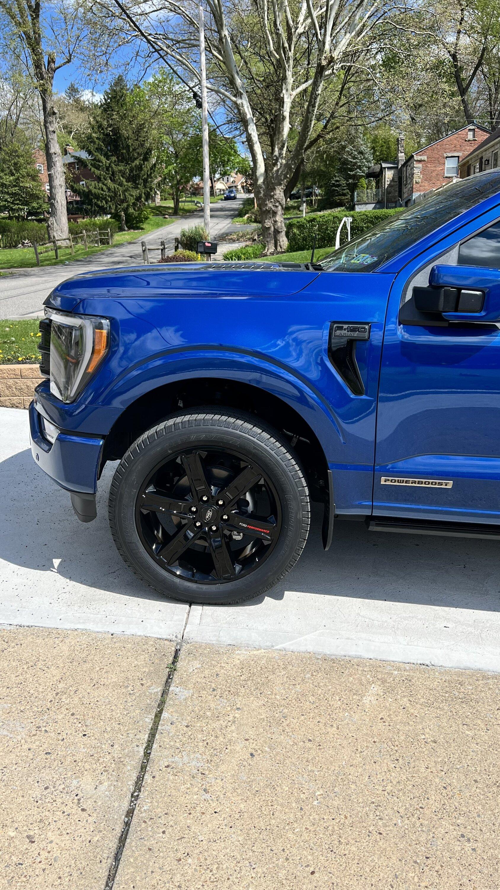

Got the same wheels and I went with Michelin 305/45R22. No rubbing or issues.
Heck yeah. That's exactly what I was needing. Thank you for sharing your photos. That help me a lot. Your truck looks very nice.
