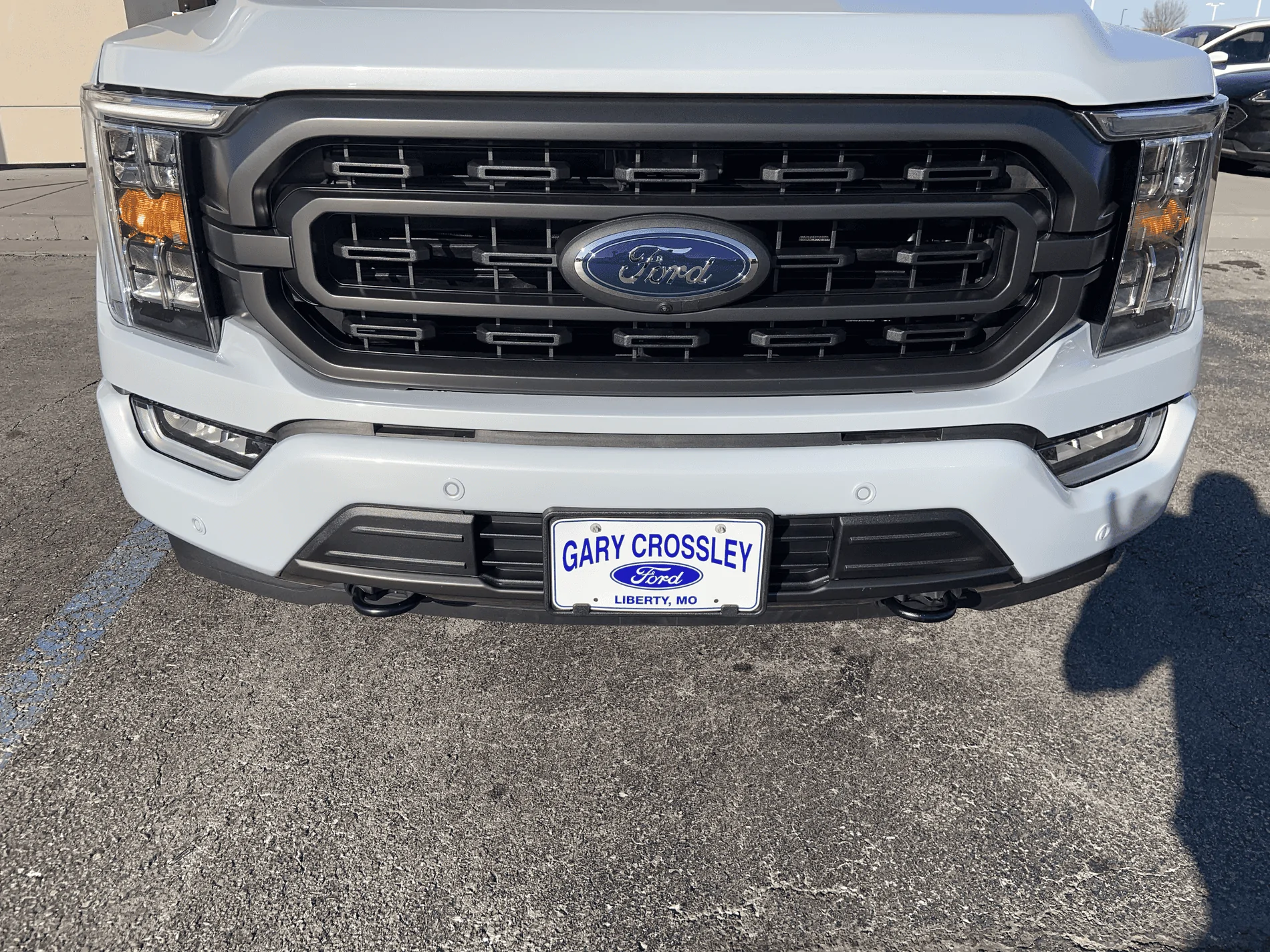

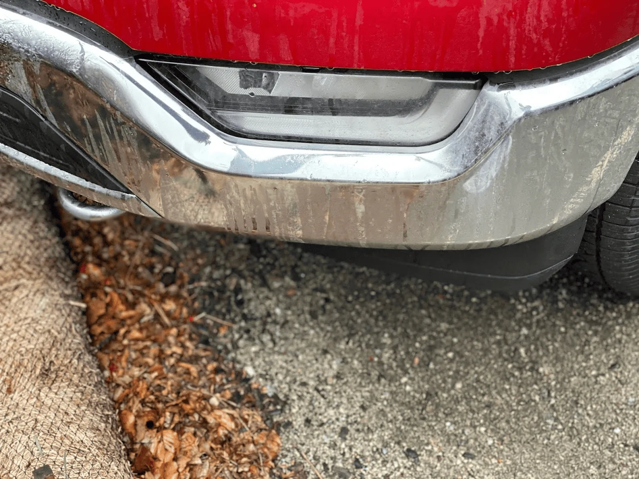

First image is 502a without 360 camera, no proximity sensors. Second one is 501a with 360 camera, and has proximity senors
Interesting... I’m not 100% sold that the grey one does have sensors. The picture is garbage. We just need to map the sensors to their function and the packages... could even be a production mistake at this stage of the game.

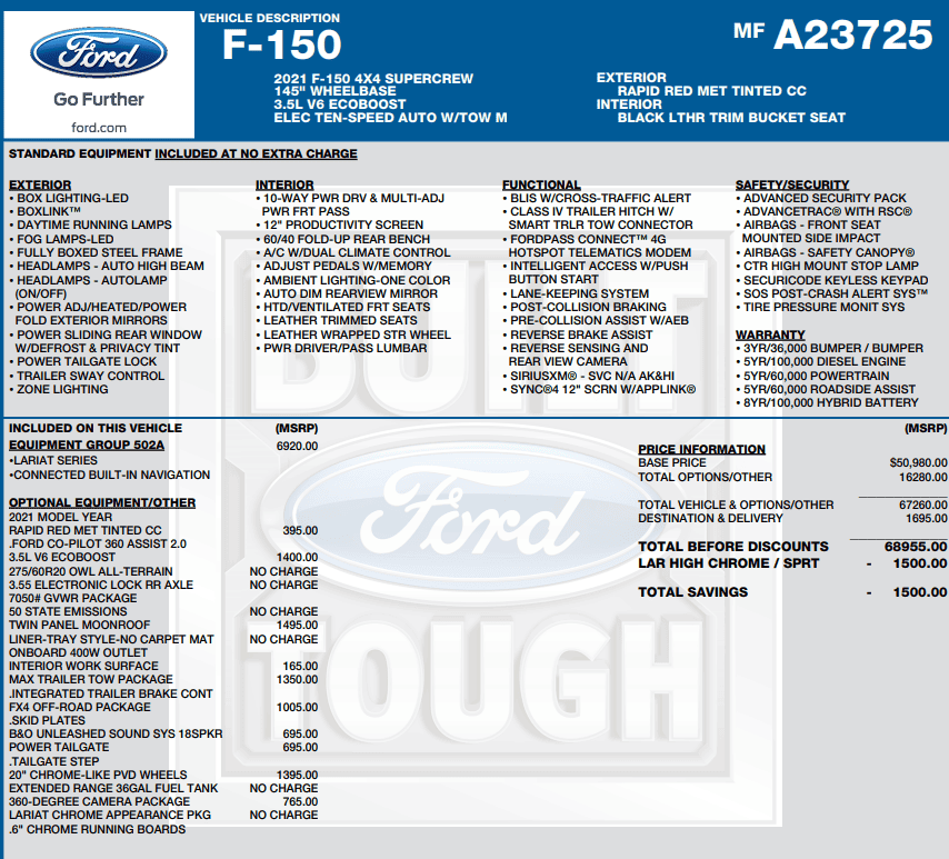

I'm more confused, this says 502A....YES!
Except its confirmed in real world that 502a doesn't have it unless you have active prep. Where is that screenshot from? I've seen some info on dealer websites that was incorrect.

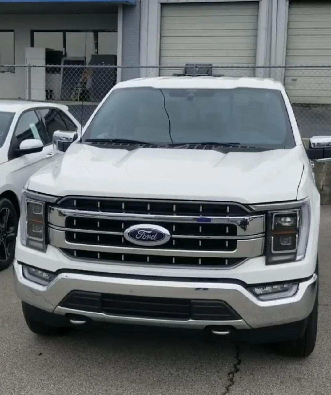

Fords word:
"The Ford Co-Pilot360™ Assist 2.0 Package includes a forward sensing system. This package is available on The Lariat 502A equipment group. This package also requires the 360-Degree Camera Package or the Tow Technology Package in order to be added to your configuration"
Yet, I found one without the sensors

Fords word:
Without Active Prep, no sensors on 502A. My dealer confirmed firmed with Ford. I don’t think there is anything I can do About it. It actually blows my mind that an XLT has the function and you have to spend $995 to buy stuff you don’t want to get the sensors on a Lariat 502A.
