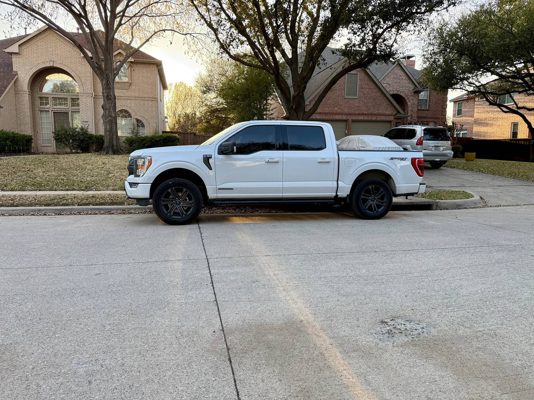

Eibach Stage 2 coil-over package. Installed on mine a few months ago. At max spring preload my PB was actually just slightly higher in front. I dialed out 16 turns from max for just a little bit of rake which softened the front just right. Each turn is aprox 1/8th inch. It feels more planted now. No more under steer in turns and bumps & ripples are dealt with more confidently with less bounce. The change is not huge but you can tell it is much better all around.
The lighting isn't great in this picture but this was at max compression. The back passenger tire was sitting in a little bit of a rain gully so it looks a little more front-high. But you get the idea.
Ford F-150 Proven coilovers systems for our Powerboost IMG_0751
I dialed out 8 turns and got this:
Ford F-150 Proven coilovers systems for our Powerboost IMG_0748
And finally settled on 16 turns out:
Ford F-150 Proven coilovers systems for our Powerboost IMG_0796
I don't tow a lot but still want my truck to be 'functional'. I don't mind a little rake. Just not the crazy factory rake.

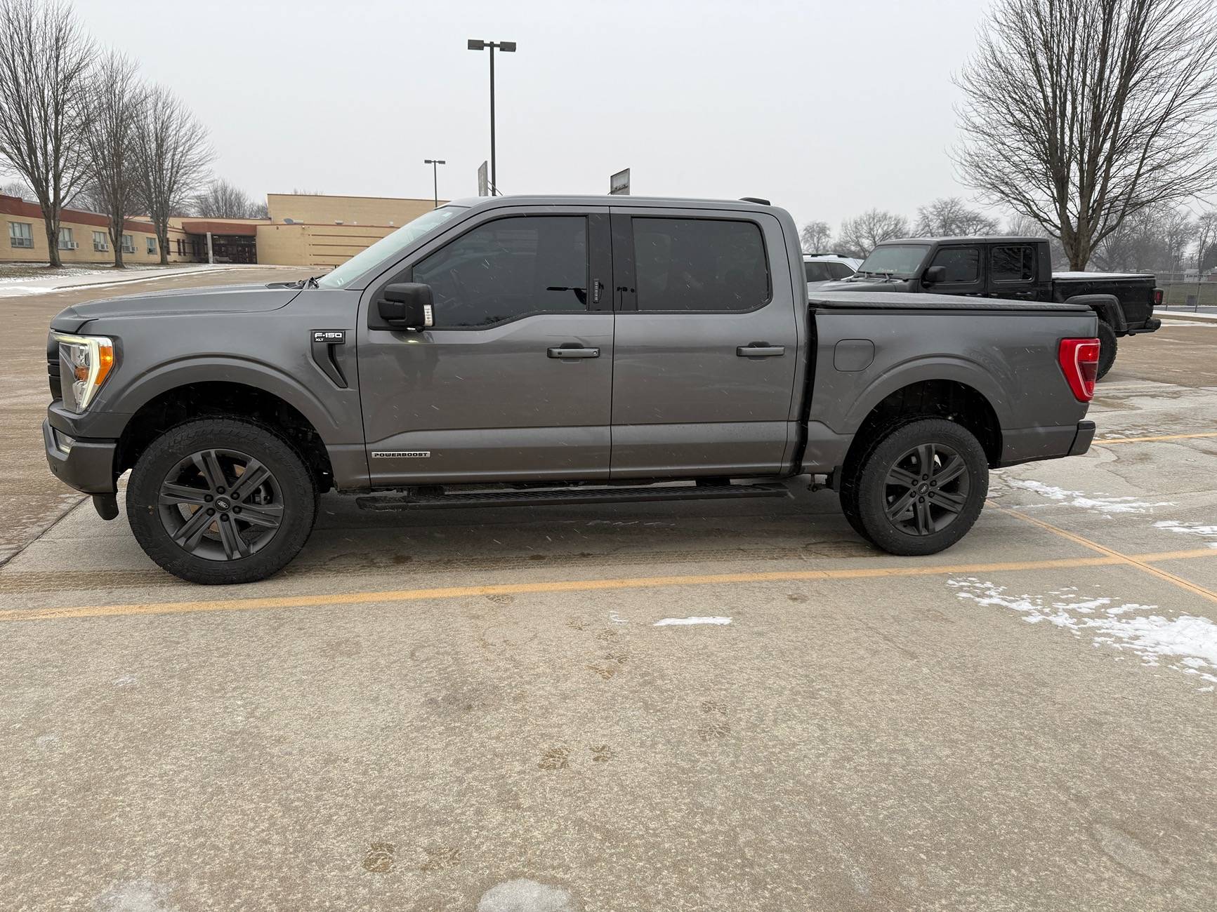

I have the Bilstein 6112s in the front and replaced the rears with the Bilstein 5100s.
Ride is definitely firmer than before, but that’s what I was going for. You feel the bumps, but there’s little rebound—whereas before, I felt like the truck floated and bounced after hitting a bump.
The 6112s in the front are on clip #5, which is supposed to be 1.4” of lift. There’s also a #6 clip, which is supposed to give you 1.9” of lift. I like a little bit of rake. I’ve never measured the rear and front with them lifted—just the eyeball test.
Check out Shock Surplus—those guys were super helpful and love to answer any and all questions.
