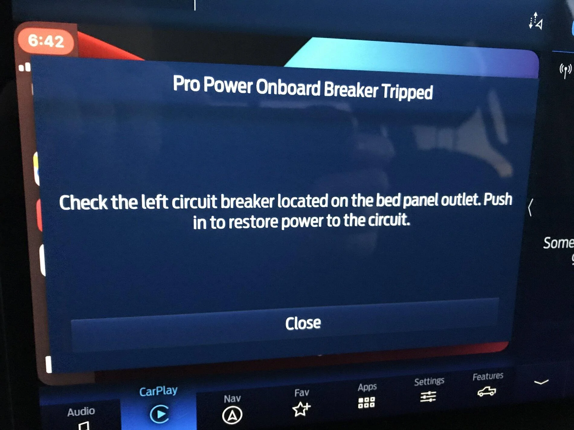

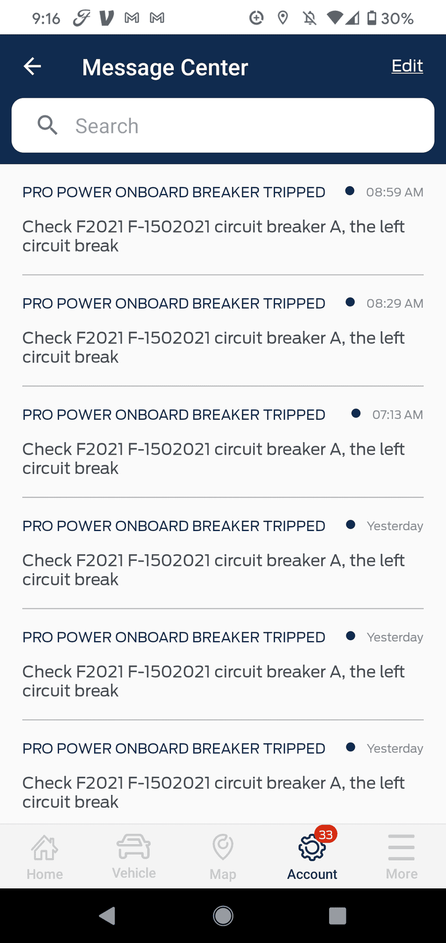

I've been getting this since owning the truck (2 days). On start up I see a similar message on the big center screen with an OK button to clear. All four 120V outlets in the back work without me having to do anything except turn the truck on and hit the green pro power button in the bed. So I suspect the problem may be with the 240V outlet but I don't have a way to test that one. Anyone have more knowledge of the electrical / circuit breaker configuration?
The dealer tech wasn't seeing any codes come up and since there is 0 information on this online and since I don't think this will effect me in the near future I figured I would wait a few days to see if it resolved on its own. Leaving the truck with the dealer will likely mean communication with Ford and I'm guessing 1+ week in the shop.
Ford F-150 Pro Power Onboard Breaker Tripped Screenshot_20210207-091632

Yesterday, when I pickup my new 2021 F150 Powerboost crew cab 6.5box 7.2kw. I got this message on the screen, still in the dealer lot. So I got a appointment on Monday, let see.
Ford F-150 Pro Power Onboard Breaker Tripped 151B7952-95F7-4FDC-AC87-60521D781485

I had the exact same problem, same messages. Was in the shop 2 days. Dearborn got involved. Turns out there is another circuit breaker on the dash, just above the 110 receptacle. They pushed that, problem solved, never came back.
Thanks, I tried it and it worked, I will cancel my appointment Monday morning.
