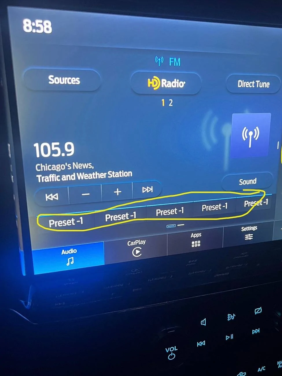

Helo I am having exact problem with presets, can U please specify what exactly did You change in forscan values in as buld data apim?

It must be apim because thats the module I have changed, I also forgot to mention that I have swapped sync3 to 4 in my 2017 250 everything appears to work except stations
Ford F-150 Presets all say preset 1 IMG_8318
Ford F-150 Presets all say preset 1 IMG_8383
