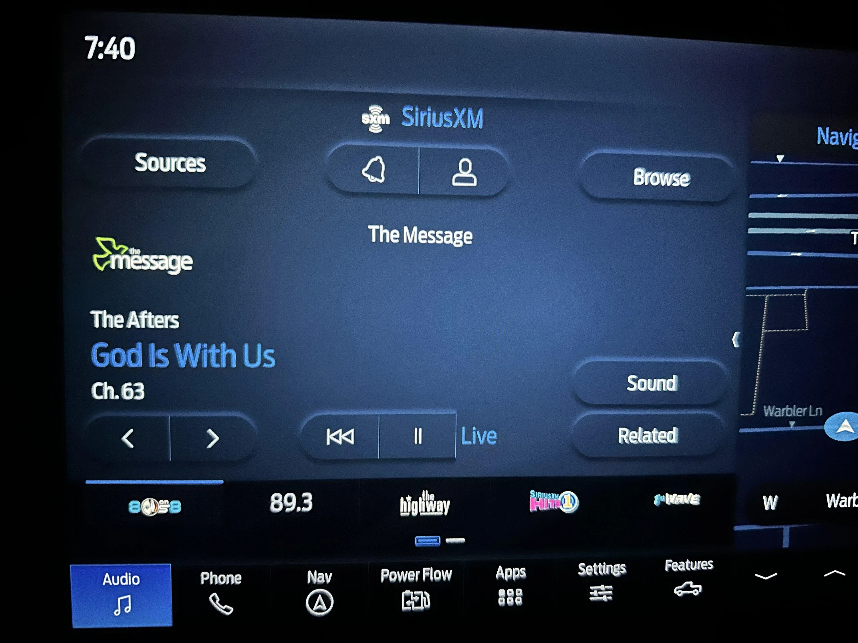

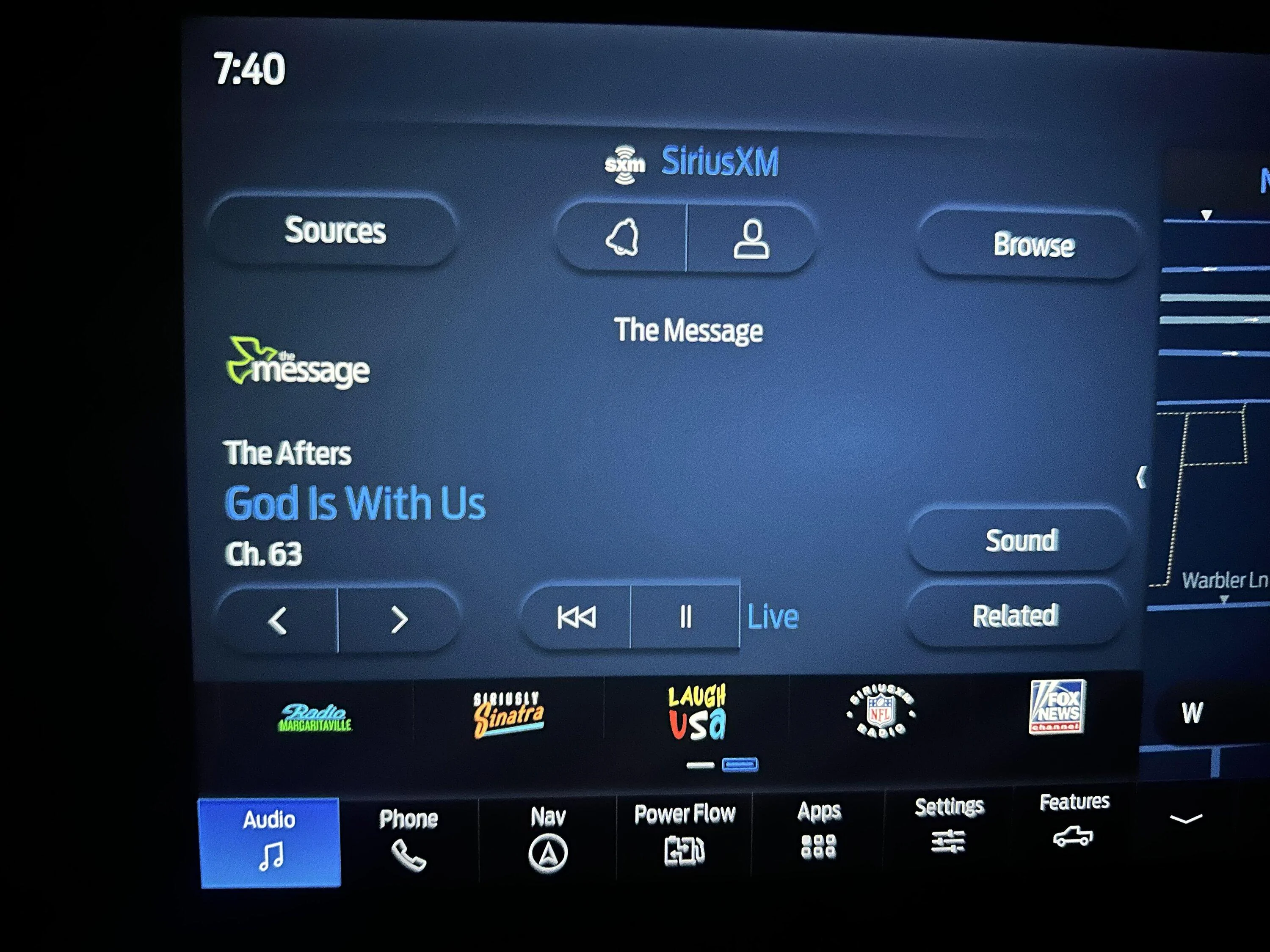

I'm having this issue as well. First happened back around Thanksgiving. I fixed all my presets (I like tomake the last 5 all the Christmas stations on XM). About a week later they changed again. So I saved them all another time. Now this morning the same flipping thing happened. All my presets were gone and looked like the OPs.

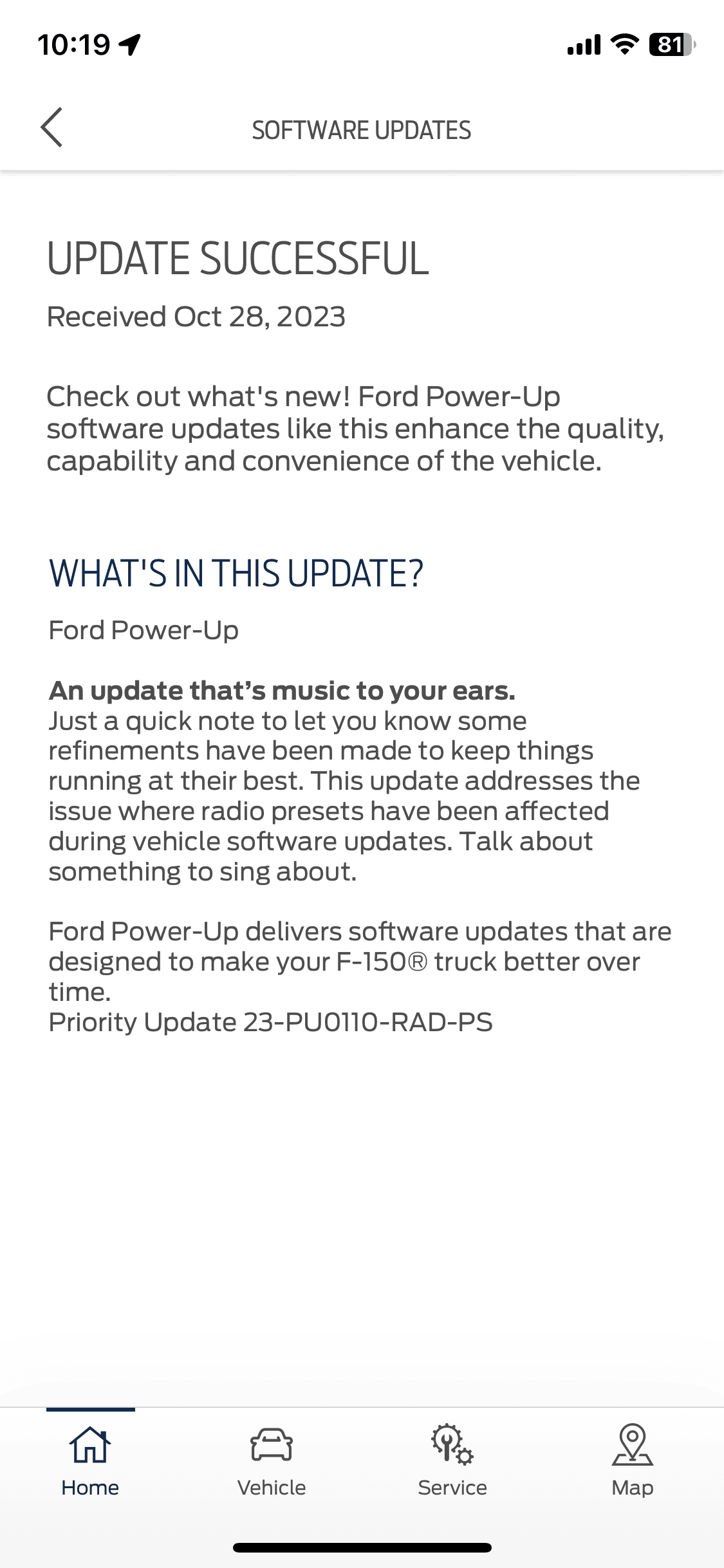

I got 23-PU1024-6CH-AUD via OTA yesterday. Today not only were my XM presets reset back to default, but so were my FM presets. This is new, Ford has managed to make it worse instead of better.
