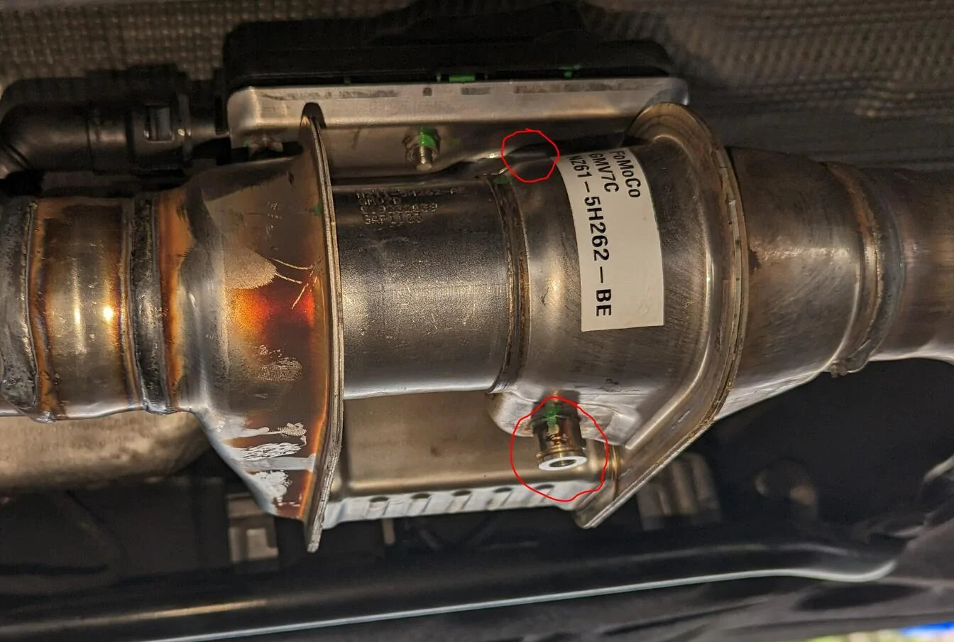

Ford F-150 Powerboost squeal when going electric to ICE - Help me! Screenshot_20250702_210324_OneDriv
