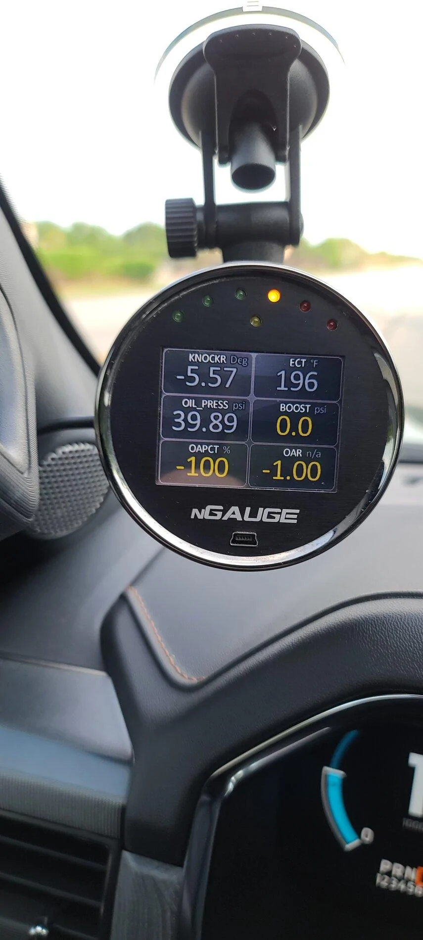

Here are 2 captures of oil pressure, one at low pressure stage (low torque request) and one during EV.
Ford F-150 PowerBoost rough charging idle. 20210622_085813
Ford F-150 PowerBoost rough charging idle. 20210618_151203
Here's the only reason I am hesitant to accept that somehow Ford is maintaining oil pressure at 14.79psi, as the ODB pid is reporting........
Although the first picture shows the engine running oil pressure at 39.89psi, that numerical value barely lasts for one frame of a camera shot. It's literally changing at an impressive refresh rate of multiple times per second. The actual fluctuation is about 5psi up/down.
But the EV oil pressure is static. It will literally stand at a value 2 decimals long for 4 or 5 seconds and then maybe change to another static value for 5 seconds. I can't get my head around what pumping mechanism could be that stable.
But I DO believe it is probably "holding" pressure with some kind of mechanism. I'm very curious to discover these kinds of things on this truck because I'm so far incredibly impressed with some of the engineering challenges that Ford came up with solutions for.
Note on the oem dash oil pressure gauge :
It is fake. 100% make believe. I would even say it is shameless. It can only show ONE value other than zero oil pressure because it is nothing but a graphic image that reflects a binary result of yes or no. The yes is IF the truck has 7lbs of oil pressure. The no is that it doesn't. In other words, the pressure sensor that drives that image on the dash can only report whether the truck has or does not have 7lbs of pressure.
It's a really pretty blue gauge, but it isn't a gauge. Lol
