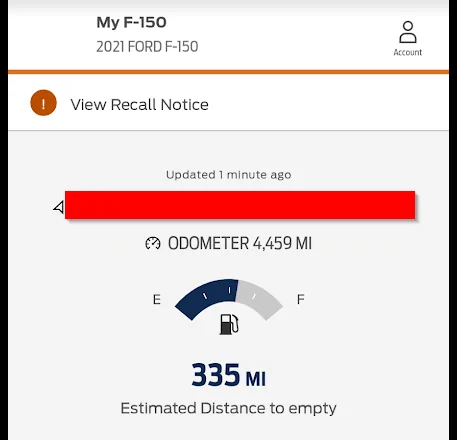

For another data point, I'm at 4460 miles and the OLM says I can go another 5800 miles. That would put it slightly over 10k total miles which includes electric miles. I am not near the truck to fetch the lifetime electric mileage, but I would guestimate a couple hundred and can update this post once I verify. I have towed a 6500lb TT about 900 miles of the 4460 so far, so almost 20%.

Update: I have just under 500 electric total miles. So that would put me right around 10k for OCI regardless of 500 electric miles and 900 towing miles so far.
However, I'm leaning towards getting the first one done at 5k and then riding the OLM after that.
