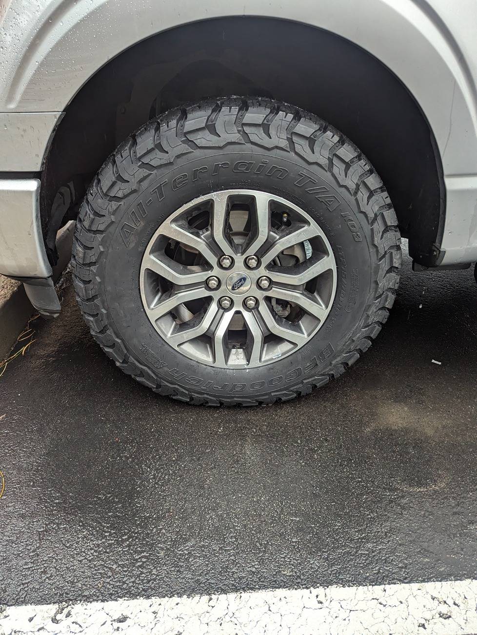

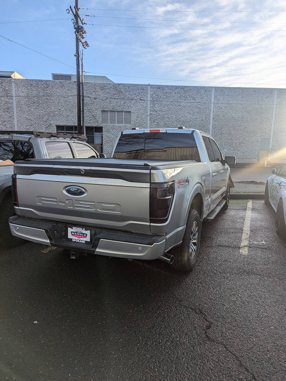

Just bought some ko3's and this murdered my mpg. Having said that the conditions around town are not ideal (bend,OR-mt bachelor) but the fuel economy has gone down like 4-6mpg. I expected to take a hit but damn what's the point of the pb? Won't stay in ev mode near as long. Tire size is 275/70/r18 2021 pb. Heard the livernois can help with mpg also, can anyone confirm? Would be into getting the sled tuned if I could utilize the battery ? for fuel economy. Thanks!
One more thing the Ko3's have a wobble in my steering wheel that will not go away, I have had the tires balanced 3 times and am about to return them and grab a diff at tire any suggestions

That’s what E rated tires on f150s do, especially an all terrain. Your results corresponds to basically every thread here.

I’m running the same size but SL not LT. Stock tires are 43 lbs you can still run that size look at the general ATX weight at 45 and the nitto G3 at 45.6 . The bfg are great tire at the price of mpg . Bfg =60 pounds.

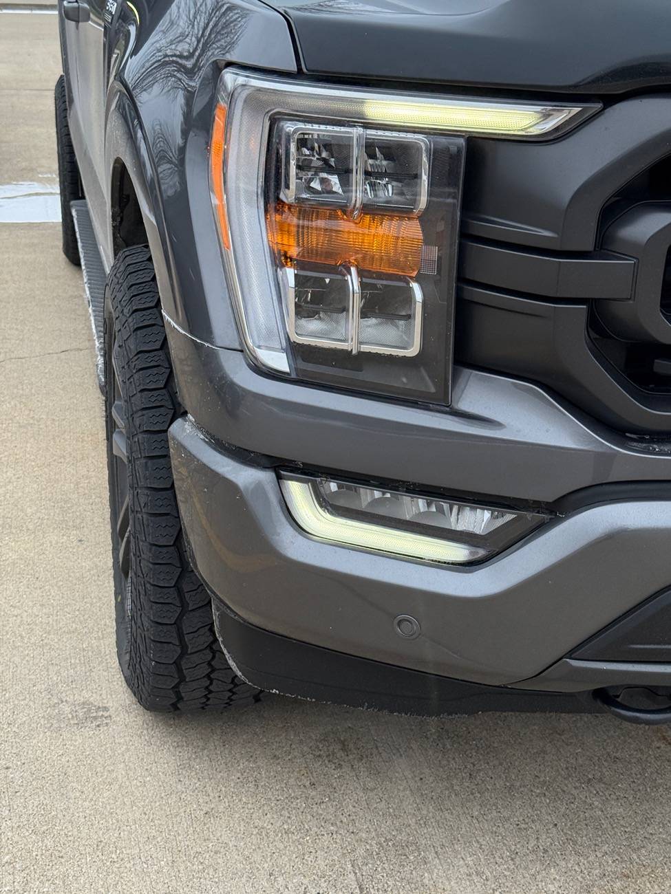

I have a 21 PB XLT and I run the Vredestein Pinza ATs SL 275/60/20 and I have been very very happy with them. I average about 21-24 city
I did a 200 mile trip on the highway driving to Chicago doing 75 and I got 23.7 which I think is pretty good in winter running the heat and heated seats!
they are on on road all terrain, but do very well off road and on snow. I have a property off the beaten path and I have had no issues with them whatsoever

I think they have a pretty decent "aggressive" look
sorry about the dirty salty truck.....its bad out here in the midwest
