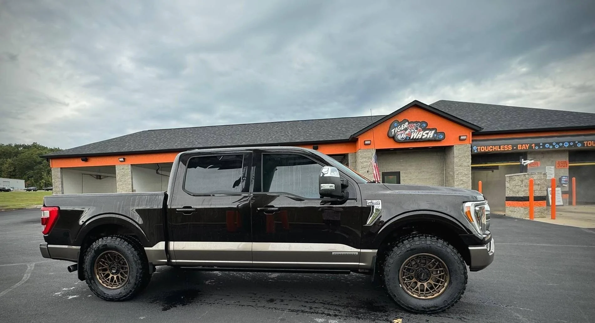

Any feedback from Livernois customers who run larger than stock tires?
I took a decent hit on the MPG's on the interstate, and I'm not certain if my pickup is just recalibrating for the bigger tires (they are only 8 pounds heavier per corner compared to my OEM 20's). But it was a noticeable drop on the interstate. I can still get 23 MPG around town, which isn't terrible, but I'd obviously like to see an improvement if possible.
I understand I will never see 30+ like some of you......but 26-27 shouldn't be impossible since I'm running a very conservative offset and lift.
