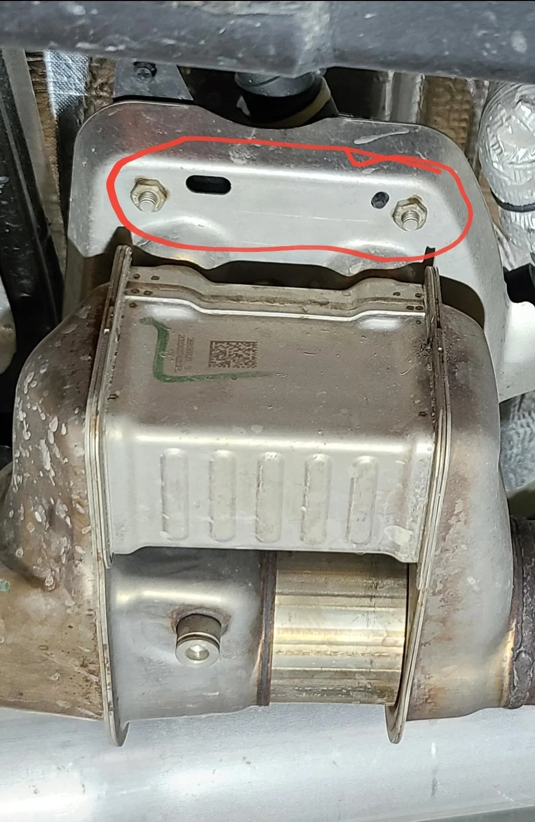

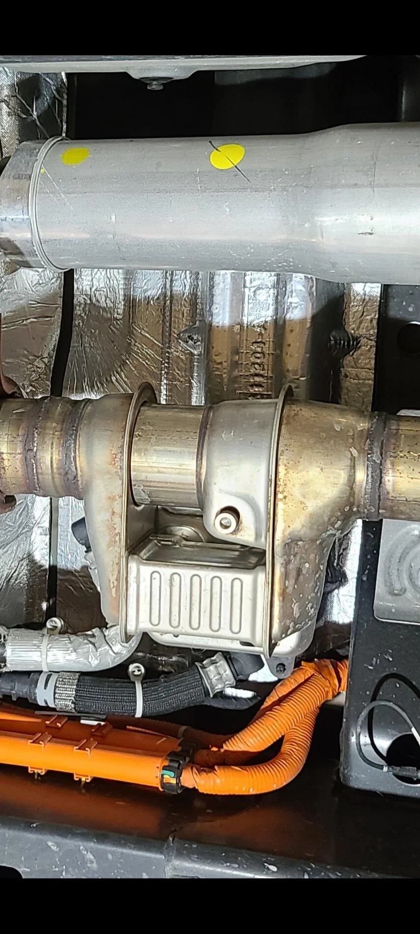

Powerboost Exhaust, or 2021 3.5EB too?
I recently traded my 18KingRanch for the Powerboost. I had a really nice hand fabricated and ceramic coated exhaust on the 18 and I removed it with the intention of putting it on the 2021. (the Ecoboost exhaust hasn't changed from 2011-2020, so I had my fingers crossed)
Anyways, 30 seconds on my lift and I knew it was a no-go! What IS this thing? Lol
It's snuggled in between the exhaust clamp of the downpipe and the resonator. Is it on ALL 2021 Ecoboost, or Powerboost exclusive?

I’m guessing some sort of engine/exhaust brake? Definitely not on the ecoboost’s.

Don't know if it's PB only, but it appears to me as though it's part of the exhaust monitoring system - I see sensors, wire harnesses, and hard lines that lead up towards the engine bay...can't see anything that indicates it would be Powerboost specific, but I'm crawling around on my back in the driveway so I can't really tell.
In either case, it looks like you've found a reason why we don't see any aftermarket exhausts for 2021 out yet...
So you have seen the non-Powerboost Ecoboost 2021 model and that contraption wasn't there?
I'm going to try to get better pictures of what exactly is connected to it. I know the orange cables are Fords way of wrapping the high voltage lines related to the Hybrid package, which makes it so much easier to exclude when you are tracing. Thank you Ford.

Looking at it, best guess would be a great exchanger for the battery coolant loop to warm the batteries in cold weather when needed. It will be interesting to find out what it is though
You know, that actually makes sense even if it turns out to be something else. I hope to know soon when I download that fancy manual that I just purchased. I don't know why I'm a little skeptical of the manual, but it's probably because I wonder how it is already obtainable when so little of anything else is yet.
