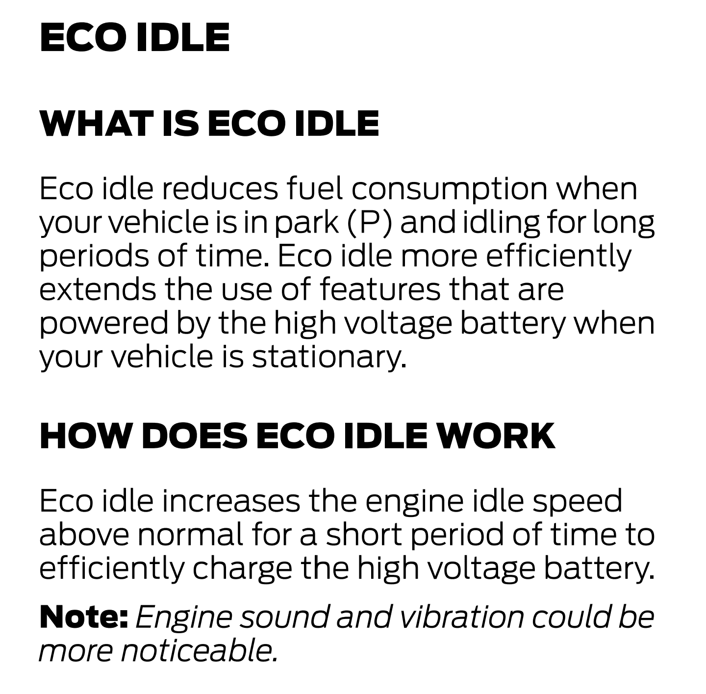

2022 F-150 Lariat Sport Powerboost.
who uses eco-idle and who uses non-eco idle and why?
I use Eco Idle because I work from my truck often.
It's the BEST work-from-vehicle ever!

I've never used it... so basically if I am understanding what you guys are saying... when enabled, the truck idles with higher rpms to charge the battery faster so the engine runs for a shorter period between idling in electric ? If that's the case, I may try it.
You are correct

For me I only experience the high idle in Park.
So it doesn't seem to apply if/when it would be loading against the torque converter.
I haven't paid that much attention, but I swear it idles higher when driving and the battery is depleted, but I can't be sure so you might be right on this one. I'm still waiting to set up a tablet or something with Torque on it or something to monitor all the goodies :)
I know I've seen it when parked.
It may very well increase the idle rpms in drive, but only by a couple of 100 RPM. You might see 800-900 Rpms at times. But I only see the 1300+rpms in Park.
Yep, that's what it does. ~800 RPM with Eco Idle off, ~1300 with it on. Idles faster to get the battery charged faster.
My truck runs 1000 RPM Eco Idle off and 1300 RPM when eco idle is on. Would the air temperature make a difference in the idle speed to recharge the battery when eco idle is off.
It'll idle faster when its not warmed up too.
