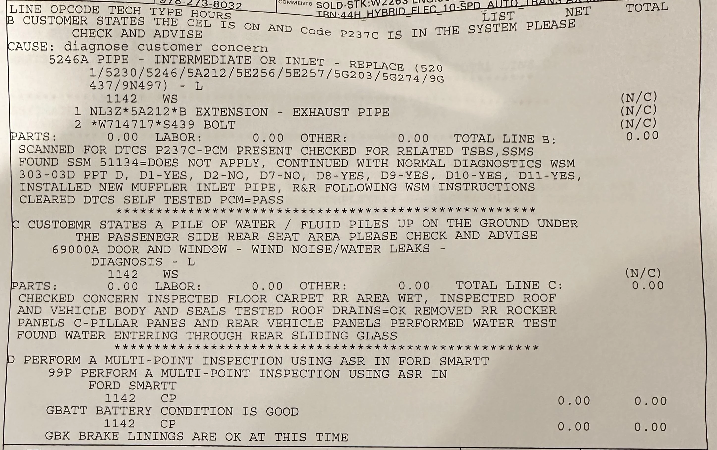

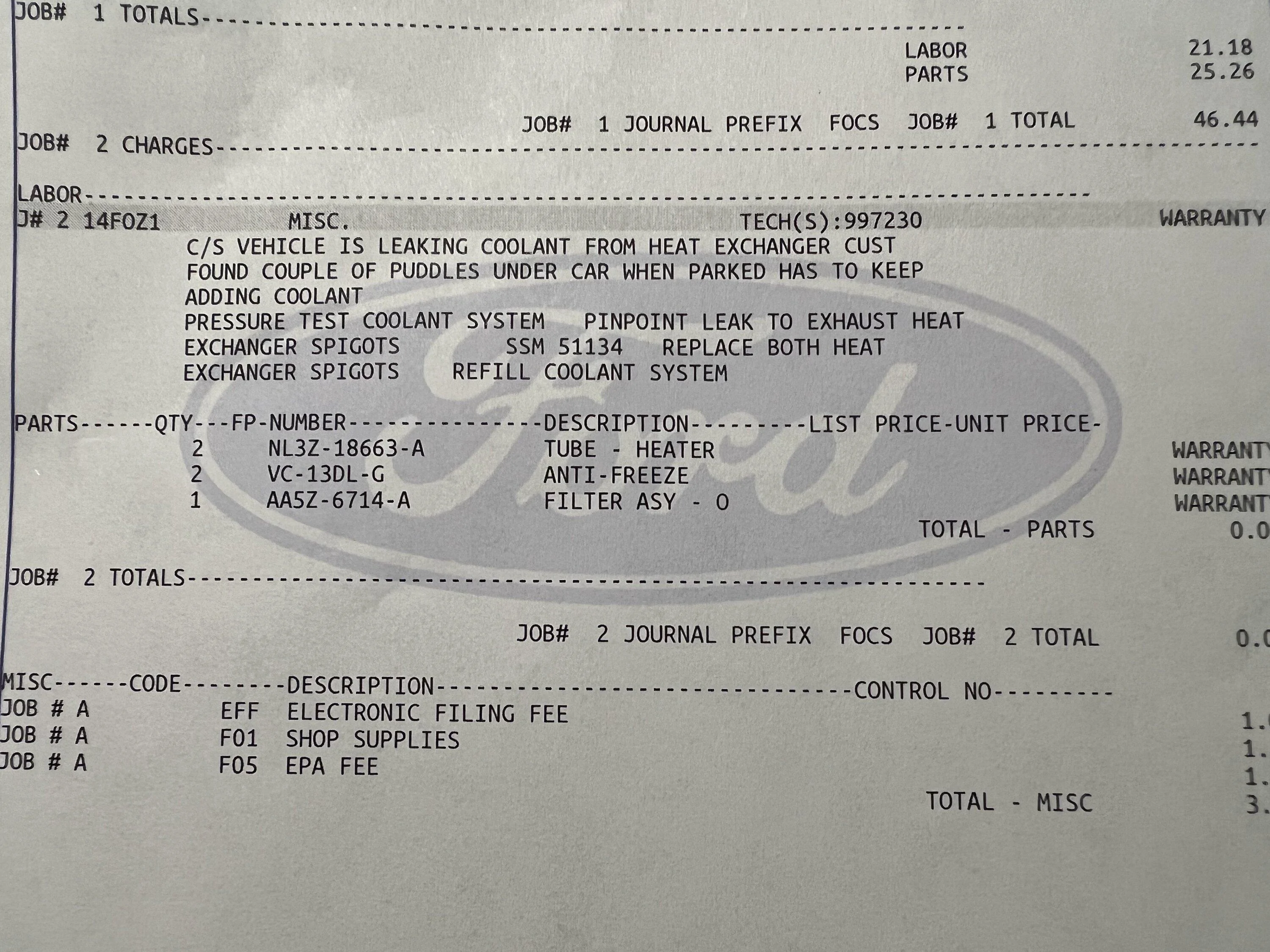

Just got my truck back and not feeling great about it. Either I had a different problem with the same symptoms (unlikely) or I am going to have my light back on soon and be in for another appointment.
My dealership didn’t replace my heat exchanger, which is most likely why they were able to get parts so quickly but replaced a part of my exhaust pipe- 5236A which appears to be the part below. They also are relating my puddle to a leak in my back window that still is waiting on parts.
Driveway is wet with snow so wont be able to tell if there is a leak for a couple days but will be watching closely for my light and the same DTCs.

Just had my heat exchanger fix done. They didn’t replace the exchanger, but did replace the lines. I’m assuming that will be the fix going forward and the culprit for early repairs to fail.
Took a week to get the parts
Ford F-150 Powerboost CEL P237C/Exhaust Heat Exchanger Leak Megathread 659AFDD6-C052-4BD1-B900-288E3264647A
I don't think all leaks are equal.
Changing the lines is not going to address a leak that's internal to the heat exchanger itself.
