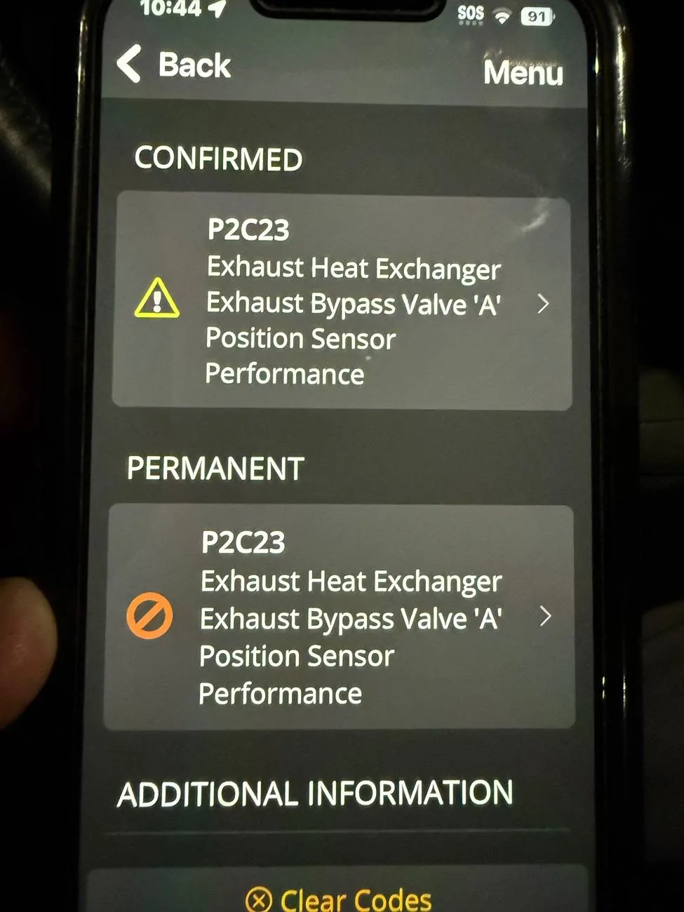

I was just impressed with myself for plugging in the OBDLink and pulling the codes without asking how first ?
You genius ?
Did you clear it, to see if it's just a one-timer?

You genius ?
I cleared it and the CEL is extinguished. There’s a temporary and a permanent latch apparently. Same code.

Did you climb under to verify if you actually have a leaker?
Or just a malfunction of the valve solenoid?
If it's a leaker, it just needs the $5 tubes.
If it's the valve, they'd have to replace the assembly since the valve/solenoid isn't available alone, I don't think.
You sure you want them to have the truck before they can tell you parts availability? ?

I misspoke. I called James my service guy this morning. He asked if he could have it picked up tomorrow and that he will call me back with a time. Perhaps he’s checking parts availability along with the delivery service.
The exchanger module is dry with the vehicle off and cool. Coolant levels are norminal.
Based on description, it could be a random code for a random condition that may or may not be an impending issue.
But the truck is still under 3/36 warranty?
May as well have it addressed.
Clearing codes might backfire on you though.

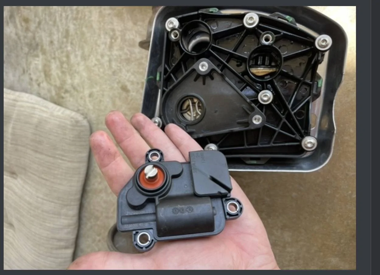

That's not a leak code.
In fact, the leak usually isn't accompanied with a code.
The exhaust valve/solenoid is what usually throws the code.
It's this little fella:
Ford F-150 Powerboost CEL P237C/Exhaust Heat Exchanger Leak Megathread IMG_1990
