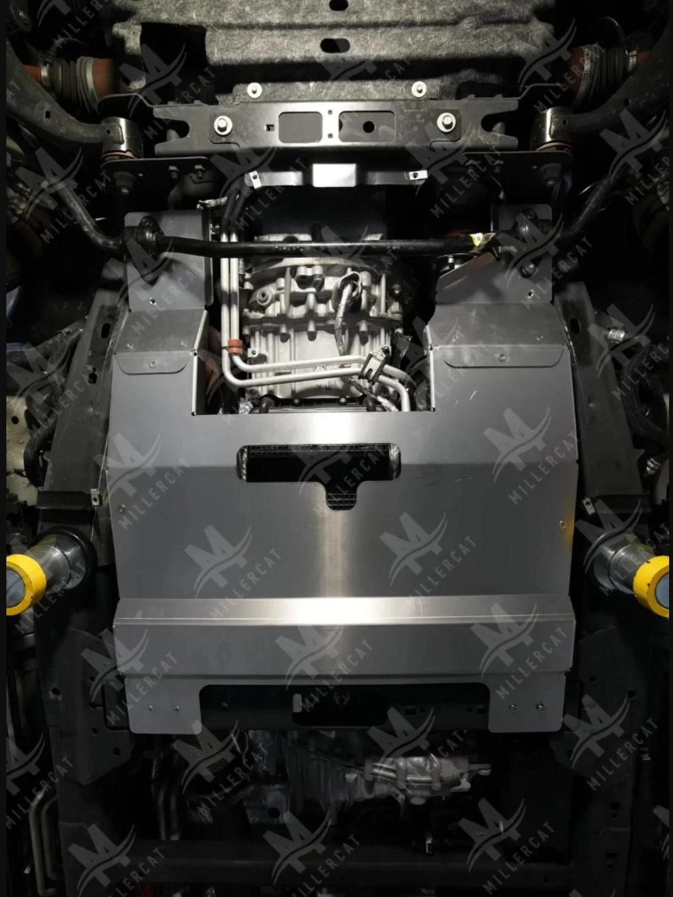

2. Millercat Powerboost hybrid CAT shield
The Millercat is a CAT shield - not a skid plate - and the company specifically states on the website that it is designed to be used under normal driving conditions, which I interpret as road/highway use. It is lightweight compared to the Talons, being constructed of .125 inch aluminum. I could not find a weight, but being half the thickness of the Talons, I would guess +/- 25 pounds. This shield is a "U" shape and leaves an open section in the middle of the plate that allows for easy oil changes, but leaves a section exposed. Current cost is $360 plus tax (shipping is "free").
Ford F-150 Powerboost CAT Shield - Talons Garage or Miller CAT Millercat f150-hybrid-shield-full
