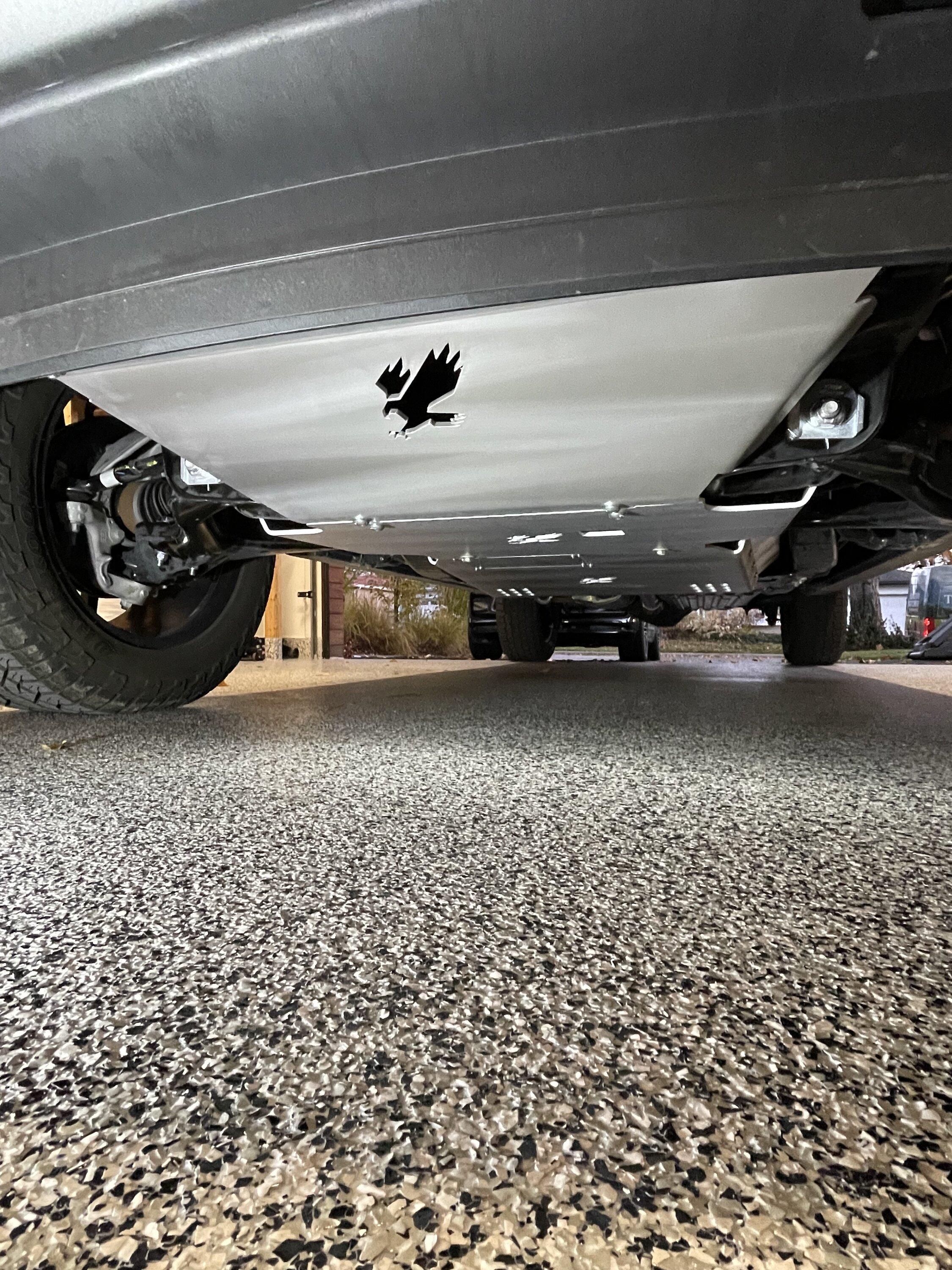

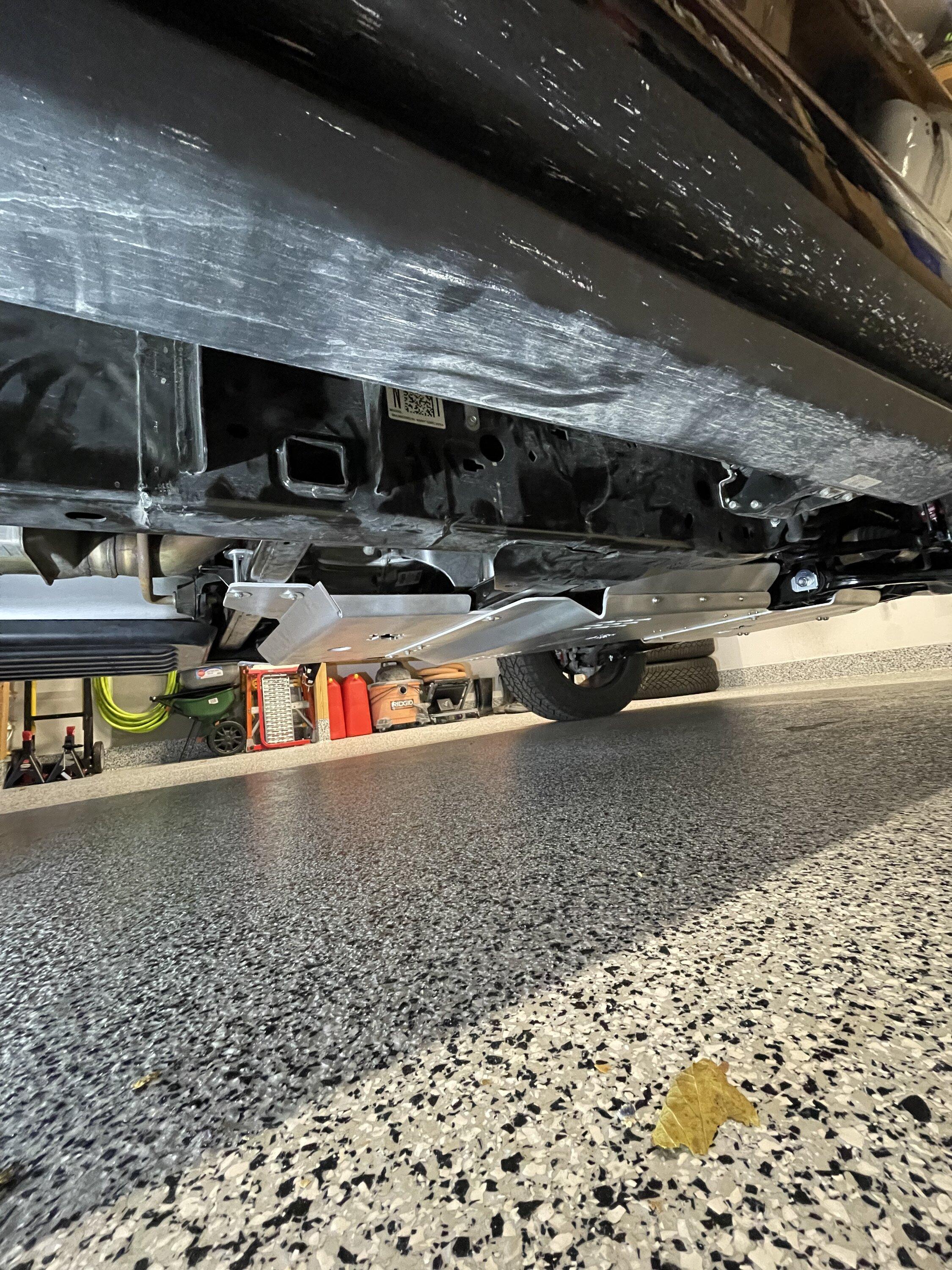

I just got around installing all plates and overall it went smoothly. I also weighed everything.
OEM engine plate is 12.42lbs
OEM transfer case plate is 8.24lbs
Talon engine plate is 25.82lbs
Talon catalytic converter plate is 35.32lbs
Talon transfer case plate is 13.30lbs
Total OEM weight = 20.66lbs
Total Talon weight = 74.44lbs
Added weight to truck = 53.78lbs

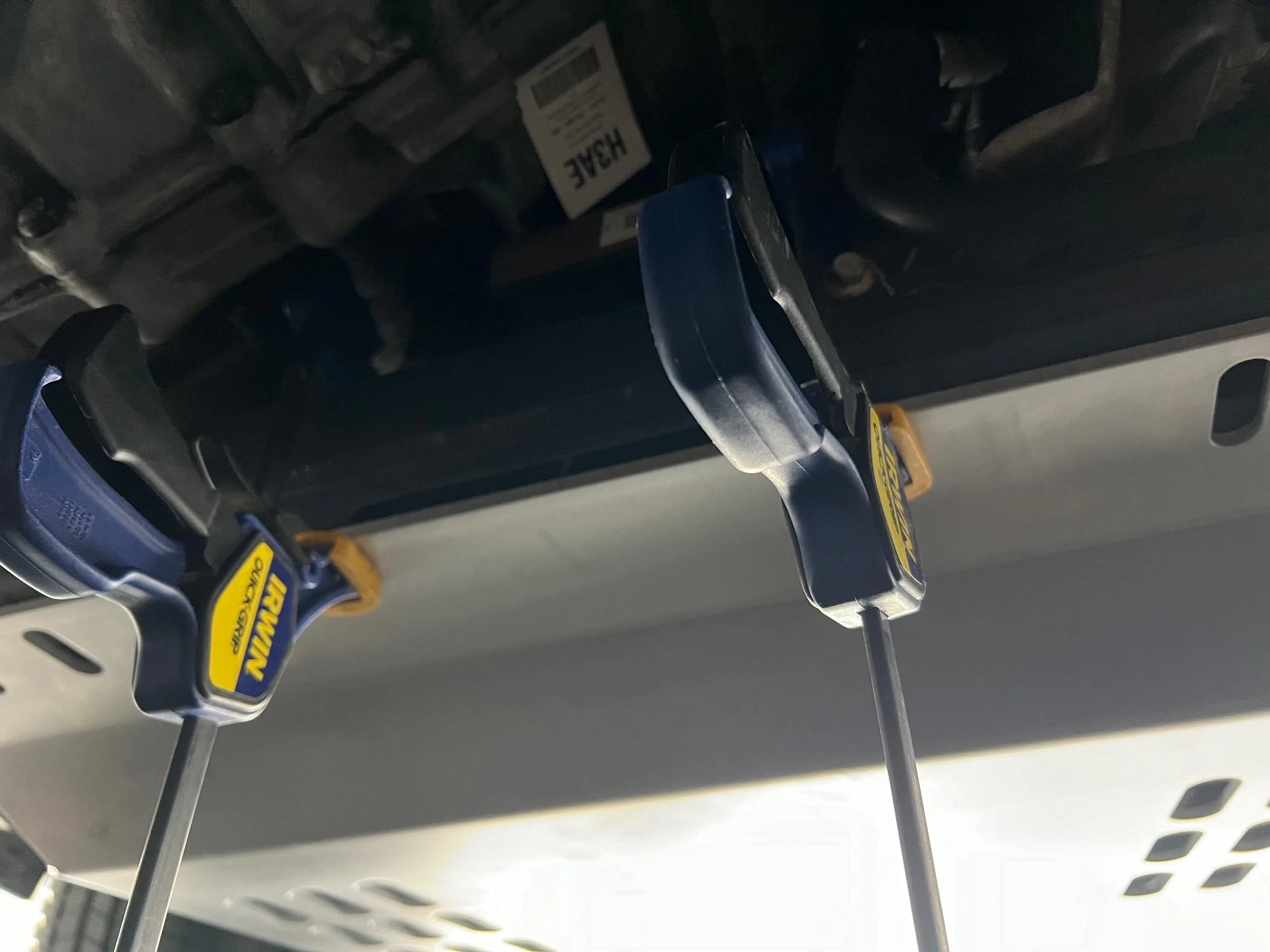

I know it has been several months since anyone has posted on this thread. But I thought I would share my experience in case anyone in the future is looking for additional insight on a Talons Garage Catalytic Converter skid plate.
First, this is an excellent product. It is very well made and includes everything you need to install it (not the tools of course). I would not hesitate to purchase for the protection or just to replace the felt liner. I have the FX4 skids on my truck, so this was in addition to those. I installed this by myself and the truck was not on jacks. Lifted would have been easier for sure, but this was not that difficult. Here are the steps I used and one trick that worked great:
1. I removed the felt liner completely.
2. I loosened the two bolts on the front skid plate (FX4) but would be same two bolts for a felt liner. I loosened them till they almost were out.
3. I loosened three of the four bolts holding the transfer case skid plate and rotated it out of the way (leaving one bolt holding it on)
4. I placed the Talons skid plate (with the wings attached of course) on the ground under the truck exactly where it would go. I then layed parallel to the plate with my head at the front. I lifted the front end and slid it onto the two front bolts I had loosened earlier.
5. While holding the side of the plate so it could not slide off the two front bolts (the back end was still on the ground) I slid a box (about 6” high) under the plate so it was now sitting on the box and the two front slots were being held up by the two front bolts. Now it would not slide off.
6. I then (and this was the key to making this an easy install) I slid in behind the unit, lifted the back of the plate up against the frame (beam) and used a “one handed bar clamp” and clamped the plate to the frame. I then was able to easily shift it to make sure it was lined up correctly. Once all lined up, I added another clamp to make sure it was securely held in place. Now it could not slip of the front bolts and was in position to easily be bolted to the frame.
7. Since the plate was now secure, I deviated from the instructions and did the bolt on the passenger side first. The metal heat shield was in the way, but there was just enough room to slide the washer under the edge of the metal heat shield and the bolt went right in place. I then added the nut and tightened it loosely.
8. I wanted to make sure the transfer case plate would attach correctly so I rotated that back in place and hand tightened those bolts back in .
9. Then I installed the driver side bolt. This was the most challenging as the washer kept falling into the slot in the frame before I could get the nut on. There is not much room for the nut so the bolt can barely stick up through the slot while trying to start the nut. But because of this, the washer kept falling into the slot. A magnetic retriever slid into the side of the frame would get it out. I eventually had to push the bolt through a piece of paper, then drop the washer onto it so it could not fall through the slot. That worked perfectly.
10. I then tightened down both back bolts and the bolts for the transfer plate. Then I tightened the two front bolts. Then I removed the two clamps. All done.
The process was very straight forward. Having the correct tools out in advance made it easy to access them as needed. Using an impact driver was very helpful to loosen the existing bolts. I would definitely put the oil plate brackets on before installing the plate, as that will be much quicker. Doing this yourself is fairly easy. However, it would be great to have a helper just to hand you the things you need so you don't have to keep sliding out from under the truck, as that takes the most time.
I have not noticed any different noises at all with this installed in place of the felt liner. I am extremely pleased with this product and install.
