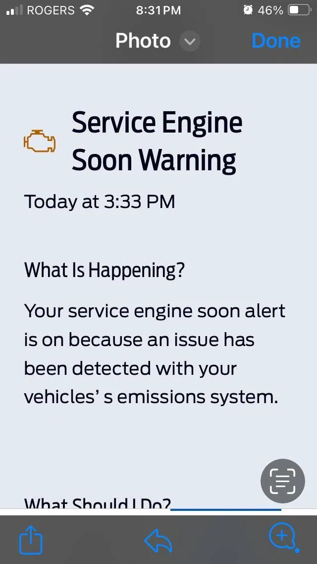

First off I searched for this code on this forum but didn’t find any info. Lots of info on the other F150 forums however.
So I was out getting a cheese wheel and when I shut the truck off it shook briefly which caught my attention. When I started it back up the engine light was on . Only had to drive a mile to get home and it ran fine . Plugged in my code reader and got the P2196 code . I called the dealer and they said they could see the code on their end so I’m booked for next week. I told the advisor to check a few other things as I’m still getting shuddering under load (worse when towing - I have another thread on that topic) . I love the way this things drives and handles . Really hope they can figure this out and I’m optimistic maybe it’s a coil or plug and that will also solve the other vibration issues I’ve had .
Here is a screen shot from the ford app.
Ford F-150 P2196 code today IMG_7113
Hi there! If you need any additional assistance, please send over a DM with your VIN and Ford dealer info.
