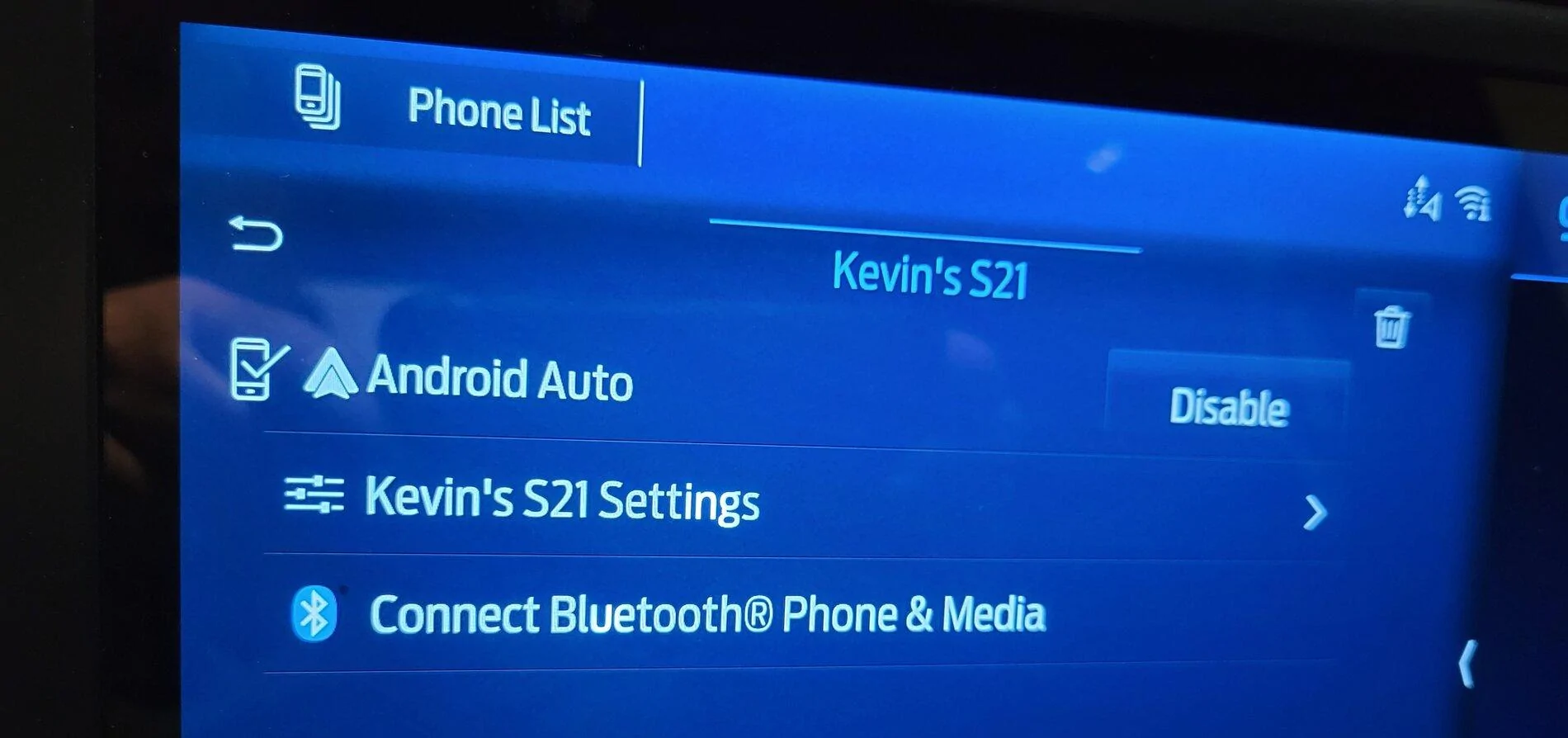

Well crap. I got my OTA update 2 days ago, and drove it for the first time this morning. Now, Android Auto is not visible or usable on my truck screen. It shows to be running on my phone, but I can't get it to come up on the 12". Regular NAV works, but just no AA, or Waze. Guess I'll need an update to fix the update. Ideas?

Try deleting the phone from Sync 4 and re-adding it. This fixed a similar android problem I was having prior to the OTA update.

I'll give that a try in the morning. Thanks Gary.

Well last night after a long drive and about an hour of listening to spotify, I started having an android auto problem. I'll have to try my own fix tomorrow. I just love when a fix, breaks something else.

so got to messing around today trying to get Android Auto to come back after the OTA update, and found this. Hit enable Android Auto, and viola! It works. Never saw this as an option before, it just came up. The thing is, I found this under my phone tab on the Sync screen. When AA does come up, the phone icon disappears and is replaced by AA. Strange, but it works.
