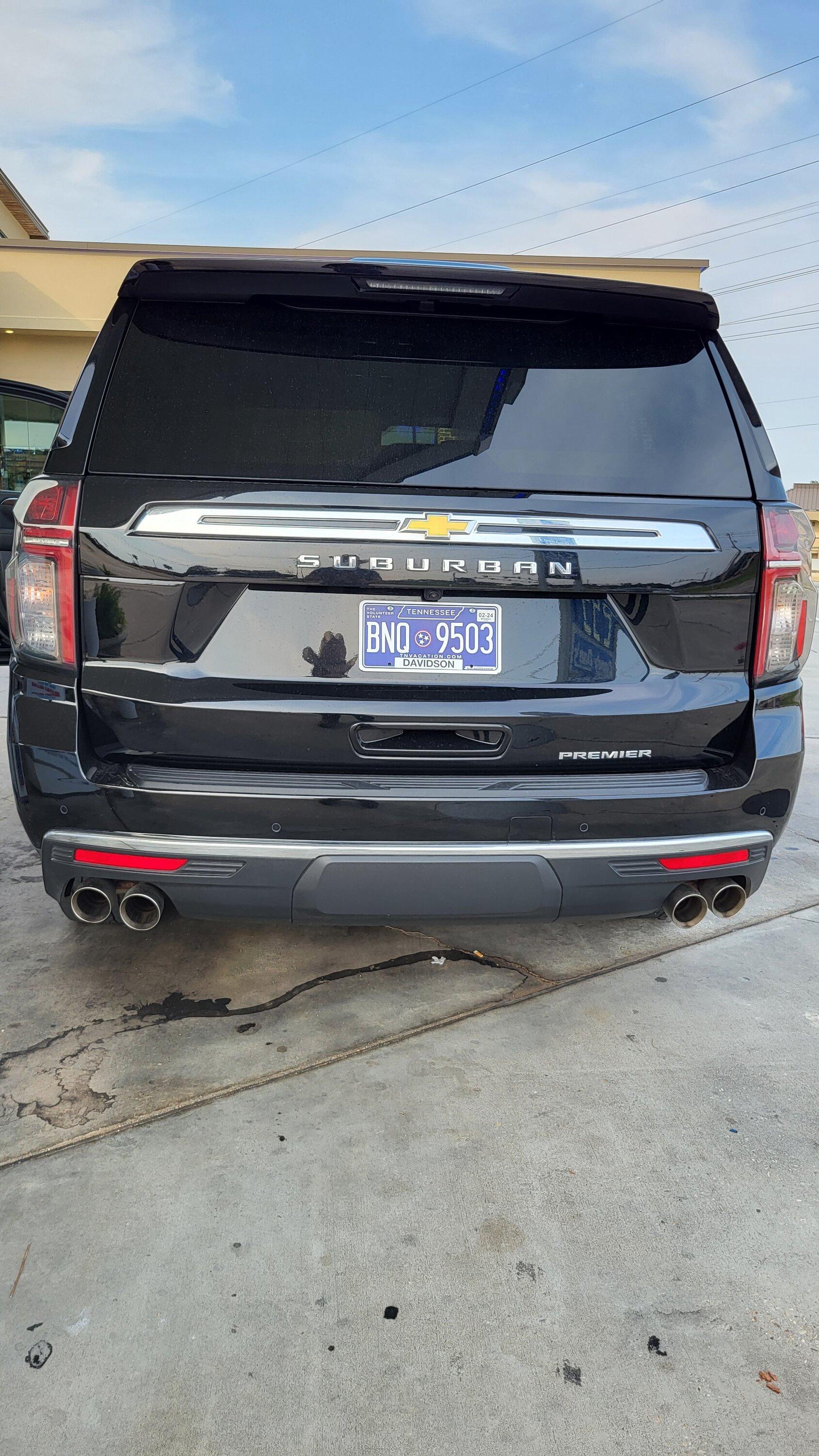

Oh, the 4 hour work day?
That was 4 hours of on campus of 1 location. We have between 30 & 40 locations at any given time. And we are open for business 24/7/365
I have never seen us closed for a single moment in the 25 years I've been there.
But not really complaining since usually I get to come and go as I please.
Although NOT today!
I just checked into some Holiday Inn in Mississippi I think? I left coastal Texas around 11 this morning driving a Chevrolet to Birmingham. ????
It was pre-loaded with everything I will need tomorrow, and it is fairly comfy. I'll try to stay positive. ?

Try some Forscan on that thing and let us know what happens....
