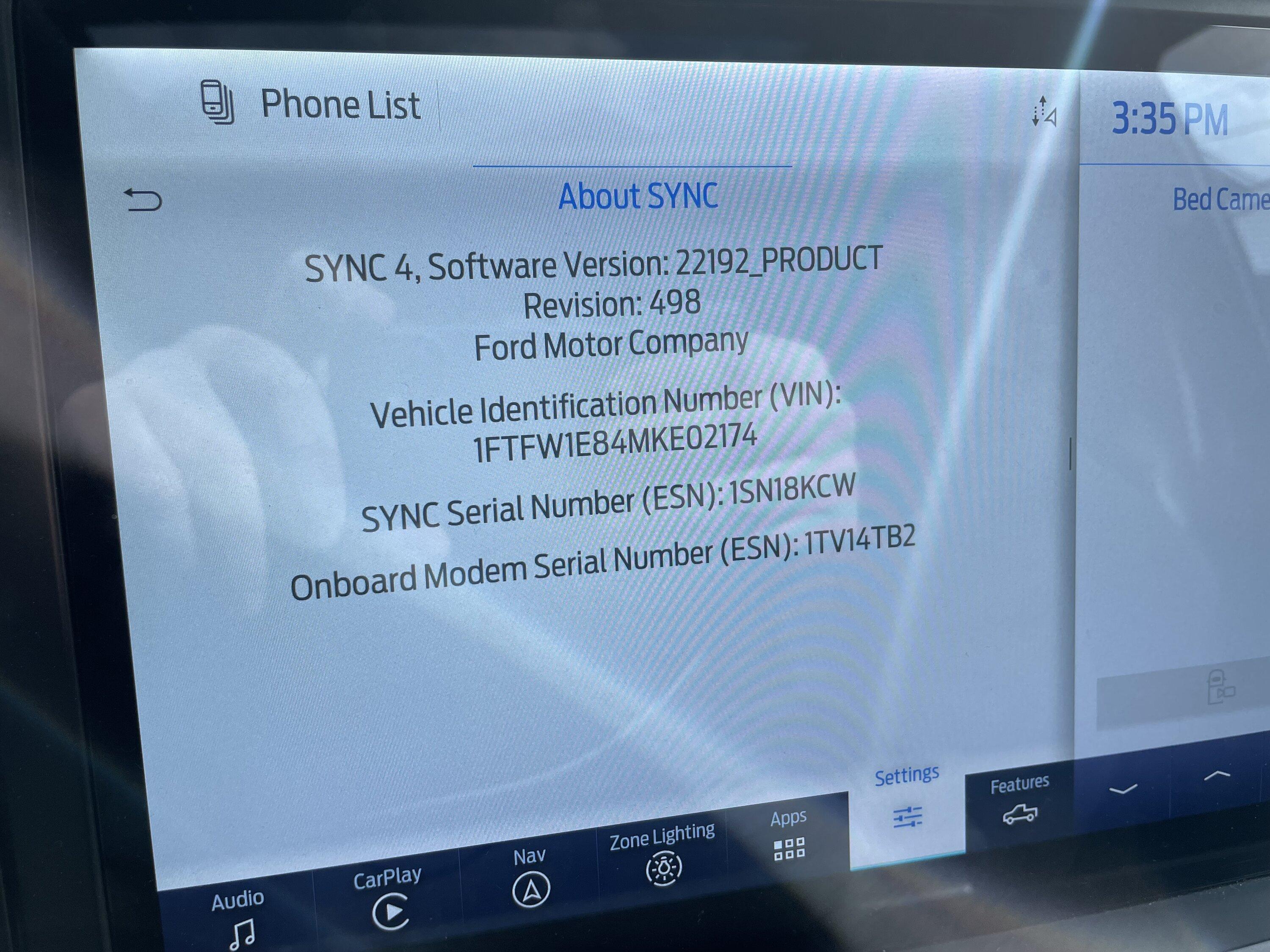

However I am way ahead than 2.1.0:
Ford F-150 Old 2.1.0 pushed OTA over new version?? IMG_8789
Anyone know how to prevent this as it seems like a big problem?

The update failed because it is a very old update. Your truck is on Sync 22192 which is many updates newer than the one that was sent to you. Did you or your dealer manually update your truck with FDRS?
The pic you posted shows the update went through, though.

I did with FDRS back in May 2022. I've received a couple OTA updates since then but was stuck waiting for the fullscreen carplay update like a lot of people. Then was pushed this 2.1.0 somehow.

I just looked up your truck in PTS. You were sent 3.5.3 back in February and it failed, and now I see 2.1.0 sitting in your queue. Ford needs to get their sh*t together.
