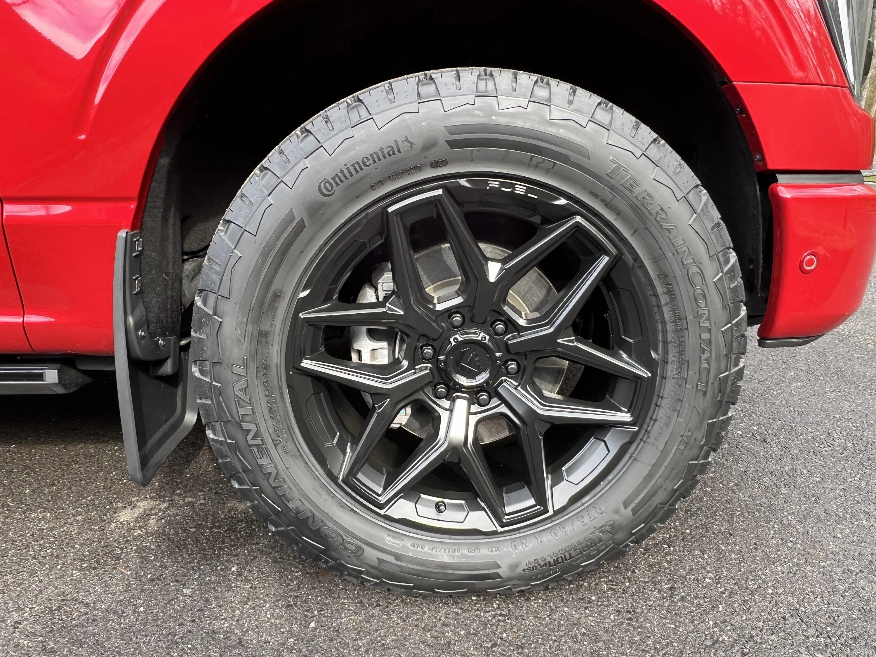

Sorry for asking so many questions. I would like to put new tires and wheels on my new 2024 XLT Crew 4x4. If I keep the tires the same size and get new wheels with a modest offset, (like +20) can I do this without any lift or level? Thanks
Yes, I have exactly the setup you described.
Continental Terrain Contact AT’s 275/60/r20 on Fuel Flux 20 x 9 +20 offset
no rubbing at all. About an inch of poke
Ford F-150 OEM stock tire size and Off Set IMG_1931
Ford F-150 OEM stock tire size and Off Set IMG_1932

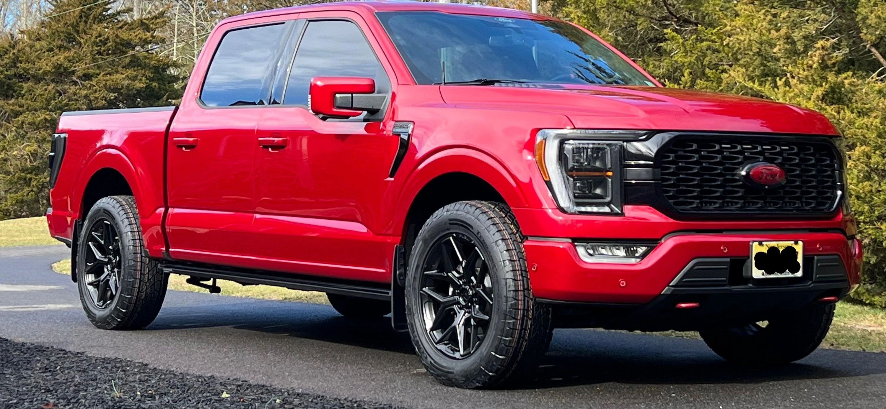

Looks good. Do you have any pictures that show your entire truck from the side?
Thanks. Here are a couple at angle
Ford F-150 OEM stock tire size and Off Set IMG_1882
Ford F-150 OEM stock tire size and Off Set IMG_1881
