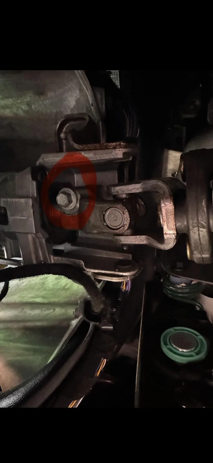

For the last few years I’ve been lurking on the sidelines and I have to say these forums are amazing. But today I decided to join and hopefully help someone with a similar issue as mine. I think I may have a fix for the clunk/rattle discussed in this thread. Going over bumps I could feel/hear a clunk sometimes rattle from the steering column. I got in it today and could replicate the noise with hard steering back and forth at a standstill. So I wedged my self into the driver foot well and found the shaft/ joint assembly had play when pulling on it. I tightened 1 10mm bolt circled below and the rattle is gone. In the photos the wheel is to the left and firewall to the right. while under there I was able to move the whole assembly back and forth. In the direction of the red arrow in photo 1. I gave the bolt circled in red a 3/4 turn and this has resolved my issue.
