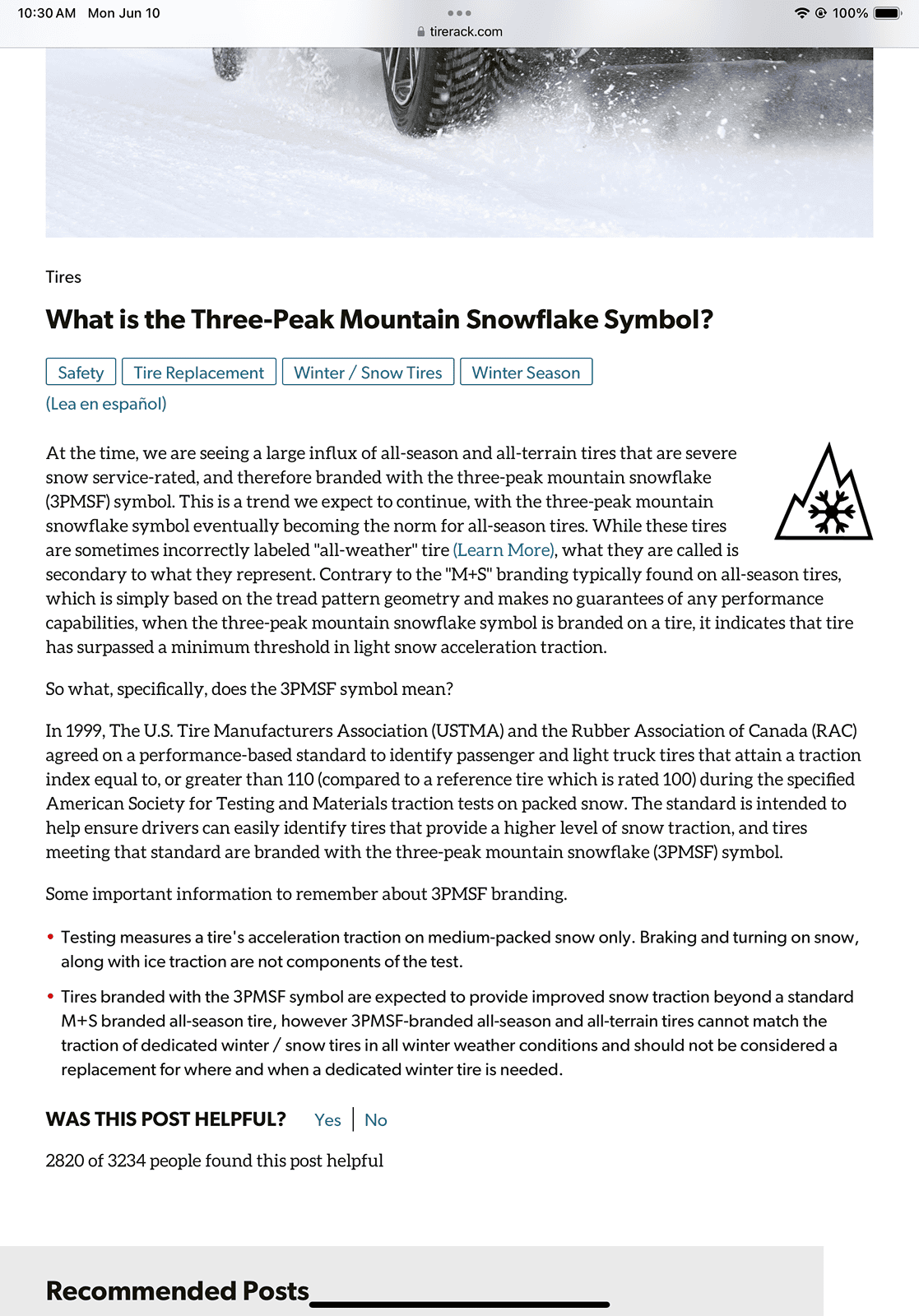

Lots of choices out there, but for look for attire that is 3PMSF rated. If you already know about this disregard
Ford F-150 New tires IMG_0564

I was doing some searching and a lot of people are recommending the Michelin defender. They say they are also decent in snow ? Also looking at continental terrain contact ht or general grabber hts 60 they just don’t have the snowflake symbol
