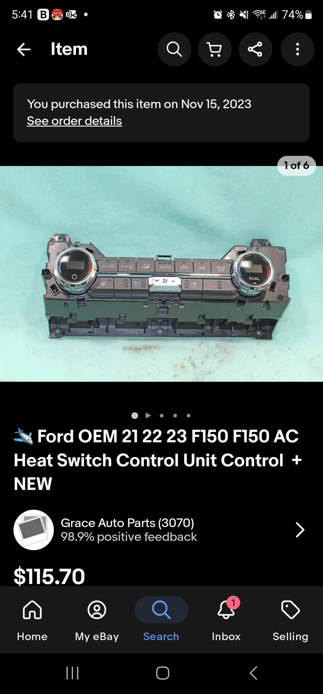

Maybe i made a bad product purchase of Ebay. Bought a new oem ACCM with the SWH button.
Had all yhe buttons and functions previously, including heated seats and cooled seats.
None of the seat climate controls work, the A/C button doesnt work.
I am new to forscan, running version 57 and have a 2023 Lariat 501a (My 23 according to Forscan)
Tried resetting the ACCM. Module doesnt come up under list to be able to write.
Wondering if I bought a bad unit or are my Forscan skills lacking
Ford F-150 New ACCM upgrade, no heating/cooling or A/C Screenshot_20231224_174107_eBay

Thats not the ACCM That is the HVAc only power boost has ACCM
