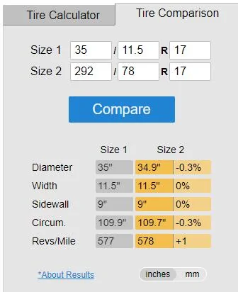

I believe you first need to find the metric equivelant to your standard tire size
https://tiresize.com/calculator/
Ford F-150 Need help with sparts tire size calculator. 1719321137448-h3

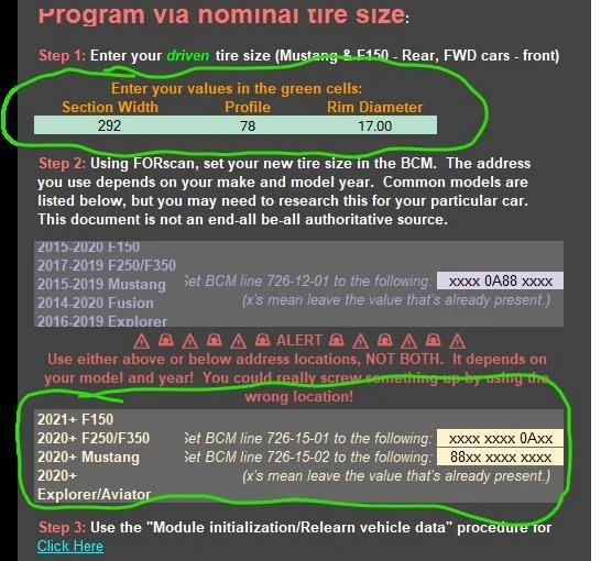

Then you put that into the sparts spreadsheet, which calculates the hexadecimal value to enter into the forscan lines.
Ford F-150 Need help with sparts tire size calculator. 1719321252438-fd
So here you would enter (ignoring any values at the x locations) changing existing values to the new values presented.
*BE SURE to save what your current values are, so you can go back if needs be.
BCM : 726-15-01 xxxx xxxx 0Axx
BCM: 726-15-02 88xx xxxx xxxx
Then go through the module relearn process and you should be good to go.
