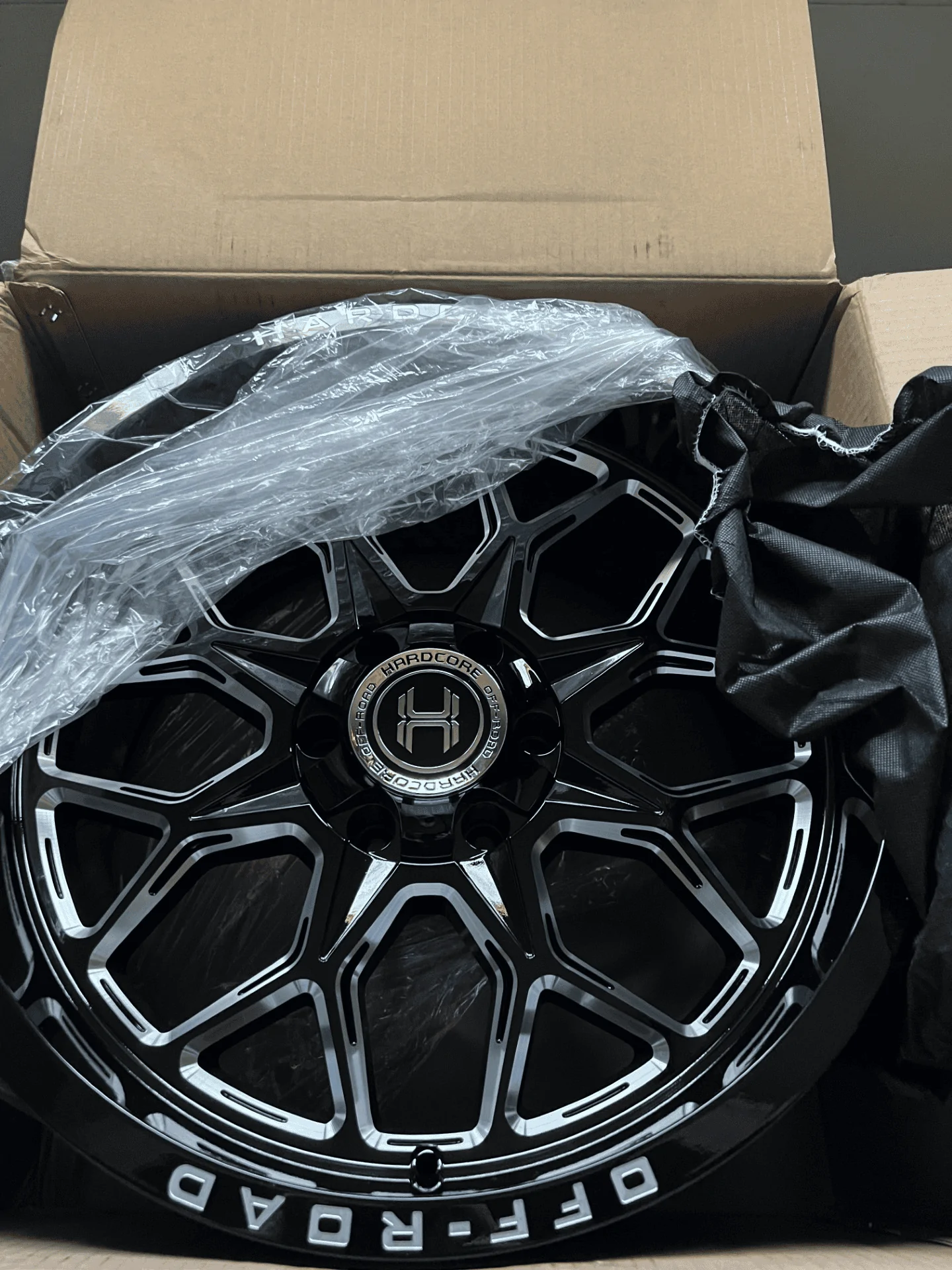

Plan is to do a 20x10 -19 .... i know i know...if i did a 20x9 with different offset id be ok .... with a 2.5 level. I ordered 33s but now im thinking about getting a 305/50 or 285/55 ????? I dont want to cut or trim anything to make them fit. I'd rather buy different tires or a bigger lift. Anyone running a 20x10 -19 with any of the tires sizes i listed?
Here's the wheel

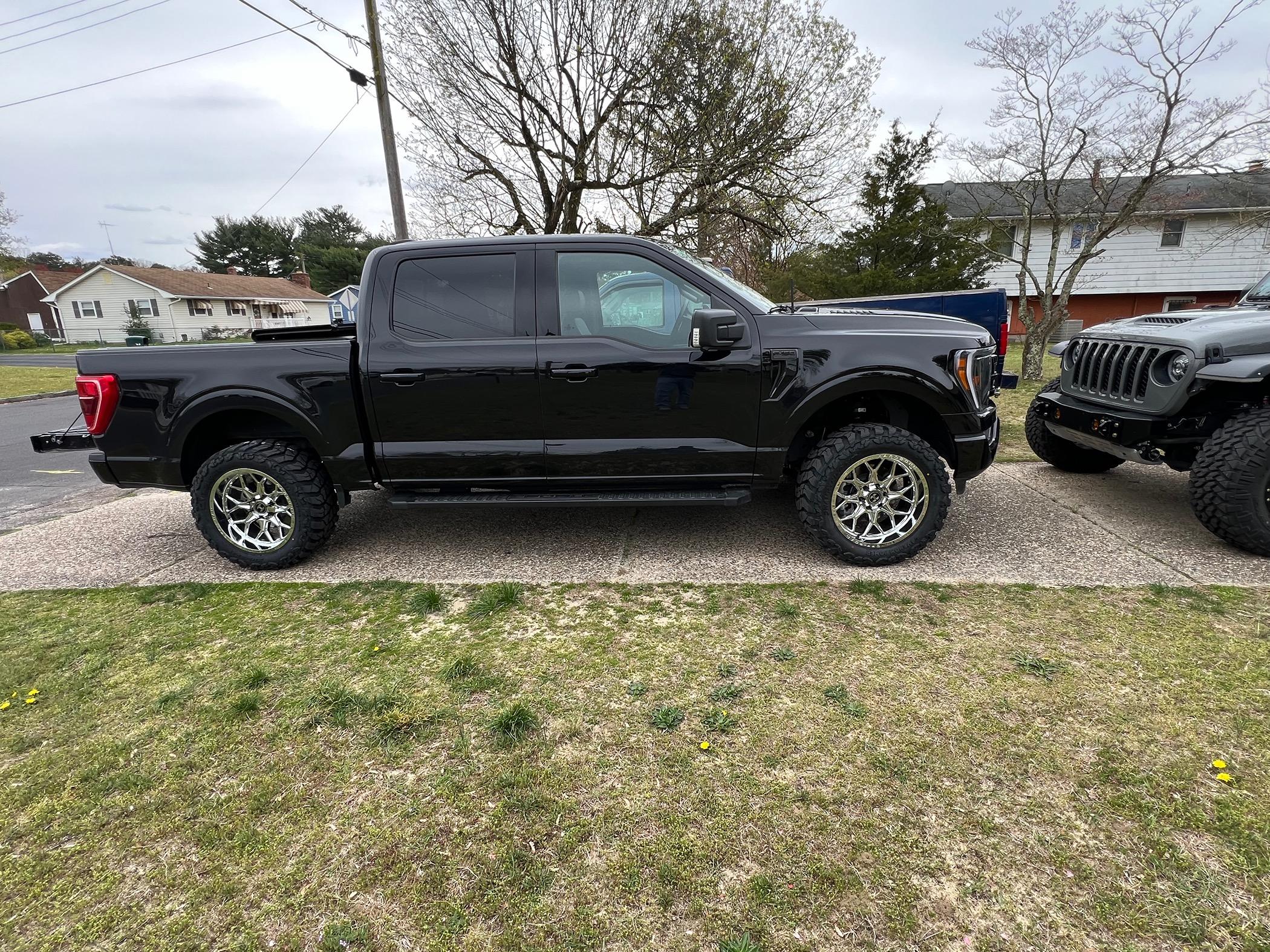

I was running 305/55R20 tires on 20x10 -19 wheels with a 4" BDS lift. I had to trim a little bit off the fixed air dam, but other than that there was zero rubbing.

Had to trim lower valance a tad bit…might just take it completely off. ZERO MODIFICATION TO CRASH BARS. Plenty of room between them.
