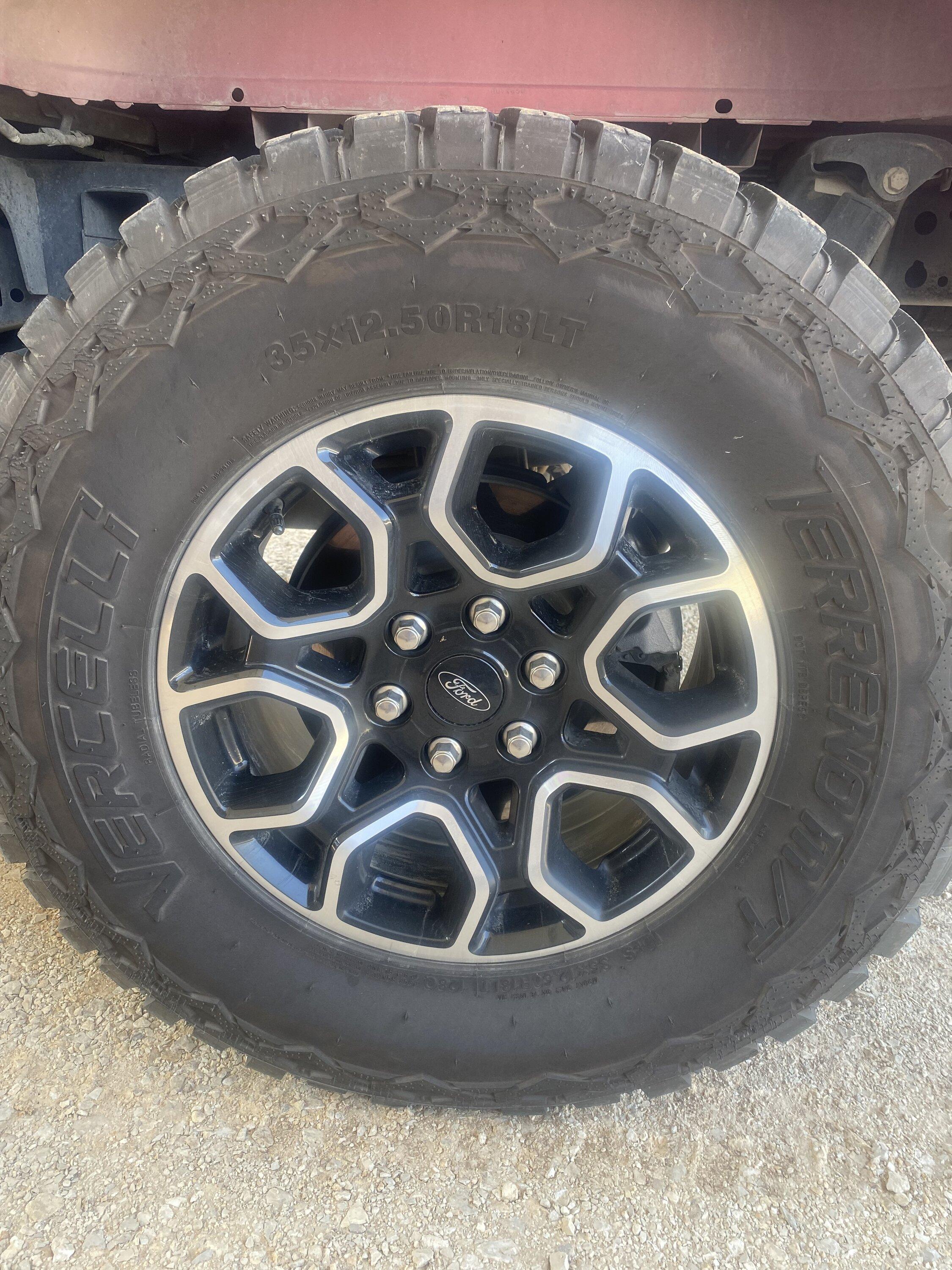

Hey gents, I am going to get tires this weekend and I’m conflicted between these two.
295/70R18 116S which weigh 52 pounds but there are SL rated or
LT295/70R18 E 129/126R which weigh 63.60.
I currently have 35×12.50R18LT F rated and weigh68.43. These tires are killing me on my mpg.

I this is what my truck use to have. I bought it used. The previous owner installed a 3 inch list and the dealer installed the 35’s
