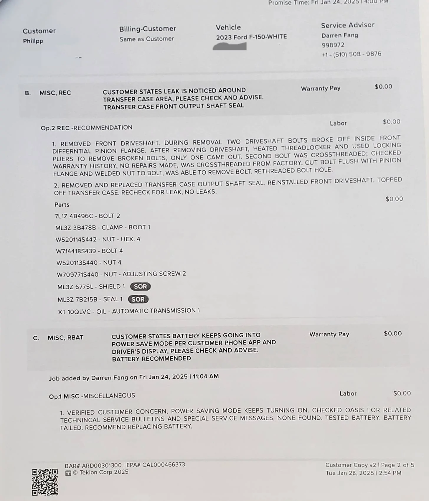

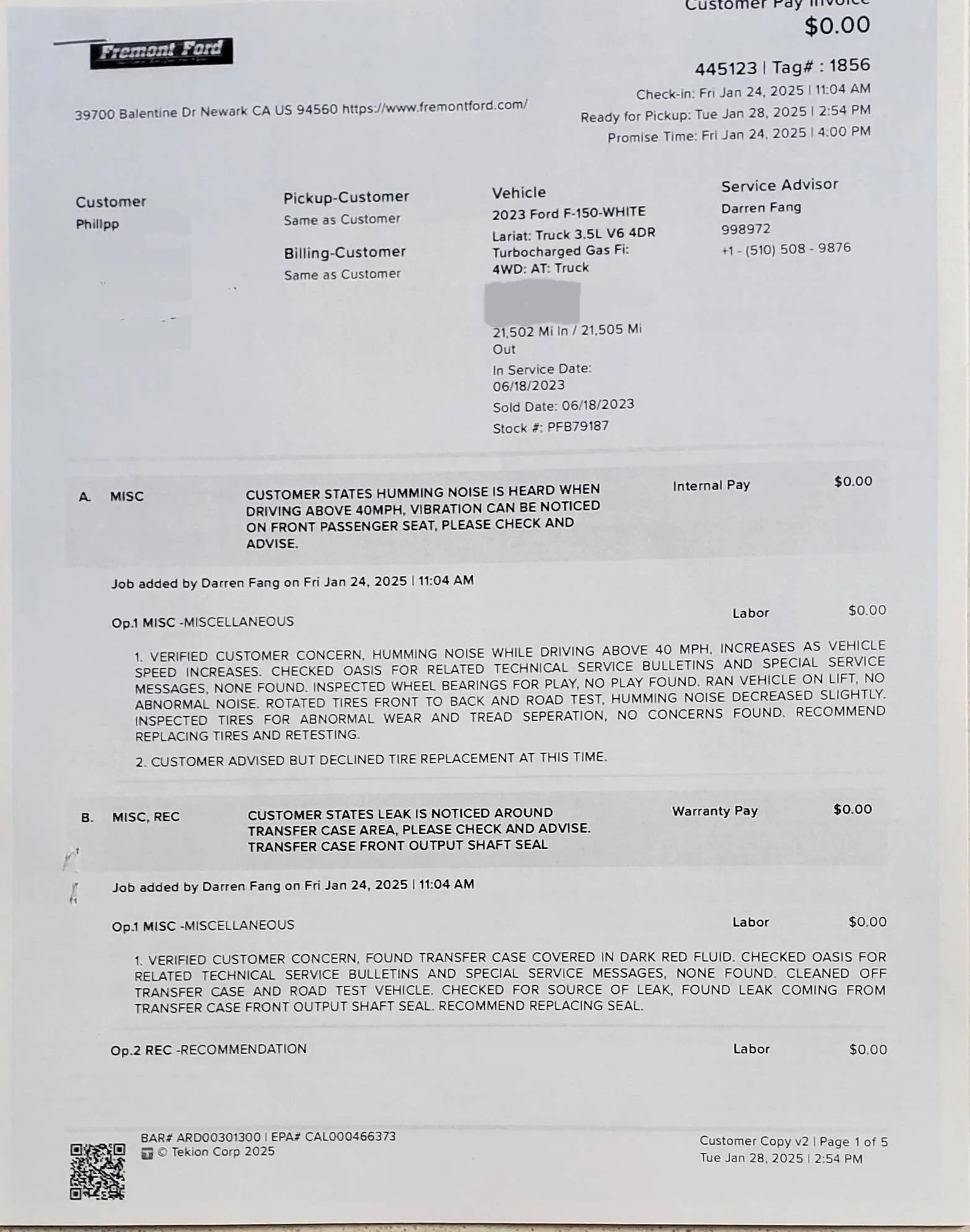

Hello all. I have a 2023 F150 Lariat SC FX4. I am in need of some advice. I brought my truck to the local dealer for some issues (transfer case seal leak, low battery and for a noisy front differential.) Two issues have been repaired however the front differential is still humming. Had a tech ride with me and verify the noise when I first brought the truck in. Originally I thought the wheel bearings were going bad or my hubs were sticking. The noise is still there whether I am in 2H, 4H or 4A. Long story short, the tech rotated my tires and "ran the truck on the lift and the noise decreased slightly." My question is how can they be sure the noise decreased slightly while the truck was not under a load? Would they be able to attach some chassis ears and try and pinpoint where the humming is coming from? The service advisor said the humming noise was coming from the tires however they did a check on my tires and found no abnormalities. Are Hankooks known for humming? The truck didn't make that noise before hitting 21k miles. I attached the work order. What should I do next? Sounds like I need to make sure my life insurance is paid up. Hahaha. My apologies for the long rant and thank you all in advance for your help.

With your front axle always live, it's pointing to a diff issue as previously mentioned and why 2H won't do you any good. There's no EIWEs (locking hubs) in your truck to turn off the front axle. We've seen spun carrier bearings in them so it's a possibility. At the very least get the tech to remove the front cover and inspect for FOD (though they might just suck some oil out). If the race is spinning there should be some glitter in the oil.
