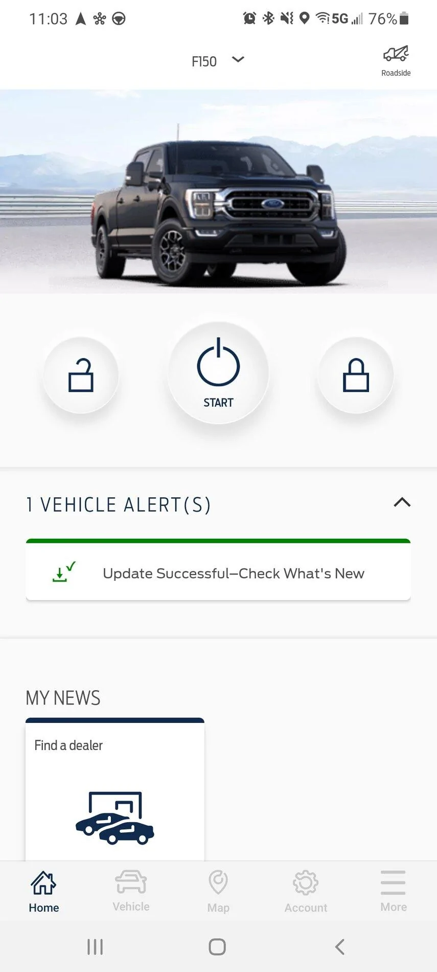

Mine was corrected via an OTA update a few weeks ago. Used to reset every cycle, now it hasn't reset once since. My truck said it got another OTA update today, not sure what it was for.
