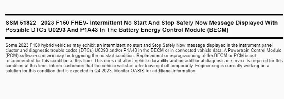

Saw this on another thread.
Would love to see this work for someone else. It's certainly easier to do than disconnect both batteries. (which I have never seen reported to NOT work)
Ford F-150 My first SSN Stop Safely Now tonight Screenshot_20230911_103418_Brav
Thanks for this. I will keep it in mind if it happens again. I presume this cables goes down to the hybrid battery in the trans...?
No sir. I don't think so because it's not an orange HV cable. There ARE 2 orange HV cables mounted to the top of the inverter though.
I believe the cable suggested is the "Control" cable for the inverter. The brains of that portion of the Hybrid system. Perhaps unplugging it is removing the low voltage power source to the module itself, which is basically rebooting it.
Or put another way, since disconnecting both batteries would do exactly the same thing to that inverter, and if it IS rebooting the inverter that clears the random issue, then unplugging that inverter cable is just a quicker way to achieve the solution.
