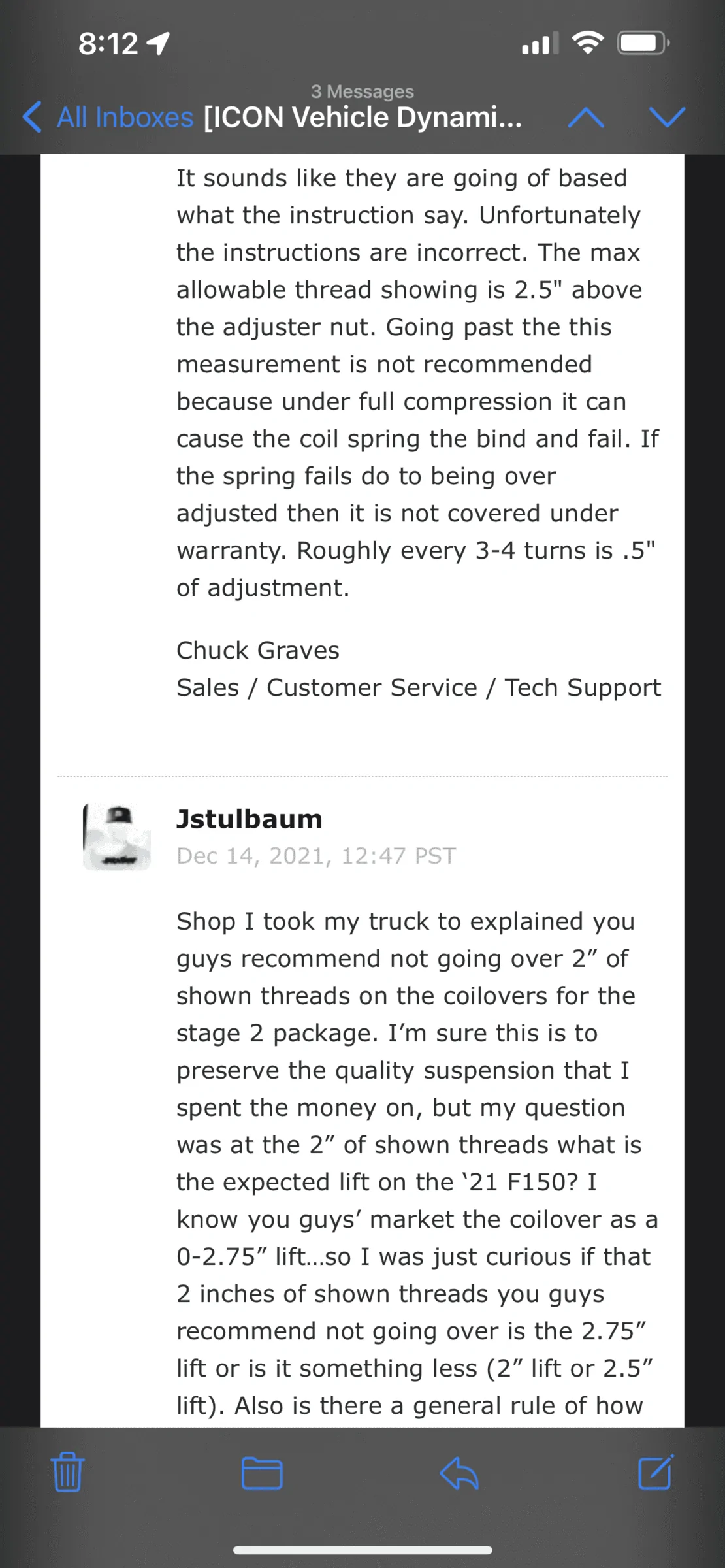

Had me a little nervous with the full lock rub with the 285/75/17s then I saw yours is 2WD…what motor? And what kind of lift do you have in the front at that point? Wanted pro truck lift way before I bought the truck, and then saw you guys didn’t approve them on your 21s. So then I had your stage 2 coilover kit on preorder to ship around the 19th, but got impatient and saw the Icons stage 2 pkg came in stock. Bought those mainly because I was gonna get UCAs in the kit. Truck is 21 XLT 3.5eco with trailer tow pkg and FX4. Ended up going with 285/70/17 and I am regretting it (just seems too small for my liking). Now debating on 285/75/17 or 305/70/17. My rake is currently 0.5” taller in the rear so I believe I have my coilovers at around 2.5” level. The icons recommend a max 2” shown thread adjustment, but I don’t know what that translates to in actual lift.

After speaking with Icon the max thread setting on their instructions are incorrect. The max thread showing setting is actually 2.5” to give you lift of 2.75”. They come in the box at 0.8” of threads showing which equates to 1.75” of lift. I’m currently set at 2” of shown threads which is around 2.125” of lift. No wonder my 35s wouldn’t fit SMH.

I just put these on my 2021 Plat FX4 and put fox 2.5s in the rear. Had a lot of squeaking at first from either the tubular UCAs or the springs. Went back to the shop and raised the lift another 1/2” plus lubed the s$&@ out of the UCA bushings and delta joint. The extra grease didn’t get rid of the horrible noise but lifting it eliminated every drop of noise. I still have another 1/4” to go until I have 2” of threads showing which is what Icon told me was the max. I’d like to go a little more. After reading this I am going to call again on Monday and double check with them. The ride is awesome. Takes everything I give it with a smile and ease. The handling is improved as well. I’ll update after I talk with icon and adjust more.

Yeah looks like they just have instructions that need to be updated. Basically if you go past the 2.5" of threads showing the spring can block out and break. Many manufactures provide additional threads on coilovers in case you want to change spring rates for additional weight but you always have to make sure you aren't blocking out the springs.

I sent them an email as well so I have something in writing just in case there is a problem later on and they say it's not covered under warranty because I exceeded 2". Then I called them on the phone to verify for myself. Justin from Icon did confirm that there is a typo and I showed him where it is on the instructions. He said that for the 4WD version the max exposed thread is 2.5" not the 2" printed on the sheet. For the 2WD version it is only 2". When I called in before putting them on to verify the same info I was also told 2". Justin said they must have been looking at the 2WD and not the 4WD and he again confirmed the 2.5". I bought one of the Icon spanner wrenches. They don't have good reviews so I will be gentle LOL. Time to give a little more lift.
