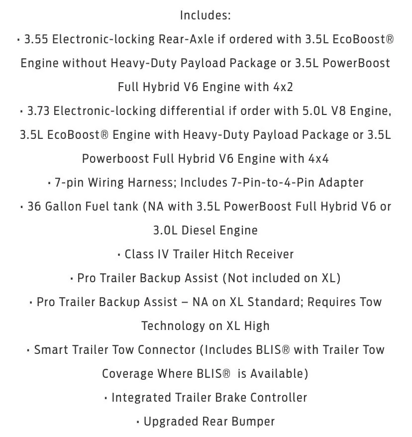

Ford F-150 MTP hitch rating??? 3133A876-5D94-4A40-920C-A8312381D88F
- Class IV Trailer Hitch Receiver
- Upgraded Rear Bumper
This is what the B&P shows for what’s included in Max Tow.

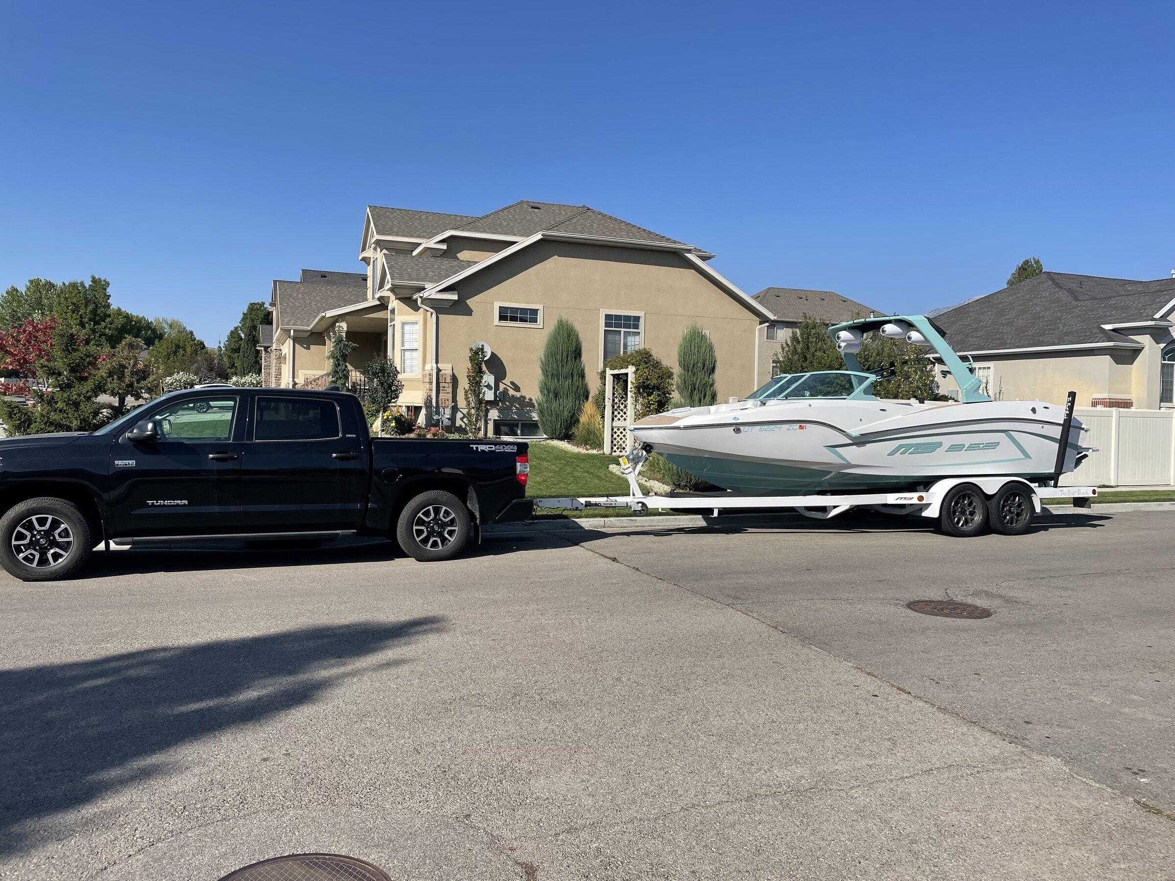

I tow a wakeboat, not a travel trailer. Like the vast majority of boat trailers, mine utilizes a single tongue with surge brakes (not electric over hydraulic). In addition, most boat trailers have a foldable tongue. You just can't really use a WDH with virtually any boat trailer. My boat is about 8000 pounds at its heaviest and usually more like 7700 pounds.
My boat has about 700 pounds of tongue weight and obviously incurs far less drag whilst towing. It just sucks that my 2020 Tundra can legally handle my boat (higher hitch rating), while the Ford can't.
