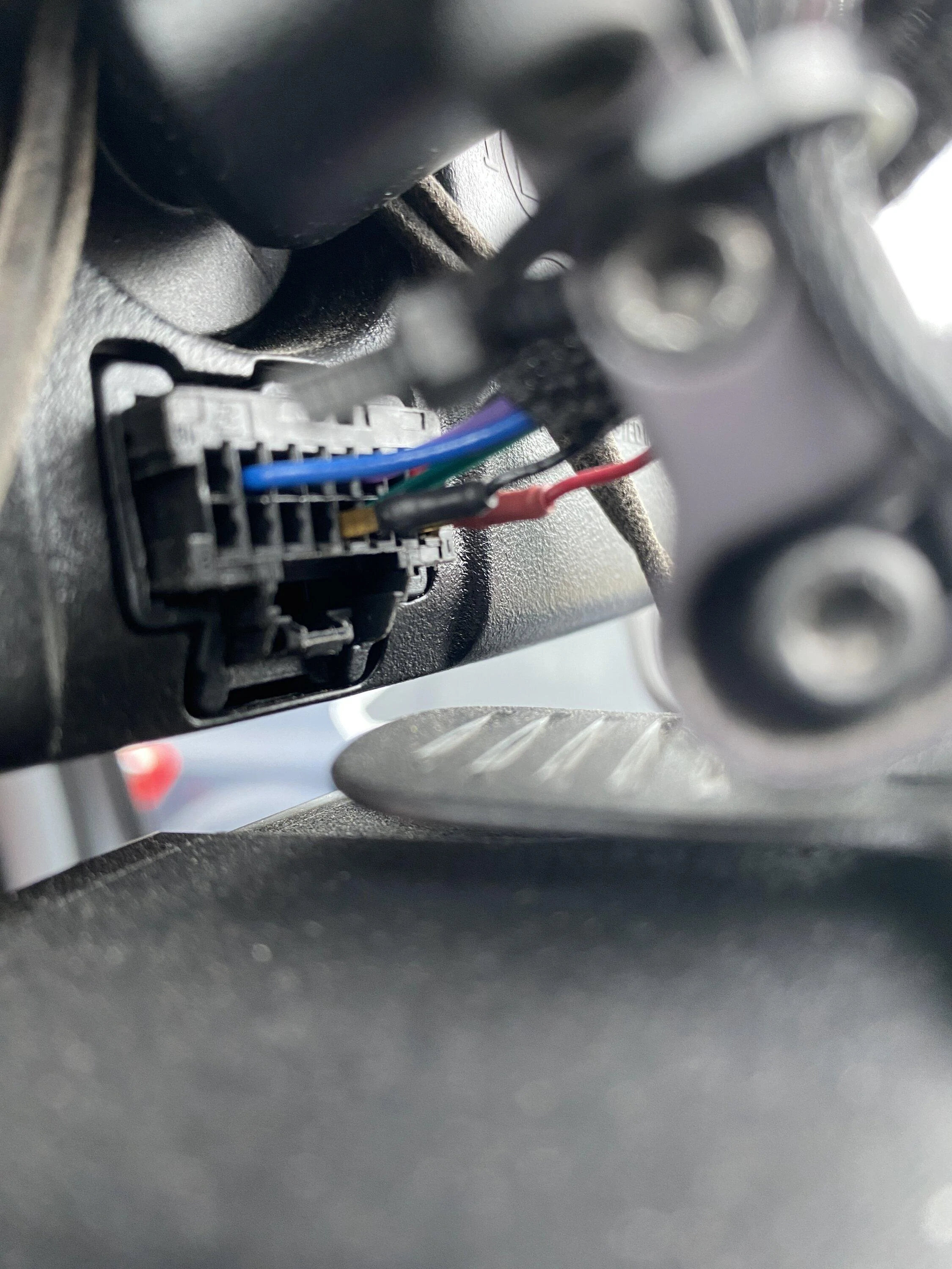

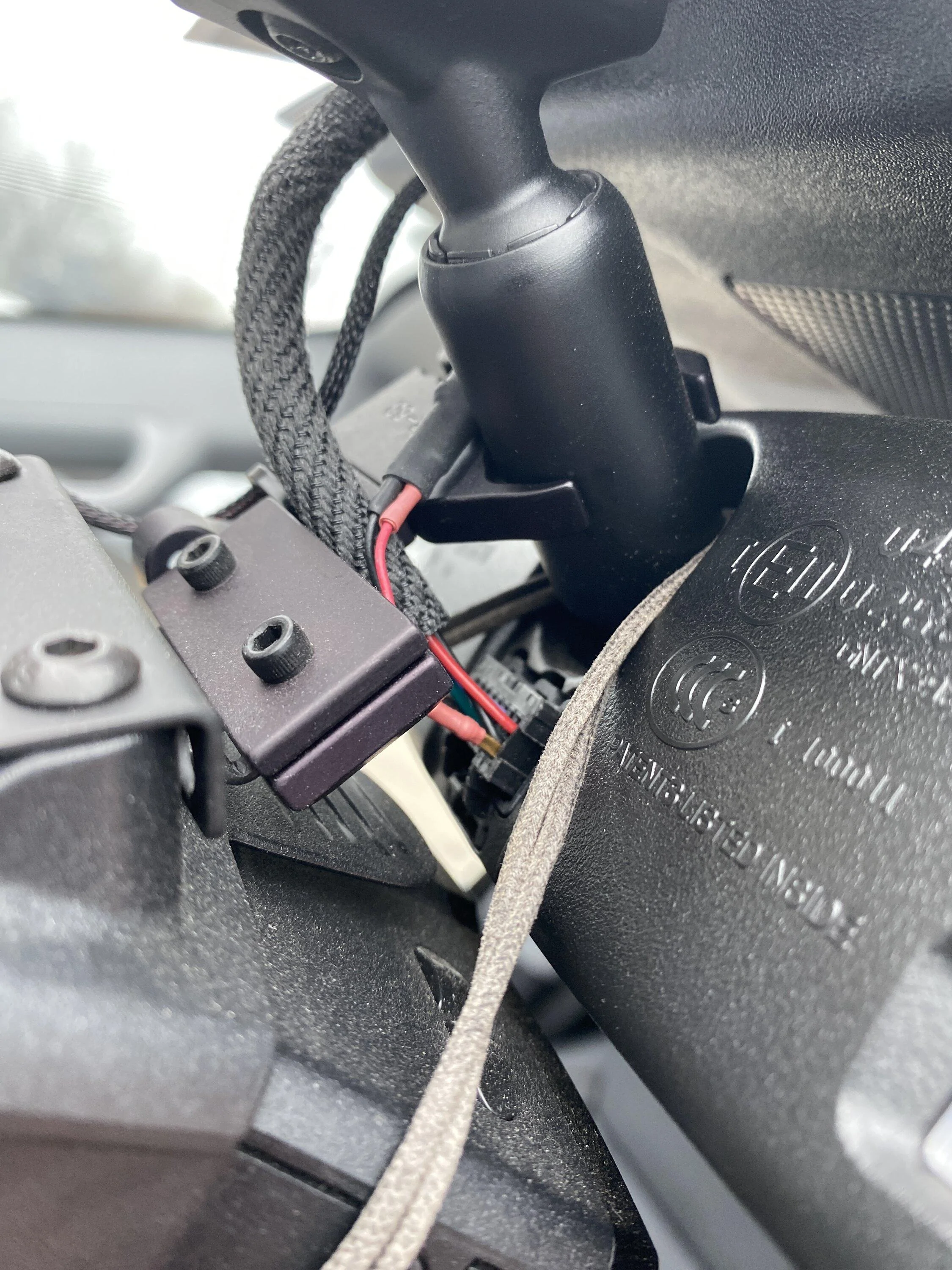

These are the pins that worked for me. I tested with a volt meter before install.
Ford F-150 Mirror tap for radar detector IMG_1790
Ford F-150 Mirror tap for radar detector IMG_1791

On my mirror (2019) Black was HOT and Blue was the ground!!
