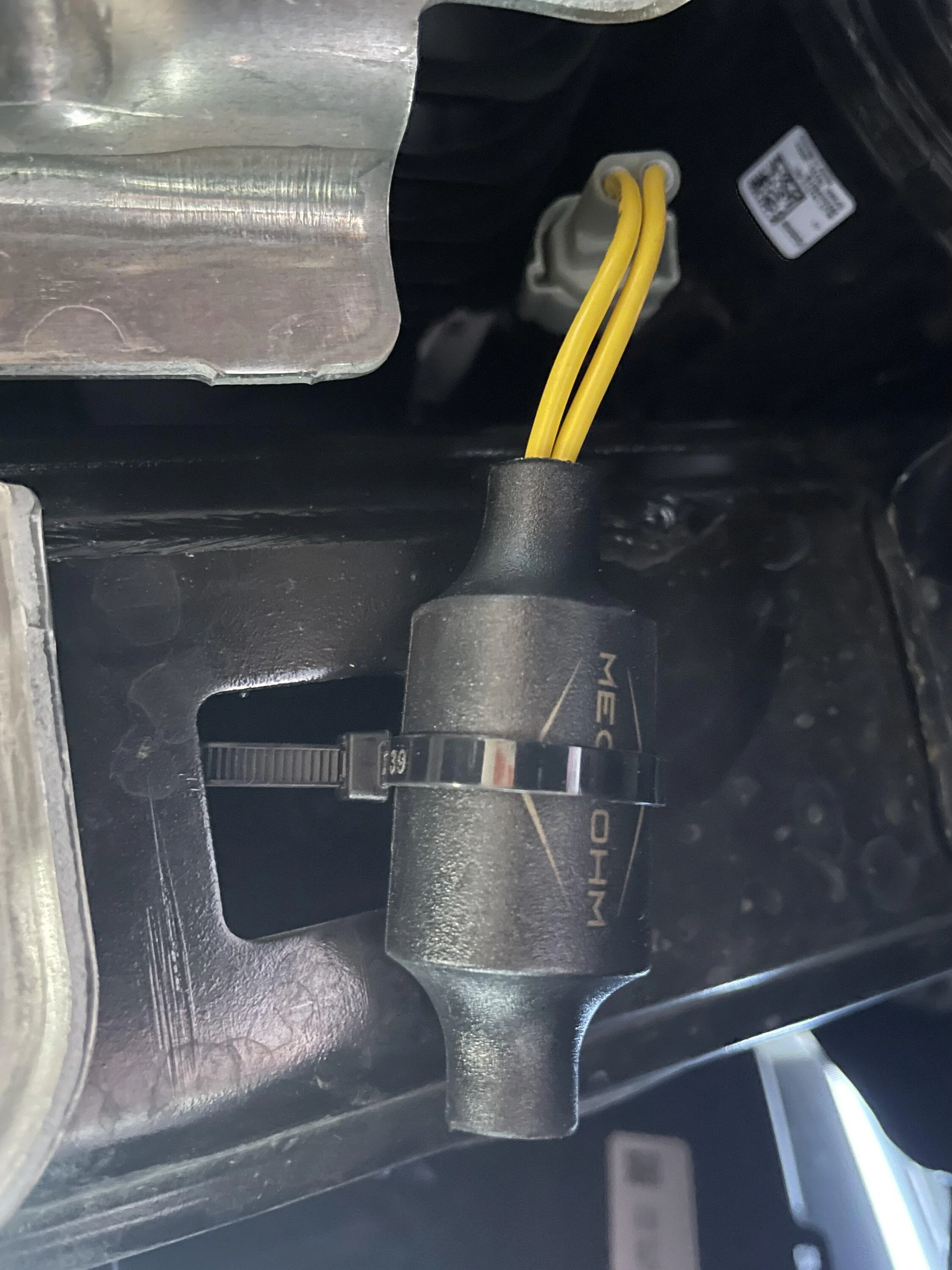

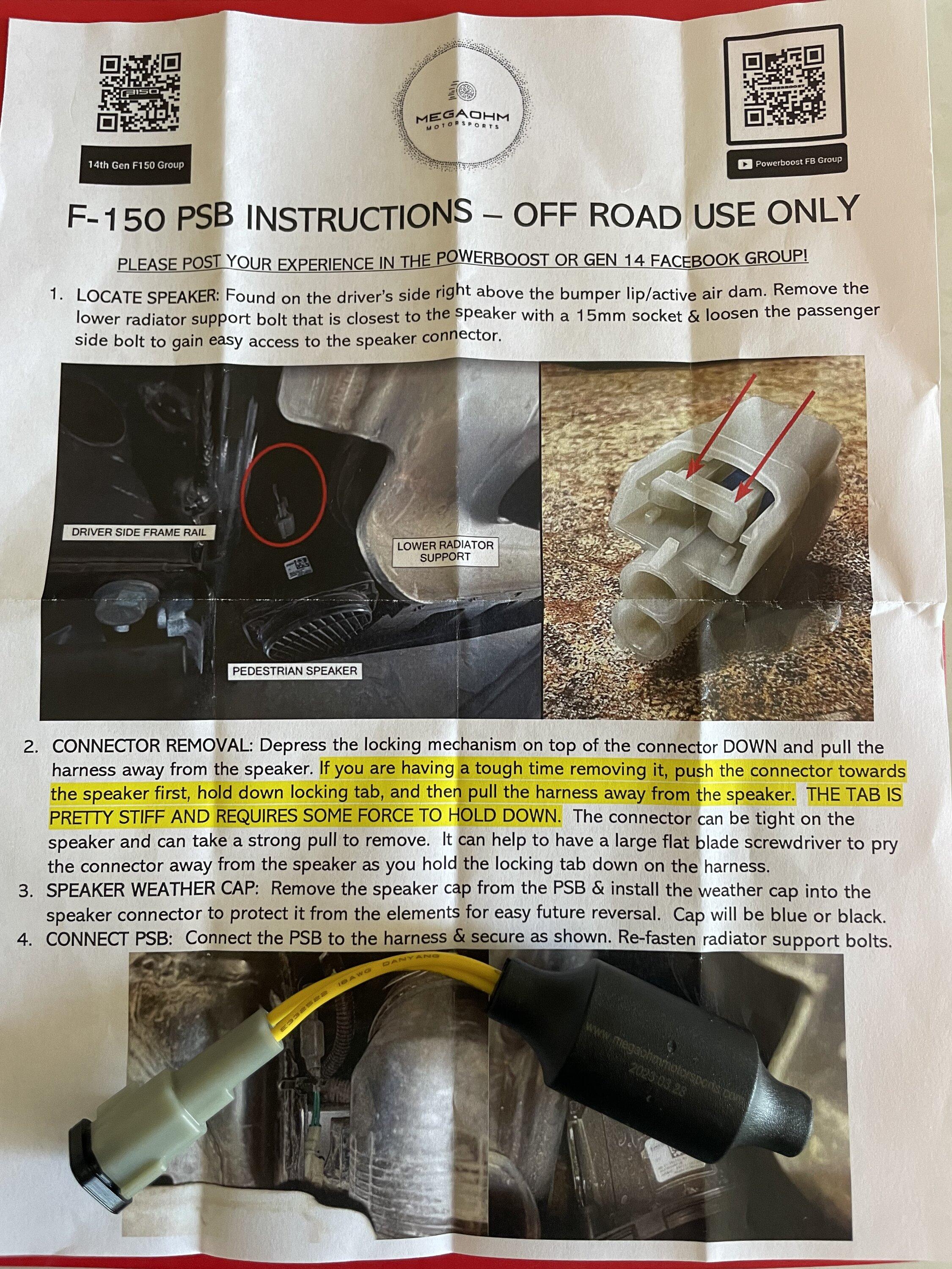

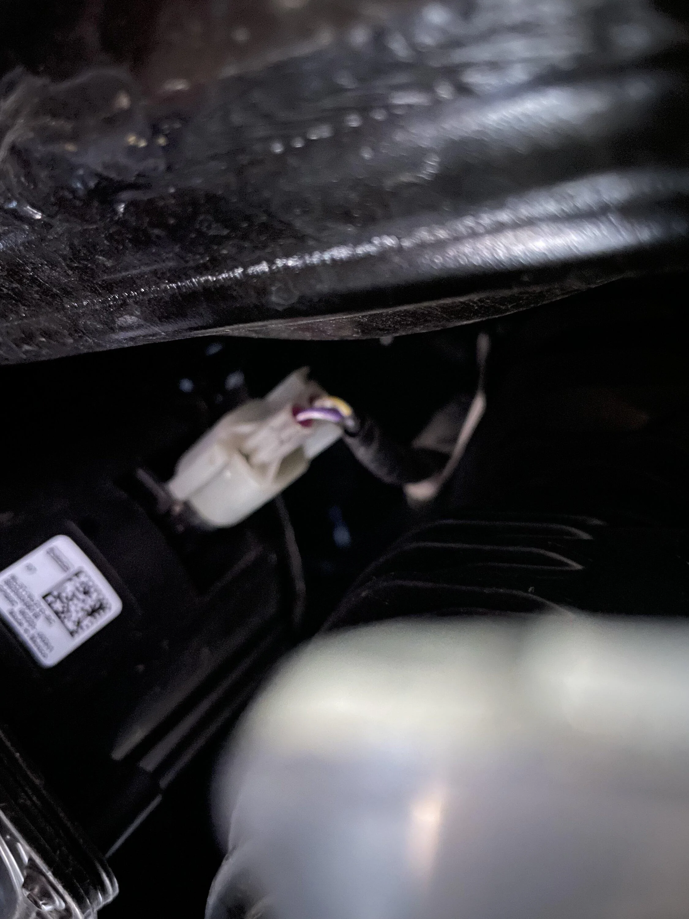

I installed the backup alarm delete from MegaOhm Motorsports to my 2023 F150 Powerboost. It is great! No more annoying back up alarm or sound when in electric drive moving forward. It was very easy to install you will be finished in 5-10 minutes. Also no check engine lights on the dash. 100% plug and play no need for ForScan programming.

That's a good looking install right there! Enjoy the silence and thanks for the review
