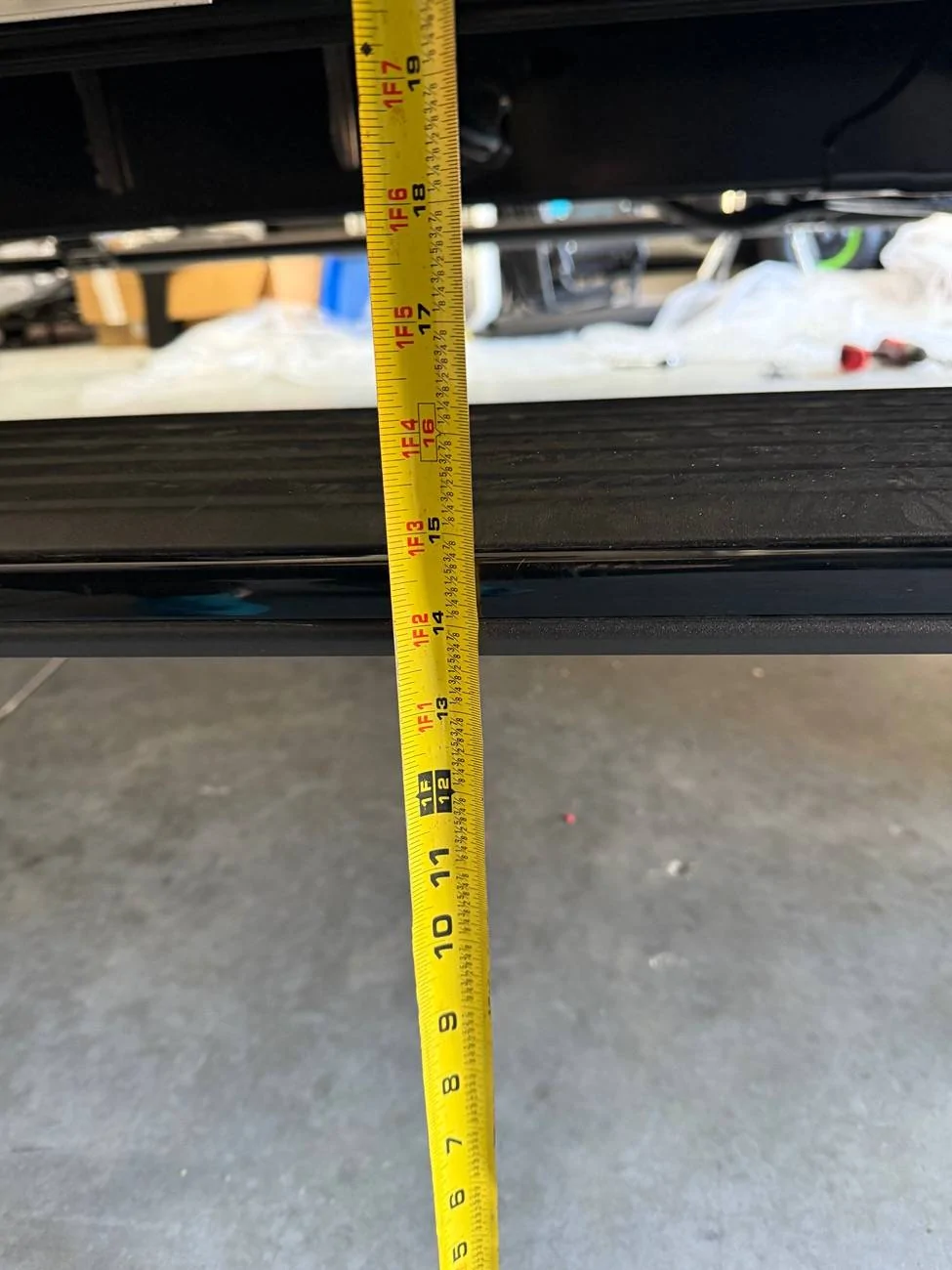

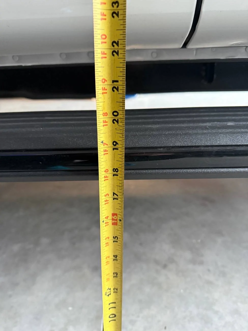

I will send pics next week. I have a 4” BDS lift on my 2025 powerboost. Combination of F250 parts and F150.
works great.
Pre lift height to running boards was 15”. Post lift is about 14.5”
