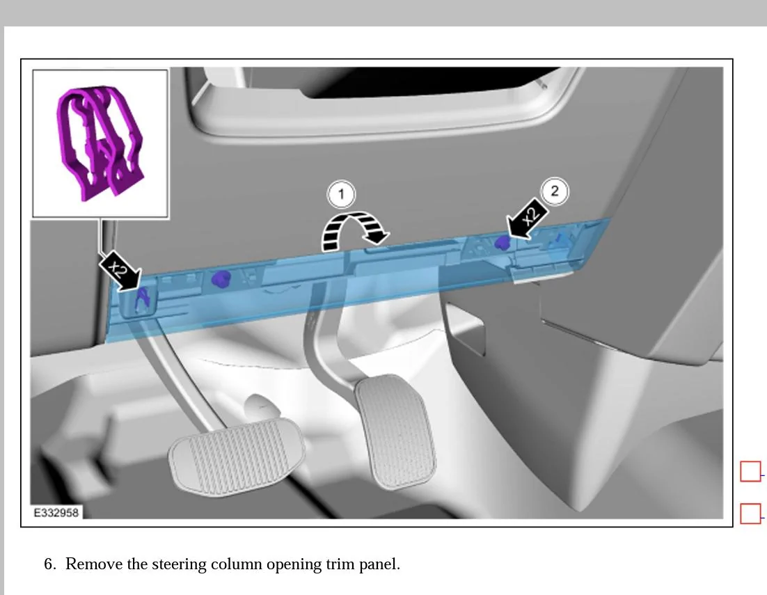

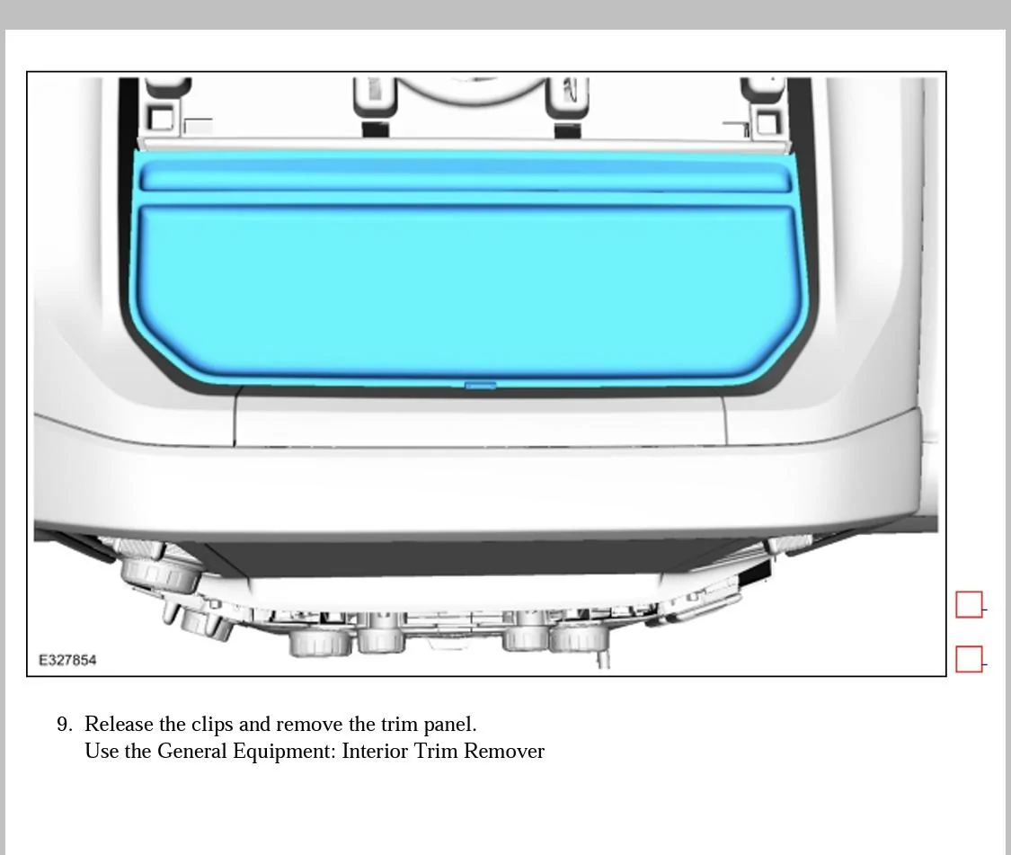

Does anyone know if the dash panel bellow the steering wheel just pulls down from the top and is hinged like it was in the older models? I want to add some switches in it adjacent to factory switches and just want to be sure how to access before I started pulling.

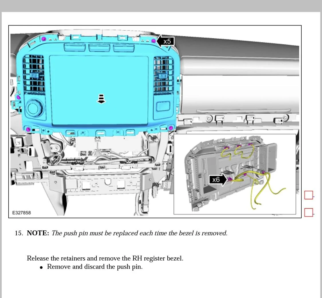

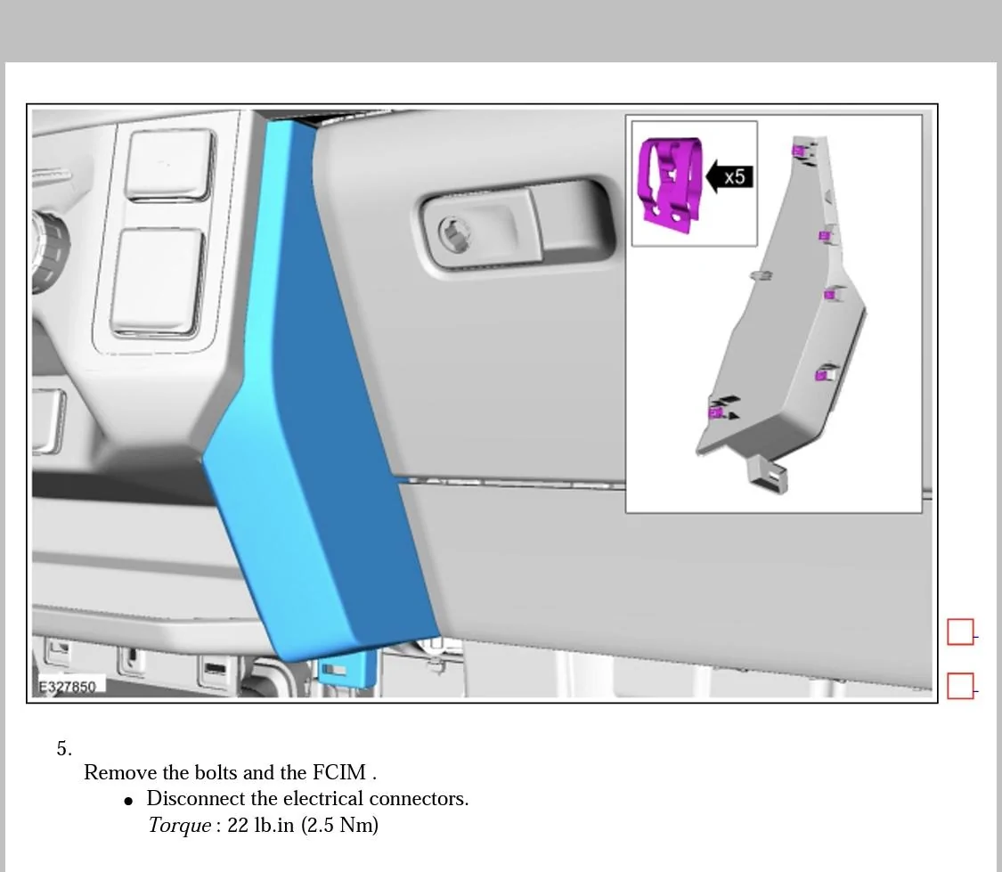

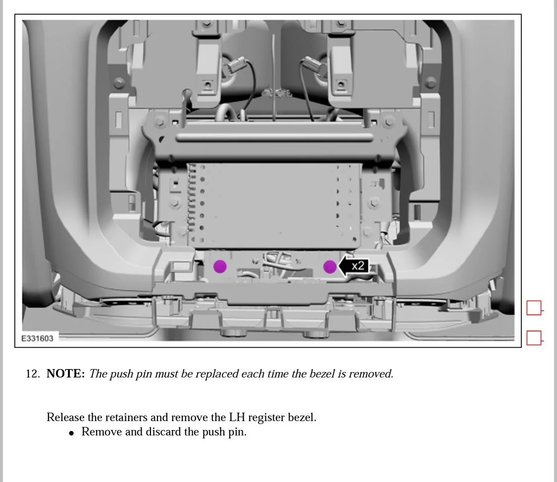

Awesome! Thank you! Do you have the diagram for the panel directly to the left by chance?
That part to the left that has the headlight switches is part of the whole instrument panel. You can pull off the side piece and then pop out the headlight switches etc. if you just need clearance or to see what you are doing.

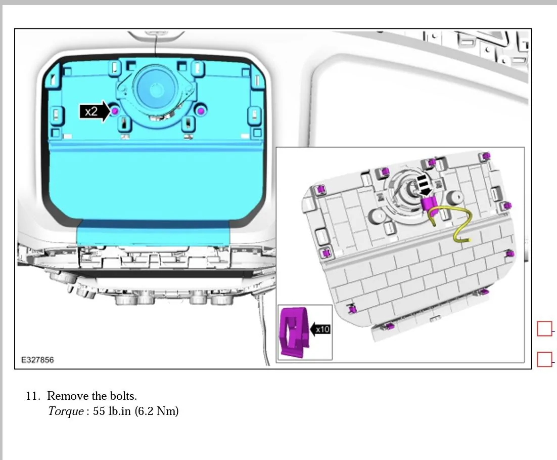

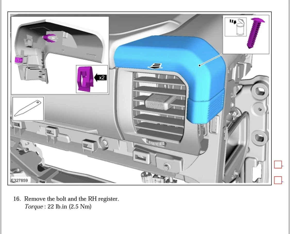

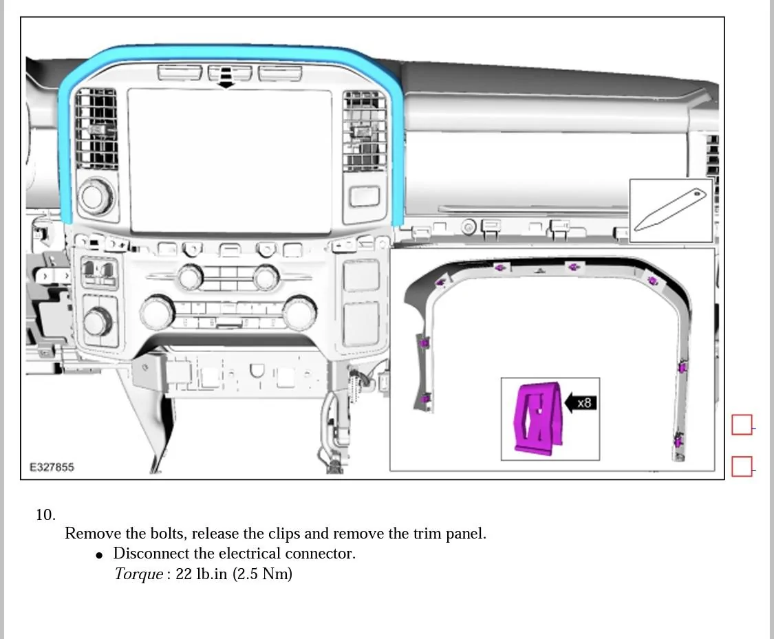

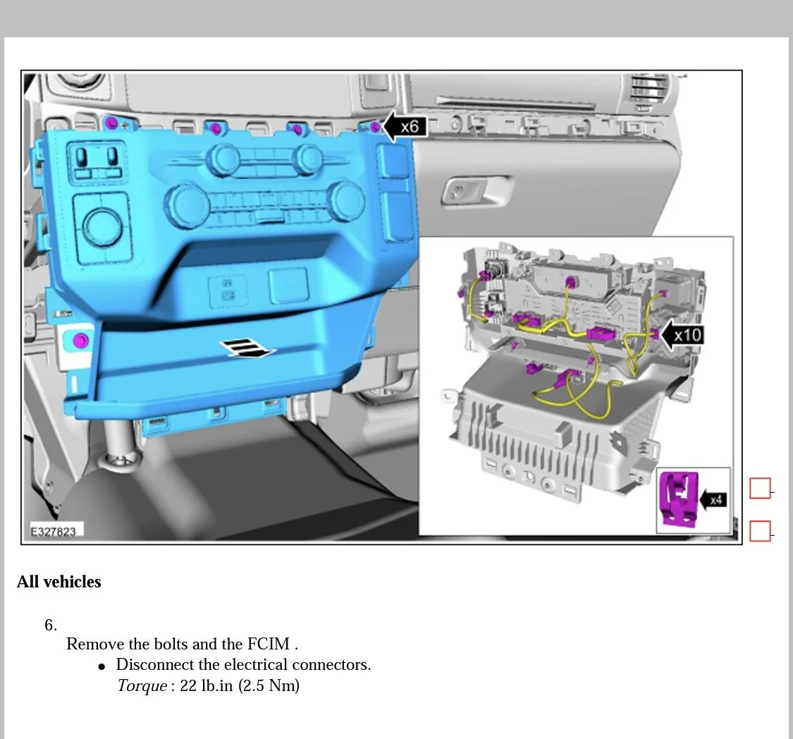

Think you can post diagrams for the upper dash, instrument main panel?
Is there specific part/section (airbag side, cluster, radio) you are looking for? The upper IP is about 30 pages long.
