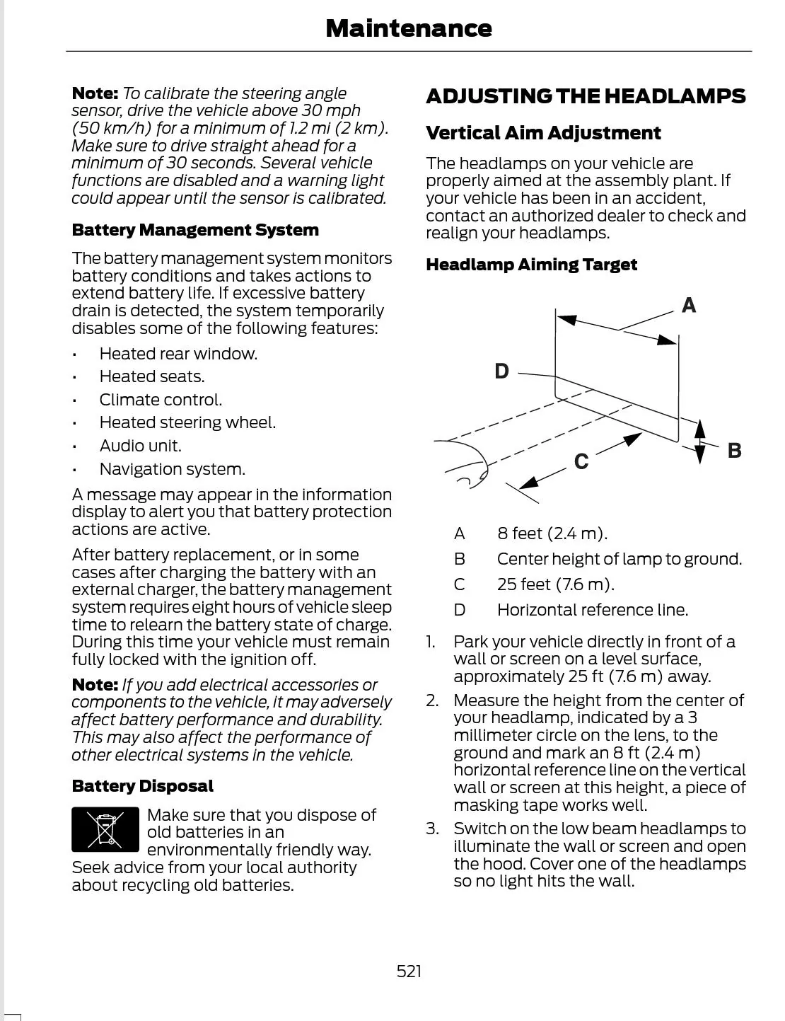

This may be long winded but please bear with me... Truck is a 502A Lariat as per my signature (so full LED lights)
Had my truck for about 2 months now and everything so far (knock on wood) has been perfect...outside of the headlights. I had a 2" level installed by the dealership at delivery and they re-aimed the headlights. Immediately that night I noticed they certainly did not as they were pointing to the sky. Went back again and they assured me they were correct now. Lights seems much better but I am constantly being flashed by oncoming drivers, so they must be out of whack still.
I did the self-aim process and the lights 'seem' to be pointing where they should be (measure from ground to headlight dot, put tape on wall 30' away at same height, re-aim).
On top of this issue, my auto high beams have NEVER turned on for me. I live in the country and do a lot of highway and back road driving with zero traffic. Yes the switch is set to 'Auto' and I have glare-free turned on in the settings. I can manually turn them on no problem with the stalk but that isn't the point...aren't they supposed to turn on by themselves if nobody is around?
I'm kind of at all loss here as taking it to the dealer again doesn't seem like it will get me anywhere.
Any thoughts or suggestions on either of these issues would be greatly appreciated!
I believe the measure and transfer to the wall assumes a factory height. You took your “lifted” height and used that as a reference. Maybe get a measurement from someone that doesn’t have a level or subtract the height you added and go from there.
The auto high beams do not have an “auto” mode. They are either on or off. “Auto high beam” and “glare free” are different things.
