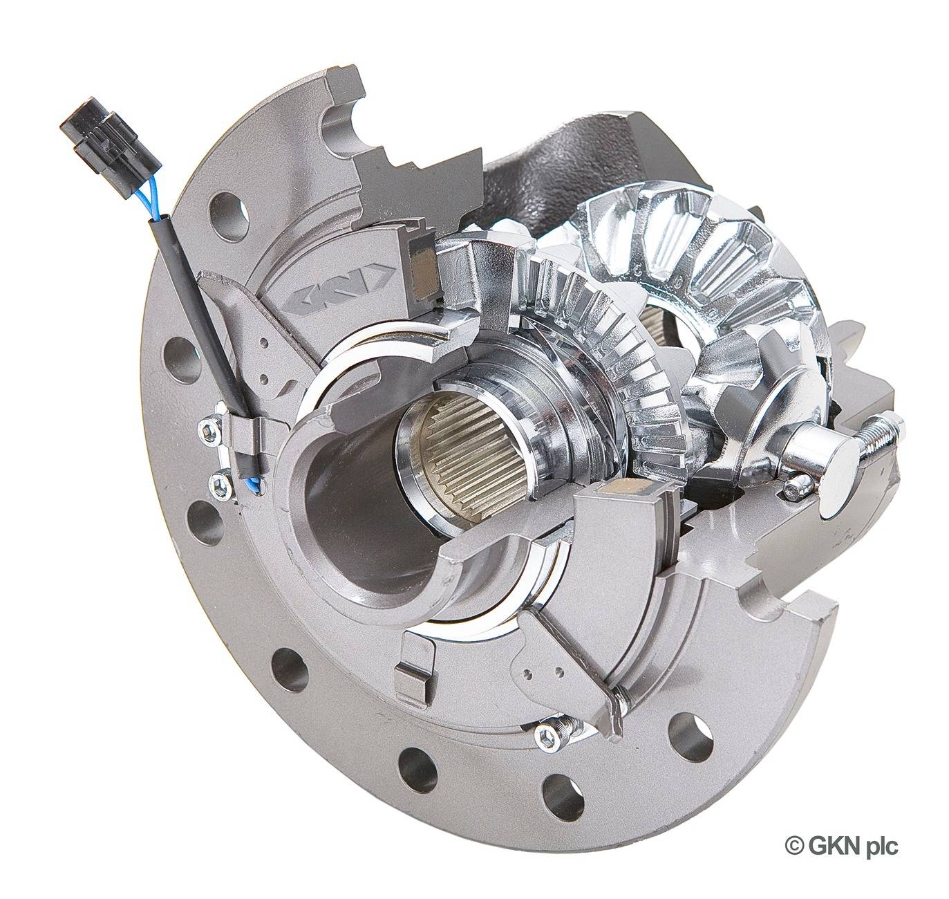

Well, not exactly 100%, it depends on the selected drive mode ....
The attached may be of interest, describes in detail the operation of the E-locker differential (ELD). The ELD operation is the same for both 8.8 and 9.75 ring gears, semi-floating and 3/4-floating axles.
As you read this, note that with the XL trim you will have the ESOF 4WD system, not the TOD (TOD is only on Lariat and higher trims).
May not describe what you would like, but it is what it is, hope the explanation helps. :)

So, as you see on the ELD Engagement/Disengagement Speeds and Availability table in that section from the Workshop Manual, ELD does not 'automatically engage' when in Normal. Eco, Sport, Slippery, or Tow/Haul modes.
IF manually engaged below 20MPH in any of those drive modes it will automatically disengage when you cross the 25MPH automatic disengagement speed threshold and will automatically re-engage when you slow to 20MPH.
IIRC you will have to re-select drive modes and ELD engagement if you turn the key off.

Your E-locker only locks if you engage it with the center button in the drive mode selector and it will then show up on the screen, Can be locked in both 2 wheel and 4 wheel drive and only recommended to do so on loose or slippery surfaces. It also will auto disengage at speeds over 20mph.
The kicker is today's traction control will slow the spinning wheel thus the wheel with the most traction will have more torque applied to it. Same is true while in 4 wheel drive.
Turn off the traction control with 2 pushes find a safe area with a loose surface area and go balls to the walls and only 1 rear wheel will spin. Engage your E-locker and retry now both rear wheels will spin.
