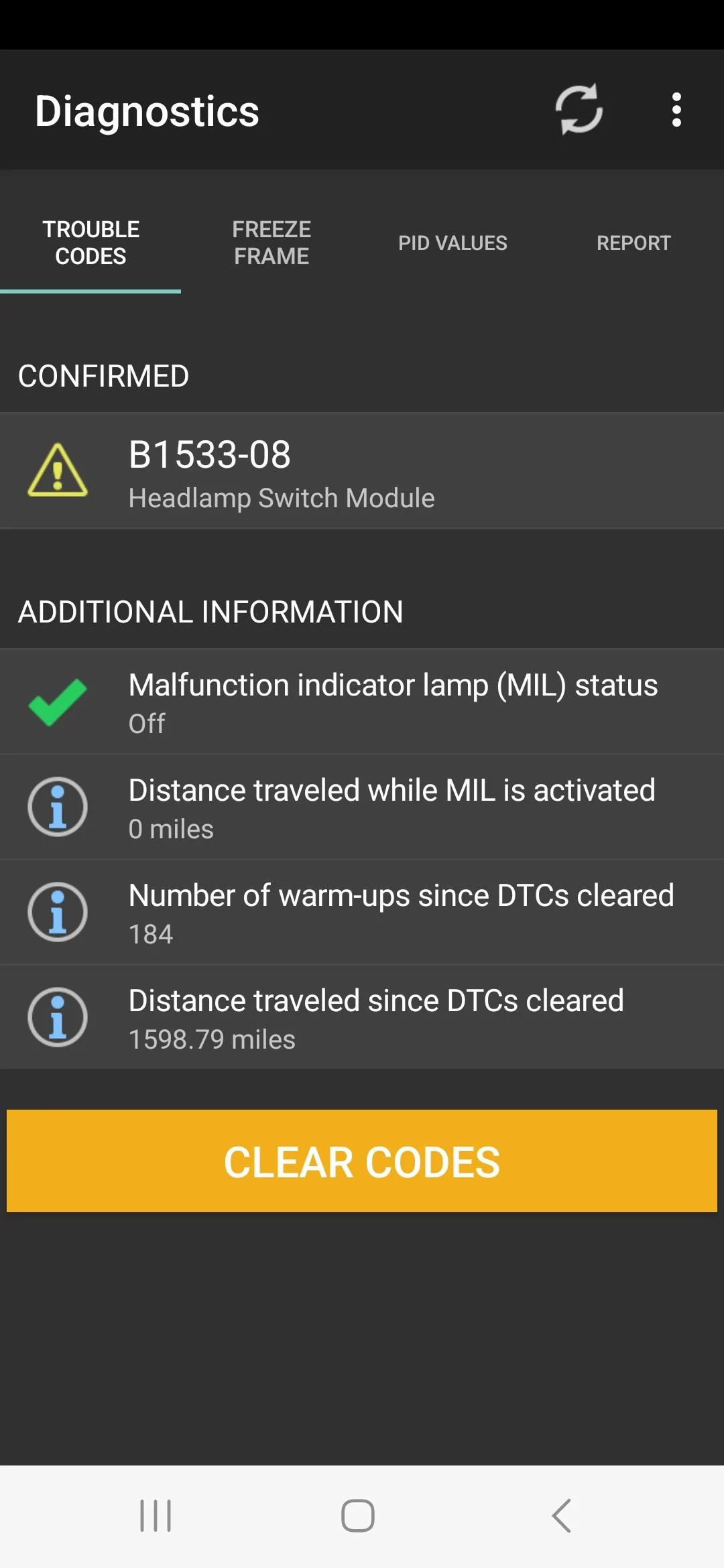

Yes, there is a tsb regarding this problem. There is,a logic error in one of the chips in the headlight switch. Updates and software will not correct the issue. Ford has said an updated replacement switch will be available to correct the issue in January of 2023. But at this point I'm not sure if it's available at dealers yet. I'm waiting for this as well. And the error will throw a dtc in the body control module. You can check with an enhanced scan tool. Do not clear it. This will get you a new switch under warranty.
Ford F-150 Lights Turning on While Parked NOT Running Screenshot_20230211_124236

SSM 51244 2021-2022 F-150 - Headlamps Turn On By Themselves When Vehicle Is Off - DTC B1533 Some 2021-2022 F-150 vehicles may exhibit a condition of intermittent headlamp operation while the vehicle is OFF and have diagnostic trouble code (DTC) B1533 stored in the body control module (BCM). This may be due to the internal logic within the headlamp switch. Switch and/or module replacement will not resolve this condition. Headlamp operation is not affected while the vehicle is ON. A new headlamp switch is currently under development to correct this condition. Let the customer know they can continue to drive the vehicle and schedule a follow-up appointment in January 2023, when parts are expected to become available. Follow up with the customer to confirm the appointment once OASIS is updated with the repair information.

Thanks! I have seen that dtc with my OBDlink mx+ in the past.
