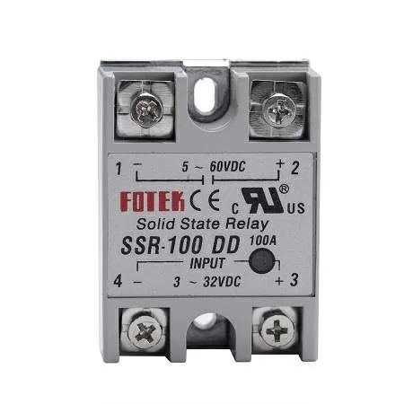

I’m familiar with relays and have used them in the past to do the same thing. Do you have LED headlights? I heard it doesn’t work with the LED headlights.
No I don't but I can't imagine why it wouldn't work. You might need to use solid state relay though.
I'm not an electronics engineer but I have had to use Solid State Relays for projects in the past. I went to the surplus store, bought a bag of various 12v relays and wired them until I found one that worked. It turned out to be a Solid State. It worked when none of the others would…
Maybe someone here can tell us “why”.
In the project I'm speaking of, I used the Solid State relay to trigger the Bosch relay. That was 10+ years ago and it's still working today.
I might have something to do with isolating the relay circuit from your "triggering" (high beam) circuit.
