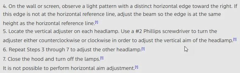

Just because you have autolevel doenst mean they dont need to be adjusted. Mine have the auto level and i'll tell you with 1000% confidence after the Ford Performance Set up was installed, they indeed were aimed high and needed to be lowered downward.
as i mentioned above, i got flashed a bunch and i found mine were way off. ever since i've adjusted them though i havent had much of an issue.
Again, thats false information. they will indeed most likely need to be adjusted.
this is what you need to do to be certain you're lights are correct. again, i know many have had to adjust their "auto leveling" headlights, me included.
I just pulled this straight from the owners manual.
Maintenance - Adjusting the Headlamps - Vehicles With: LED Headlamps
Maybe so for your truck, but I can say with 1000% confidence that mine did not need to be adjusted at all after my 2.5” level. Never ever get flashed on low beams, high beams are aimed perfectly and not aimed up at the sky. That’s the whole point of the dynamic bending. If you’re towing a heavy load, the UCA would be in an elevated position (nose high) just like putting a leveling kit on. Sure, if you put a 6” lift on, I’m sure they don’t have that degree of adjustability and would probably require a relocation bracket.

i thought the same thing...i have auto level on my truck but i was wrong. i set my FP to 2.5" and i constantly got flashed. when i started the truck it did the same ol song and dance. It wasnt until i parked 25' away, measured my headlights and put tape on the wall i noticed that my beams were in fact aimed slightly up. ever since i adjusted mine i havent had an issue.

Auto leveling headlights or not, it's always a good idea to check the headlight alignment after raising or lowering a vehicle. All you need is a tape measurer, painter's tape, and a screwdriver.
I checked mine after raising my truck just over 2 inches and I had to adjust them down quite a bit. Granted, no one ever flashed me but per the manual they were off quite a bit after suspension mods.
On another note my fog lights were pretty much pointed straight down to the ground from the factory. After adjusting those it's amazing how much light they provide when properly adjusted. Seeing how bad mine were, I'd advise everyone to check theirs, even on a stock truck.
