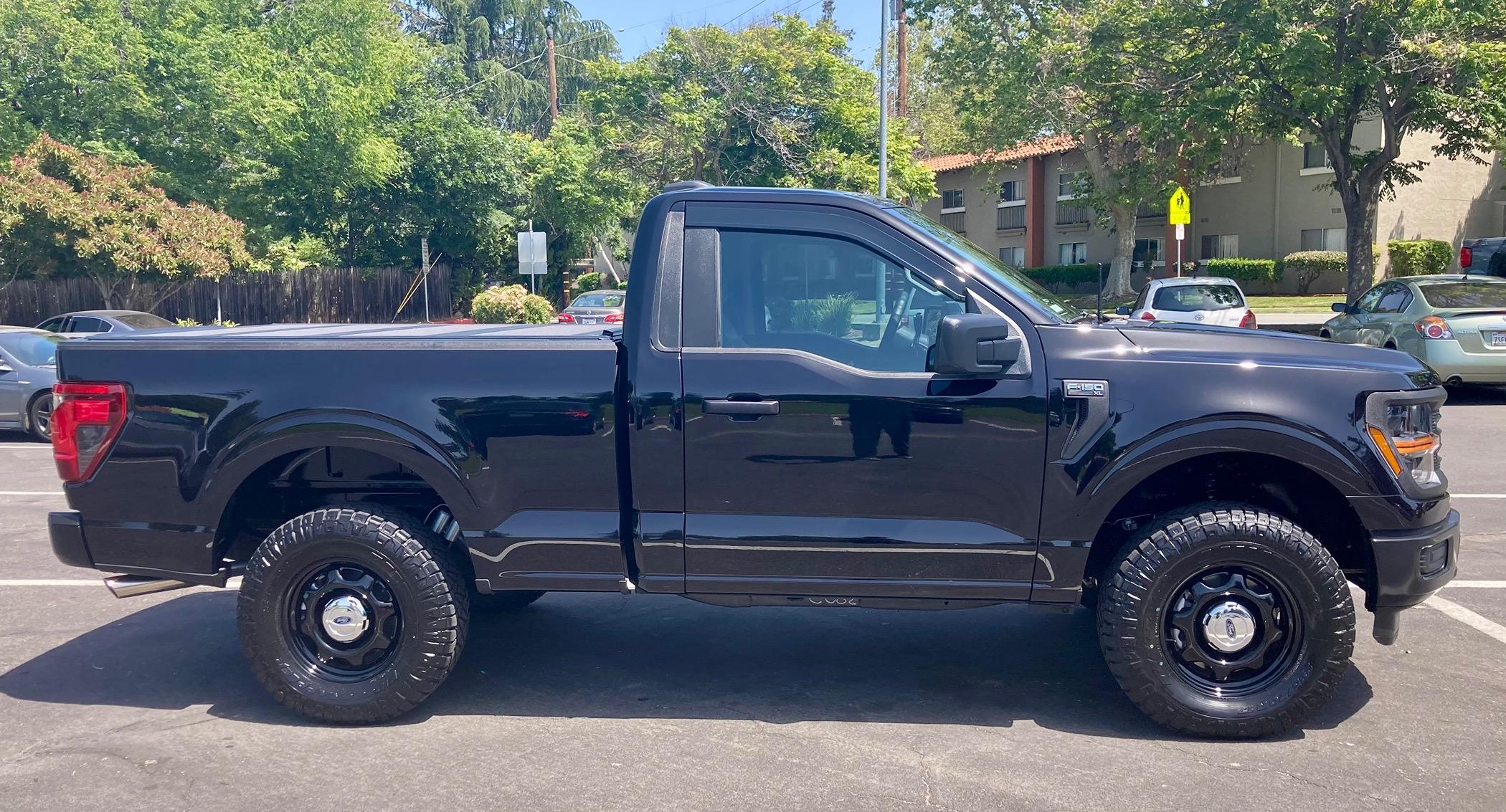

Bilstein 5100/5160 level... Up 2.1 front and about .7 rear from stock. Still has about 1.25” rake. Could remove blocks or add drop shackles to even up but then would have negative rake with weight in the bed.

How do you like this set up and how has it affected handling and gas millage- looks great- I also am gonna remove that back 4x4 sticker

Handles a lot better. Rear is perfect. Front is a little stiff… might change to 5100’s w/stock springs. Went with 285. 70. 17 Ridge Grapplers to keep weight down. Stock steels are 28lbs and Tires 48lbs, I weighed them. So far..22/23 mpg at 75 mph…

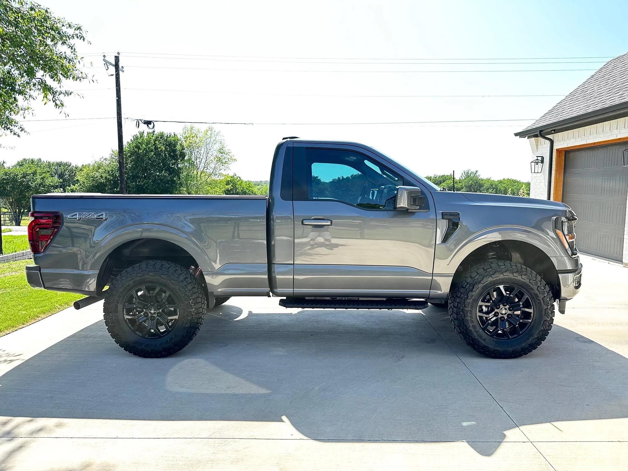

Front 2” level, stock FX4 shocks. 285/70R17 KO2s on the stock aluminum wheels

This turned out great! Nice simple and clean upgrade! I’m a fan!
