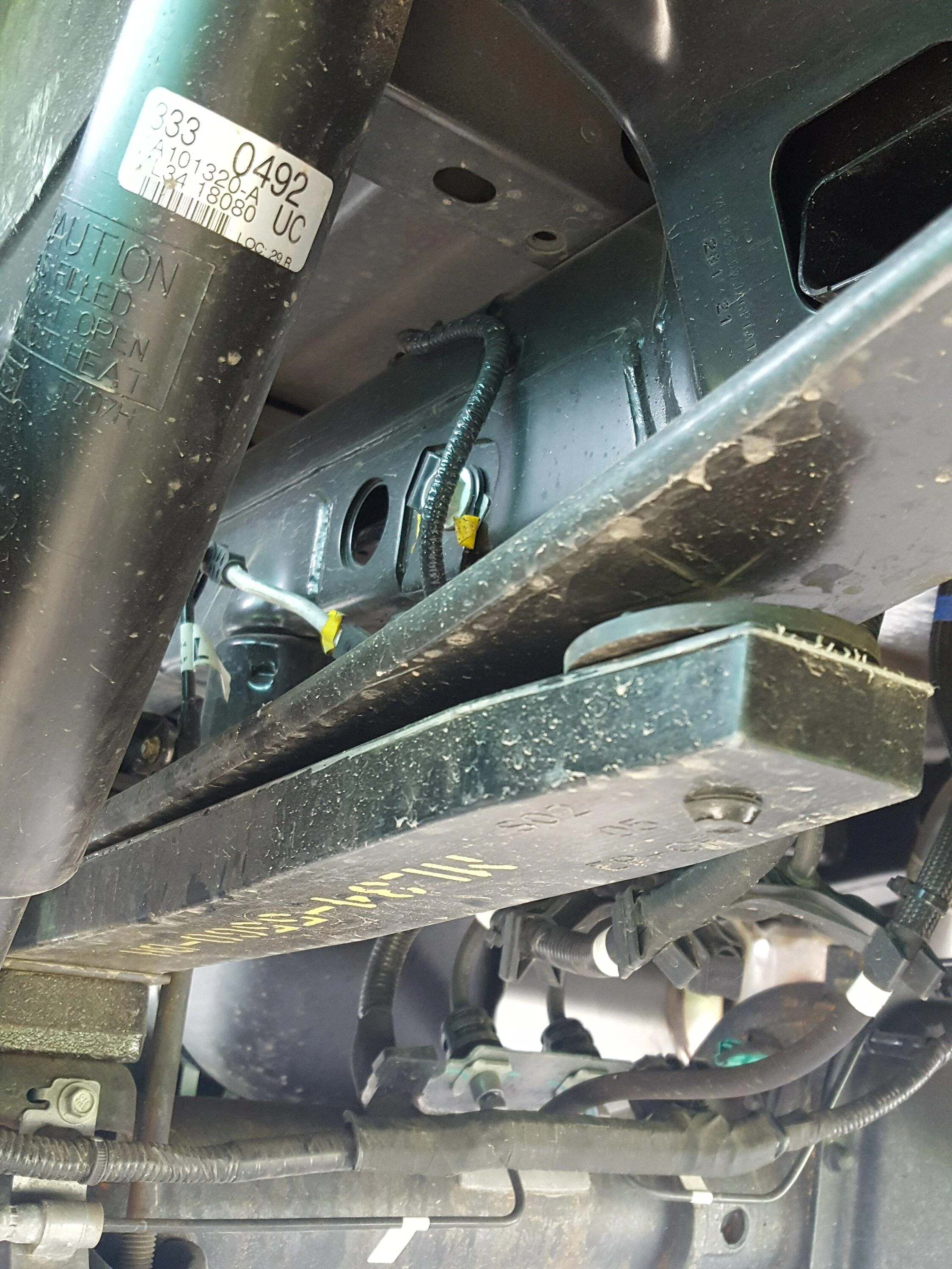

Hi all, did a little light offroading over the weekend and noticed quite a bit of creaking in the rear end especially over off-camber 12-18" high water bars which caused the rear suspension to articulate quite a bit. Tried in 2WD and 4WD high and low and no change, so not related to drivetrain binding. Got home and Googled it and sounds like "leaf spring creak" is fairly normal for newer trucks, yes? Eventually the Teflon spring pack pads/dampers/isolators get worn through causing metal to metal creak, but considering my truck only has 8k miles I'm assuming it's just the flexing causing the new pads to wear in and creak a bit? I found just as much advise to add grease/lubricant between the leaves as leave them dry (to not attract more dust and dirt). My first brand new truck, so maybe the answer is "normal, just keep going". Do new leaf packs creak at first then wear in and quiet down? Thanks

I believe your assessment is correct. You also have aftermarket shocks or factory? I took mine off-roading day 2 and it was pretty creaky, as you did, I attributed it to "breaking in". After 38K and the different shocks the creak is pretty much nonexistent. If I've been out through mud and water and dirt I may hear some creak here and there as debris get caught up but not as much as when new and factory shocks. Next up I need new UCA's but these prices for 14gen is insane. WTF would aluminum control arms for instance be $800. Thats just straight highway robbery.

bottom leaf is a composite structure and should be very quiet
my 350 used to squeak on the spring pack.
i lifted it up and let them open up and washed out the road grit.
applied dry film lube and that would soften them for a while

I believe your assessment is correct. You also have aftermarket shocks or factory? I took mine off-roading day 2 and it was pretty creaky, as you did, I attributed it to "breaking in". After 38K and the different shocks the creek is pretty much nonexistent. If I've been out through mud and water and dirt I may hear some creek here and there as debris get caught up but not as much as when new and factory shocks. Next up I need new UCA's but these prices for 14gen is insane. WTF would aluminum control arms for instance be $800. Thats just straight highway robbery.
Ok, I think they're still just breaking in. Headed out to cut some firewood this weekend so the suspension will get a workout. There's only the 2 leaves per side (no Max Tow) so hopefully it quiets down with more use. I installed Eibachs all around. Creak isn't a rear shock noise though and everything is silent and rides great on roads and highways.
