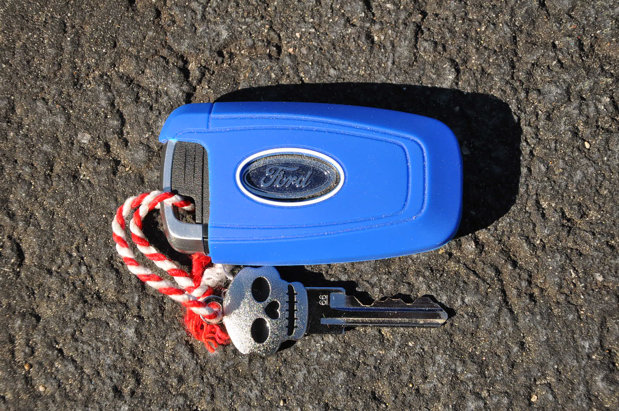

22 powerboost lariat. Key fob issue. None of the buttons work, but will work with door handle touch and start up. That's it. Also, I would not touch fob and truck unlock itself 100 times a minute. Any advice, maybe a battery issue?

I had the same thing happen for my 22 PB Lariat and it was the battery. I think the fob might go through batteries faster than most. I now keep an extra around.
