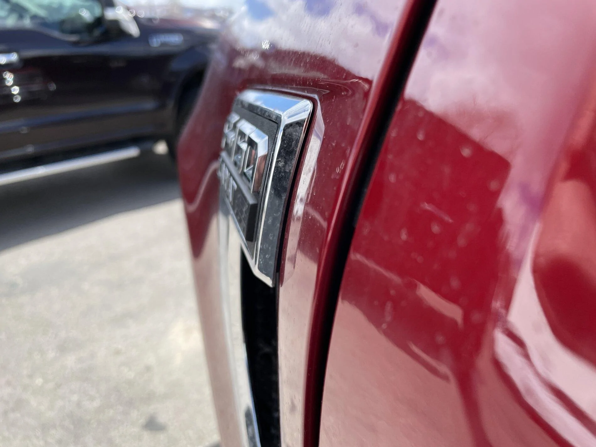

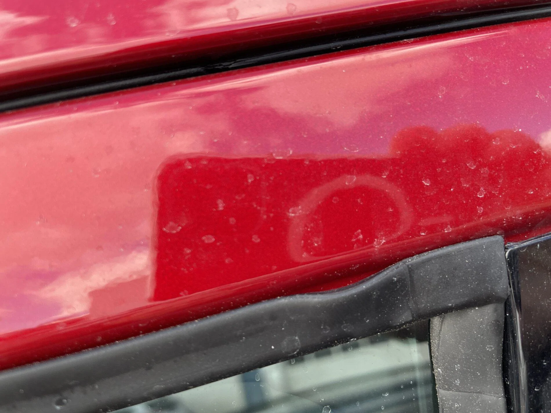

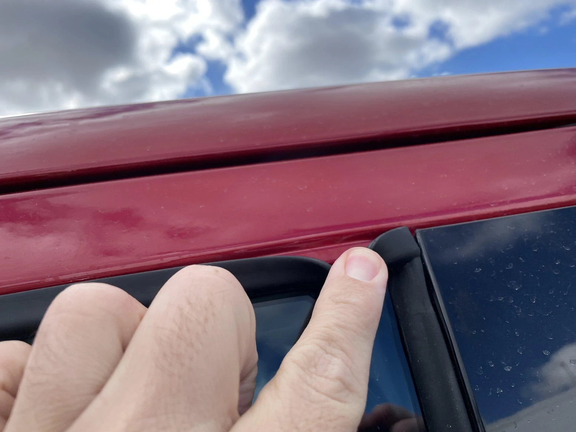

I checked the tracker, and my truck surprisingly showed up at the dealer about 20 days early, despite me ordering 7/17/20. This is fantastic news. So I decided to drive over and take a look as the dealership is closed today. Sure enough there she was. Now, thanks to these forums, I’ve got a half dozen or so issues that have me a little bugged. I don’t doubt the dealer can fix them, but I wanted to get everyone’s opinion. I am realistic and understand these are trucks and Ford can produce one truck every 53 seconds, so things are gonna happen. I know I’m excited but I also don’t want to be unrealistic about some of the issues.
1. All doors seem to fit different, more so compared to other trucks on the lot.
2. The passenger side two doors are the worst, and one seems to be even looks like it’s not all the way shut.
3. I’m waiting to see a tracking form from some of the other people that do that on the forums, but it appears as if this truck was sent by truck rather than rail from Missouri to Utah. It is absolutely filthy, and that bugs me a little bit. I know this is not a BMW that comes wrapped or transported in enclosed car haulers but still. I know it will get cleaned, but still.
3. Despite the dirt, I noticed a half dozen or so paint imperfections. Some little dimples, one was paint over a hair, and one was paint over some other foreign thing causing a bump. Again, probably something nobody would notice, but still.
4. Driver door seal is not sung, I know you can pull them down, but again it should be snug.
5. Gasket under the mirror is tweaked.
6. Hood vent panel loose.
Like I said, I don’t doubt that all of these issues can be resolved fairly quickly. I just don’t know if I should point them all out or not. I’ve had many new trucks in my lifetime, so I know what to expect. I also know that during these times we all get excited and overly critical at things, and that’s what I don’t want to be is overly critical and unrealistic. I just wanted to get some feedback from you guys on how much of a stink to push. Also I have to consider that if I make an issue with the misaligned doors or the mirror gasket etc., that involves somebody getting in and adjusting things and potentially opening up the issue of making something else off. I also deal with the fleet salesman and our relationship is such that it’s no hassle on either side, he gives me a great number and I’m not a high maintenance customer. So I don’t want all the sudden turn into a Karen.
For what it’s worth my undercarriage looked OK, only a little bit of rust on the forward part of the differential.
What are your thoughts?

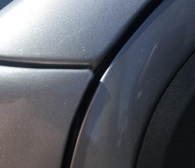

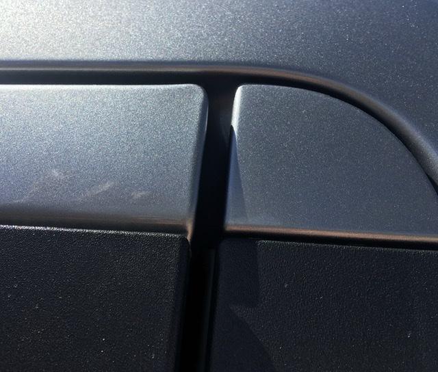

One thing that I immediately spotted was the misaligned doors, before I had even gotten within 10 feet, the door gap was obvious. The problem is not the seals, they are misaligned at the hinge.
I noticed on a YouTube video, someone was showing off their new truck and showing off his new exhaust. The truck was black and the white snow in the background showed as clear as day that his doore were misaligned too.
When I brought up the doors, the dealership immediately agreed that they would fix them and it was included in the sales contract. However, I am sure that had I never mentioned it. They wouldn’t have cared. I am pretty confident that the same is true for others as well. They will be happy to sell it and if you bring it up after the fact, it will be up to you to take it up with Ford.
I took some pictures the other day. I will try to find them.
This Wednesday, I have an appointment with the dealer’s body shop to get the doors fixed. Last week they had me go to their service center, where unsurprisingly, a mechanic was unable to fix it. Then a service writer, no doubt unaware that this was between me and the dealership, tried blowing smoke and bullshitted me about the belt line trim and said they took pictures and sent them to Ford and would call back. I was pretty annoyed and waited a few days before calling back and insisting on an appointment with their body shop to have the situation remedied.

Front door gap at base of A-Pillar and front fender:
Ford F-150 KC, Quality is NOT job #1 B3EDDD6B-9CC3-4FA9-9BAF-2974889B4B4A
Door gap at top of B-Pillar and door frame:
Ford F-150 KC, Quality is NOT job #1 6B1615EC-8629-450C-AB67-36B744E53994
Door gap and misalignment shown at middle of door and front fender:
Ford F-150 KC, Quality is NOT job #1 2D1B56B0-815D-4D38-B9A9-84430D7906EB
Door gap measured at door jamb:
Ford F-150 KC, Quality is NOT job #1 F7790C64-2D94-499C-B820-11A4816566AF
Over 1/8th of an inch! Or 9/64ths if you want to split hairs.

The first 3 pictures of the door fitment, to the front fender. Is that Ford specs are = flush to under flush 1mm. They do not want the door to be overflush. This would cause a wind noise, & possible water intrusion into the cab.
